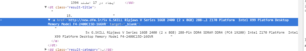

hi
i used the offlajn ajax live search 5.4 for search product and content
but when search the product url is wrong . the search product url is not a url it is a product name like screen shot attached.
this problem not just for offlajn search it is in joomla built in search module too..
this is my url
new.dfm.ir/fa/dfm-online-shopping
you can search "asus" and see the result.
i configure hikashop product search and hikashop category/manufacture search plugin correctly
create a menu with product listing and othe menu with category listin. and set that menu id to itemid plugins.

10 years 5 months ago #232661
some of product is correct.
if you search "gtx" the first product white correct url but other is wrong.
and new created products have correct url.

10 years 5 months ago #232673
This looks like you entered crap in the "canonical URL" field of your products and activated the "force canonical URLs on listings" setting of the HikaShop configuration.
So the system is using these canonical URLs, which are not correct because they aren't URLs at all.
You should even have the same problem with the products listings.
So remove these wrong canonical URLs and/or turn off that option and it should fix the problem.
The following user(s) said Thank You: jafar007
  • Posts: 52
10 years 5 months ago #232750
tanx nicolas. you right it's for canonical urls. i remove canonical urls on all of product and it's work .
