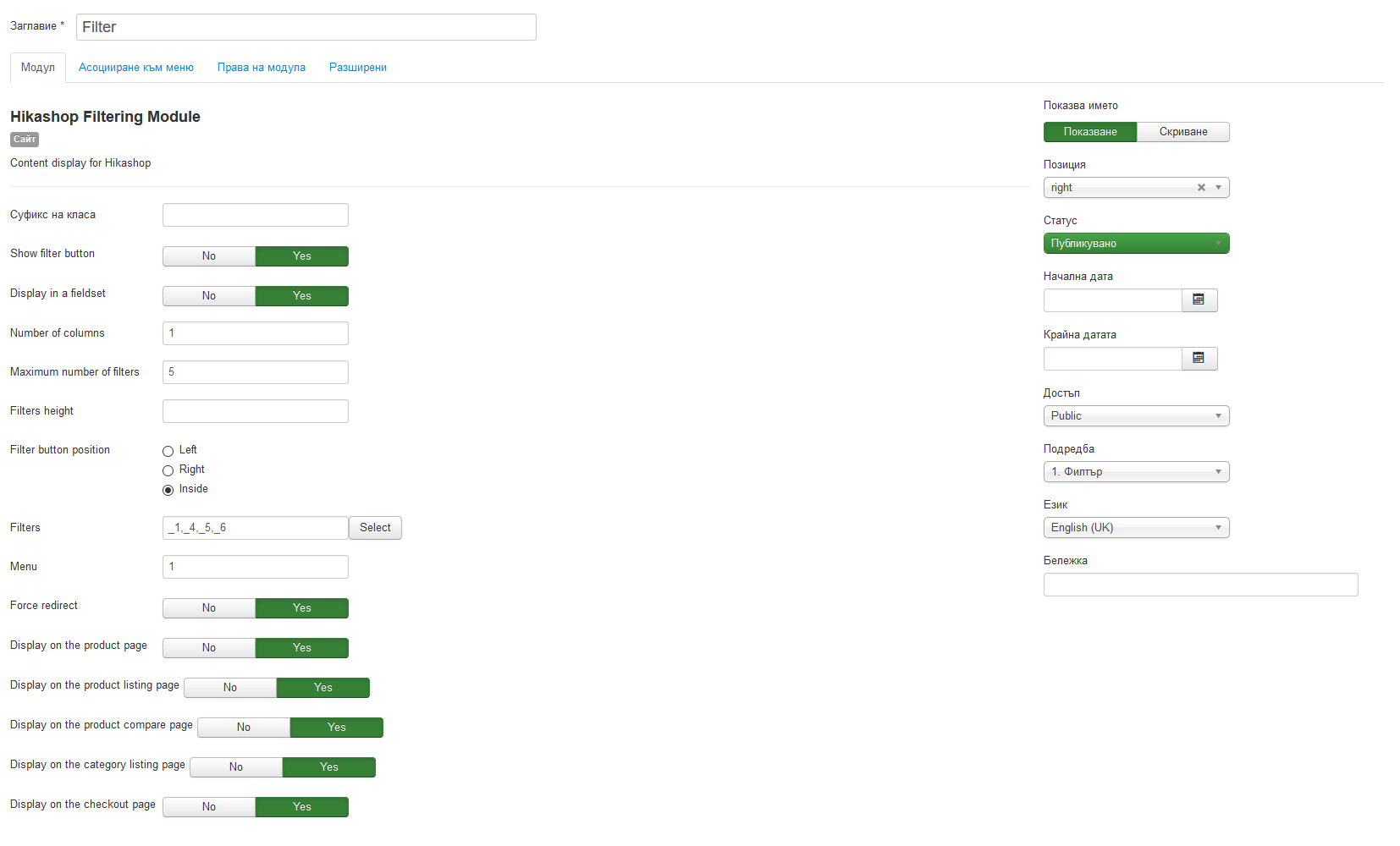

Hi, i have two language site (En/Bg) i use Falang to translate HikaSHop contetn in my site. But have some problem, when i use filter in Bulgarian version, filter result show 404 category not found. In English everything is ok, only in Bulgarians this happens.

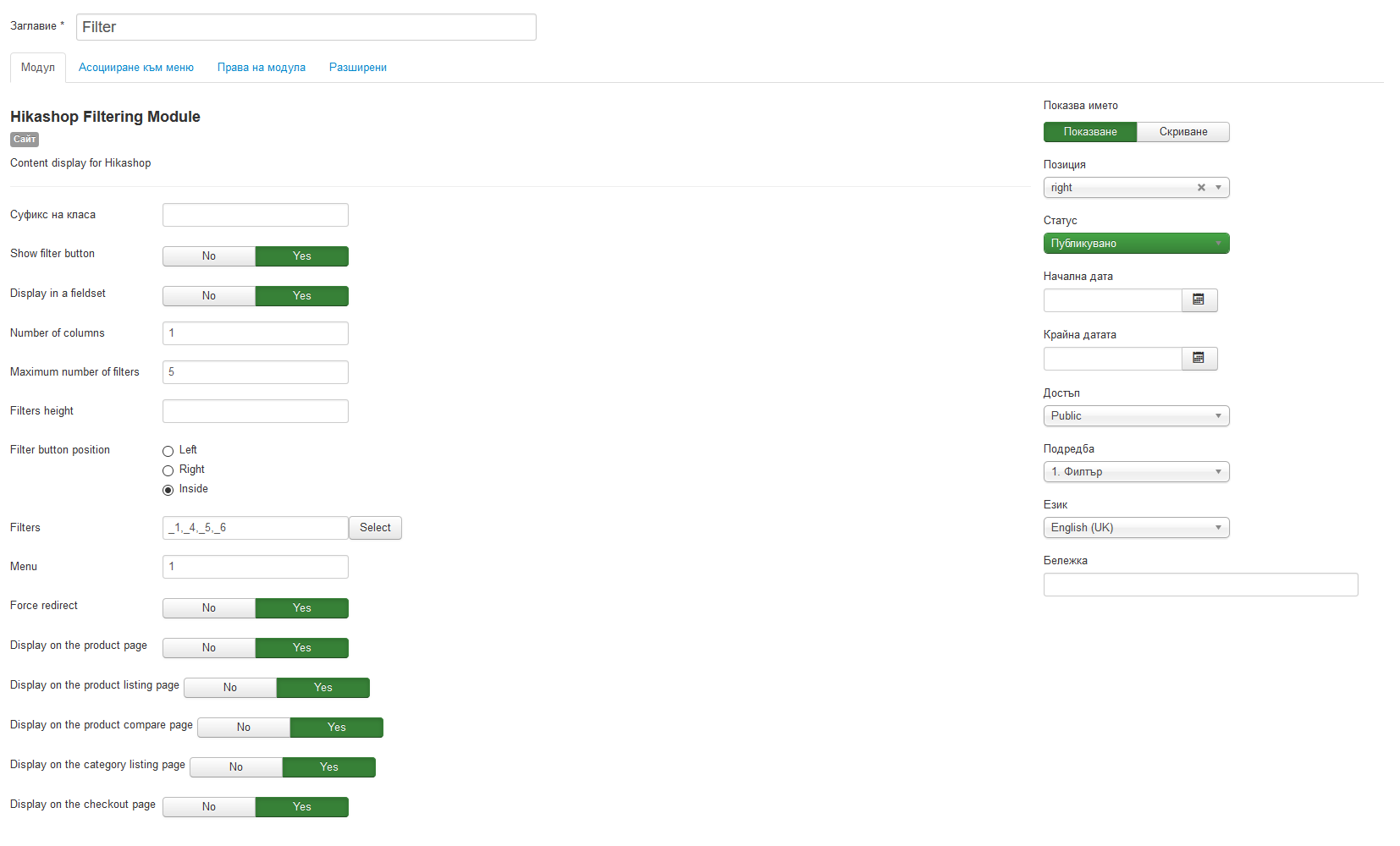

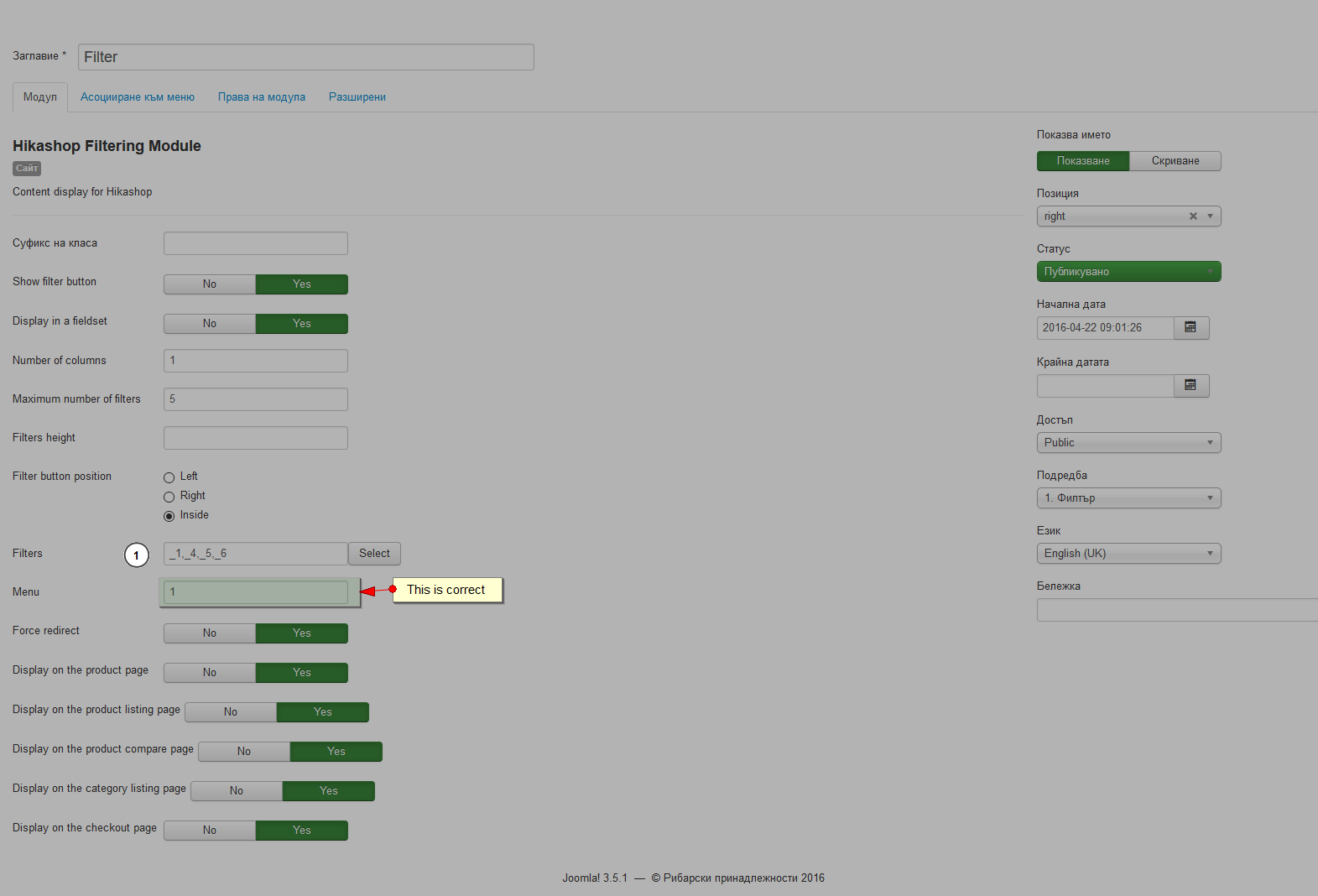

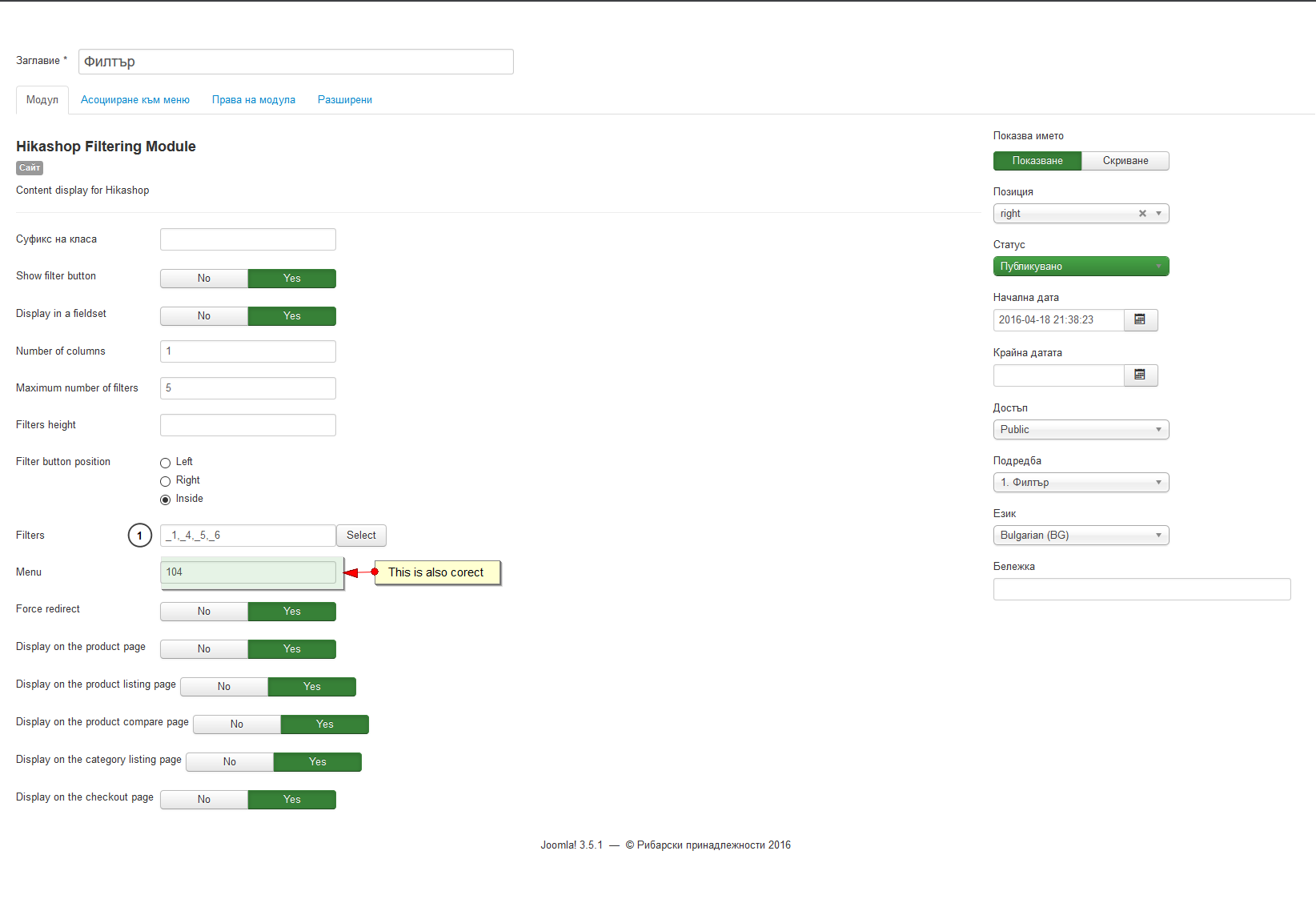

This probably means that the menu item of the id that you entered in the "menu" setting of the HikaShop filters module is restricted to English. You should enter in there a menu item of the type "products listing" which isn't limited to one language.
  • Posts: 8

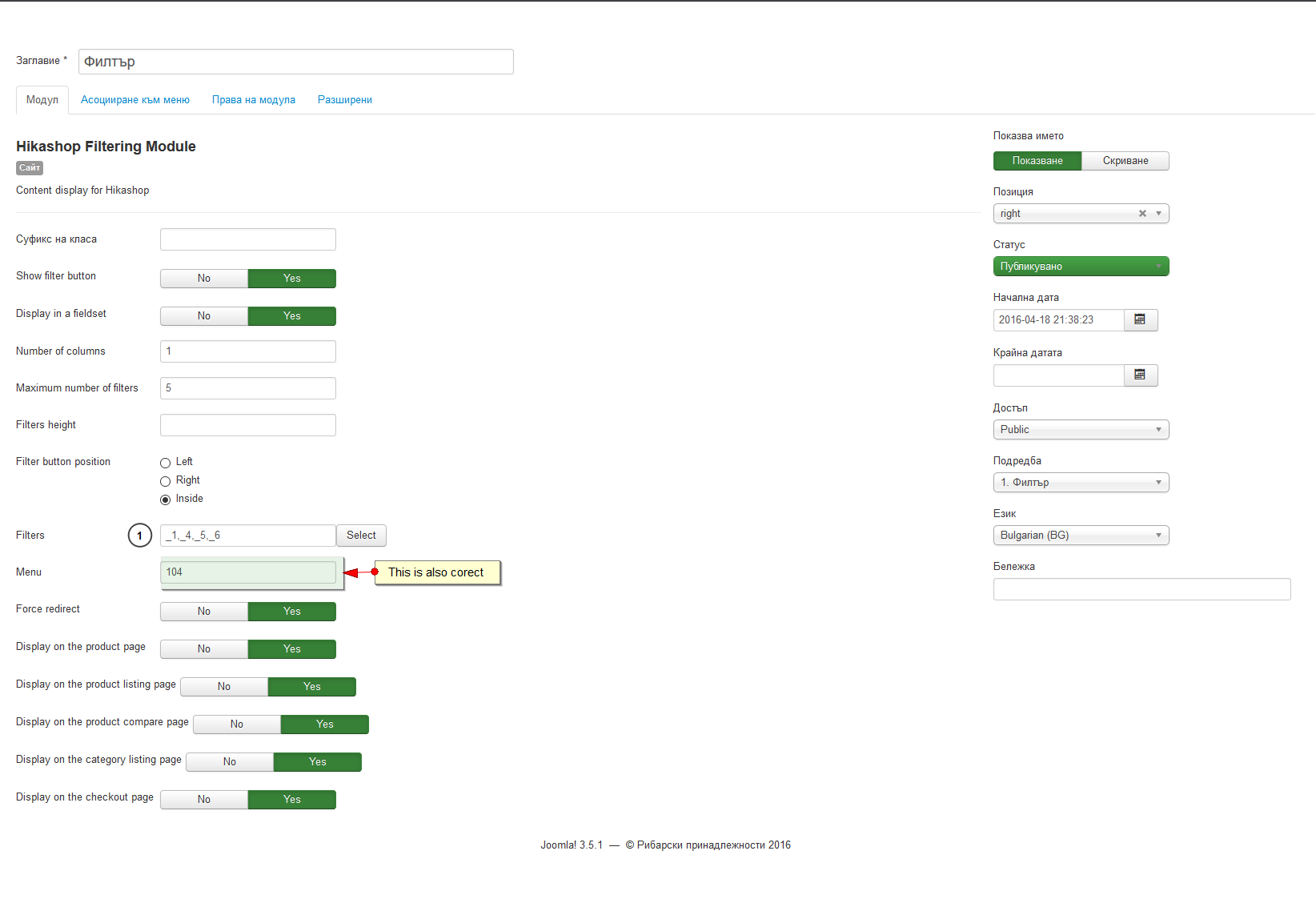

10 years 4 months ago #237017
Hi Nikola :)
I create two filters module, for each language en and bg.
Now i stop one of both, and only one working a set to all language, but result is the same

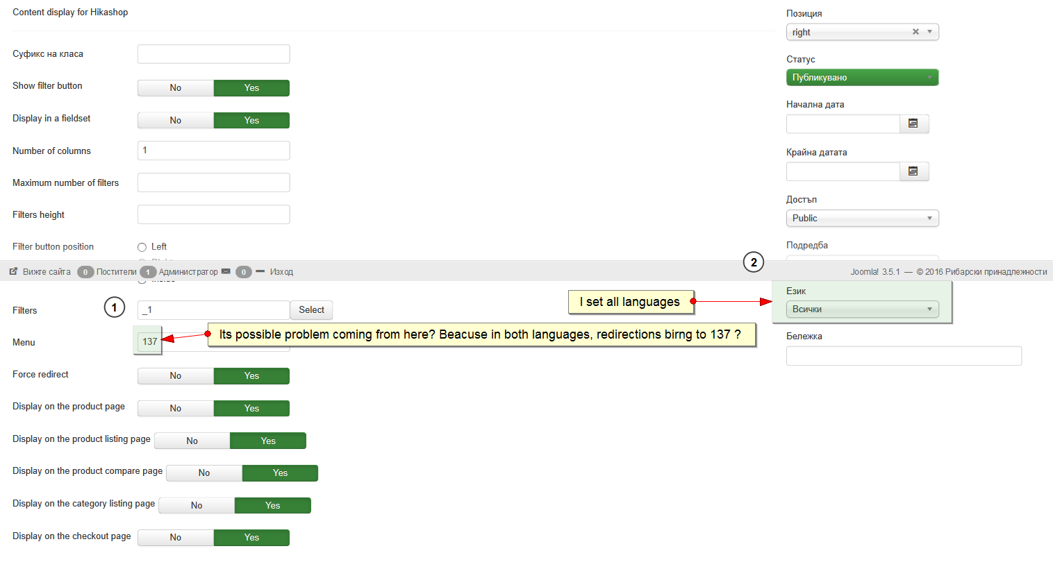

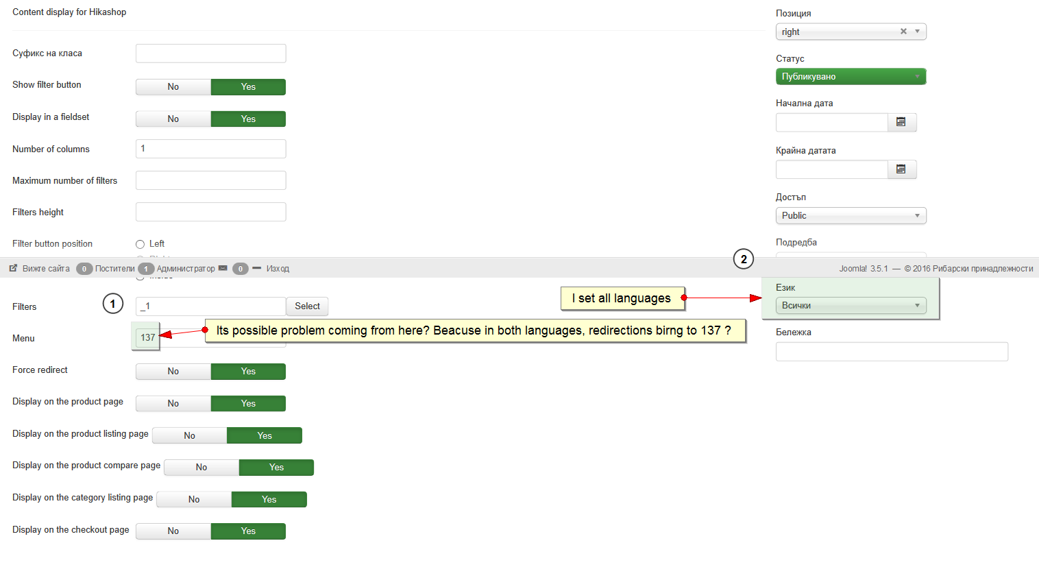

10 years 4 months ago #237030
Go in the Joomla menu manager and check the menu item with the id 137. It's language should also be set to "all".
  • Posts: 8
10 years 4 months ago #237065
Hi Nikola, thanks or the fast answer, but do not haw menu with that id 137, if you want i will give you access to site :)
  • Posts: 86077
  • Thank you received: 14186
10 years 4 months ago #237078
Then why did you configure an id for a menu item which doesn't exists in that option ?
That's why it doesn't work :)
You need to enter there the id of a menu item of the type HikaShop products listing as explained in the tooltip when you hover on the label of that option.

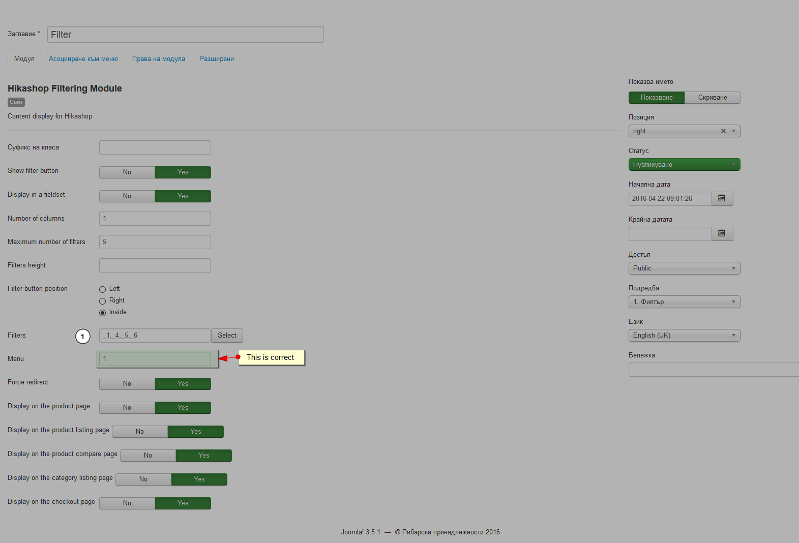

  • Posts: 86077
10 years 4 months ago #237314
I can't help without more precise information:
- a link to the page
- the test you're using
- a screenshot of the filter settings
would be a good start.

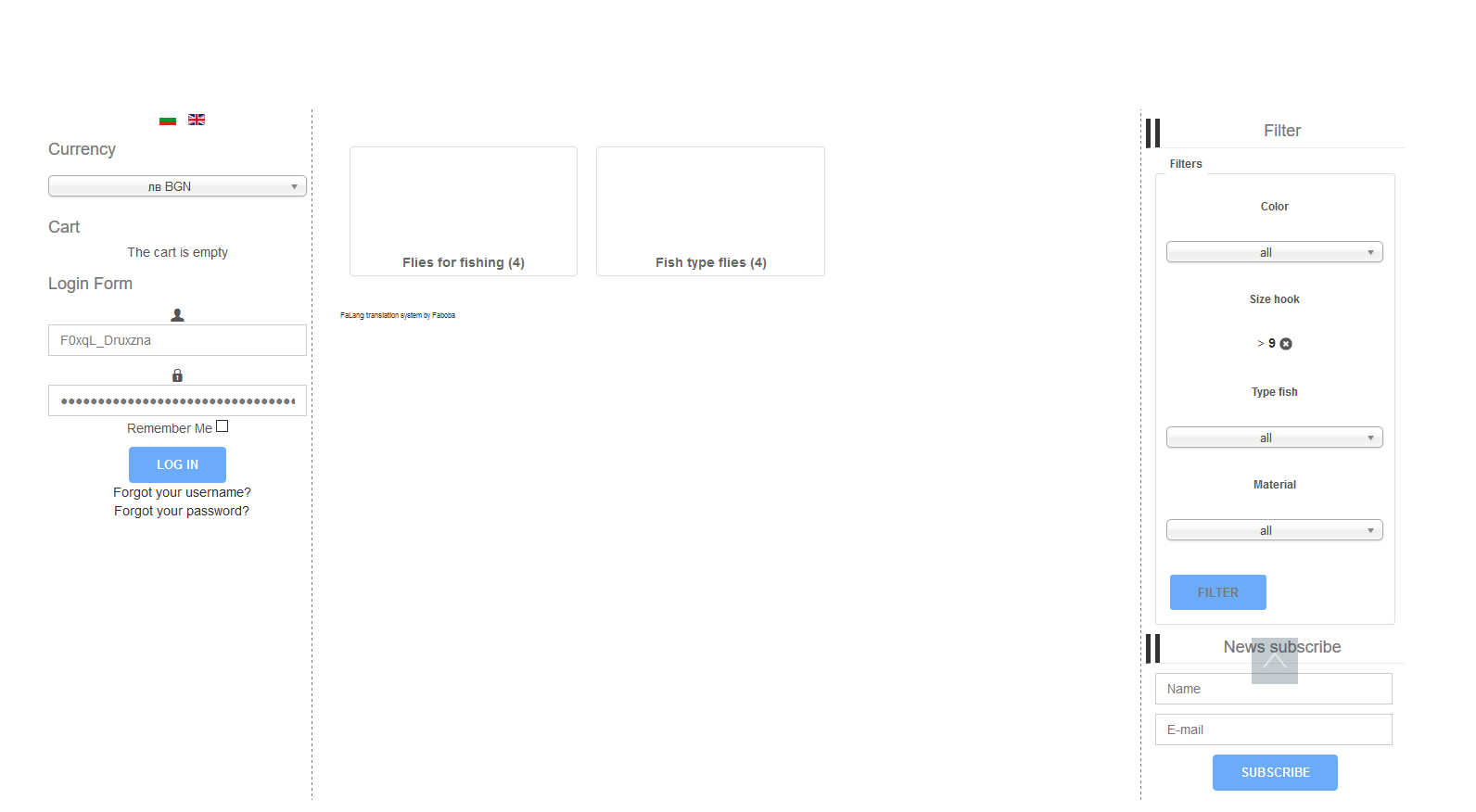

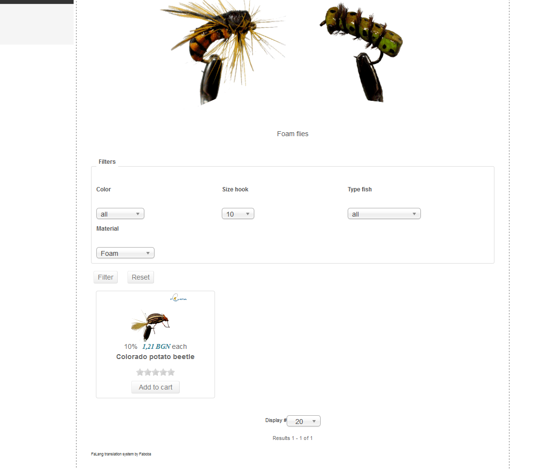

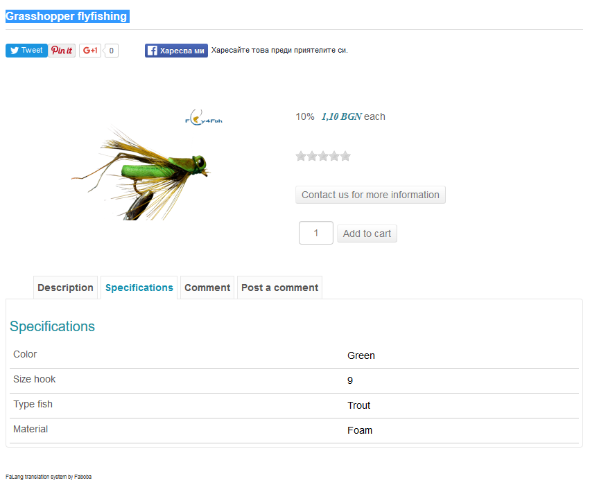

  • Posts: 8
10 years 4 months ago #237489
Hi, here you can visit site :)

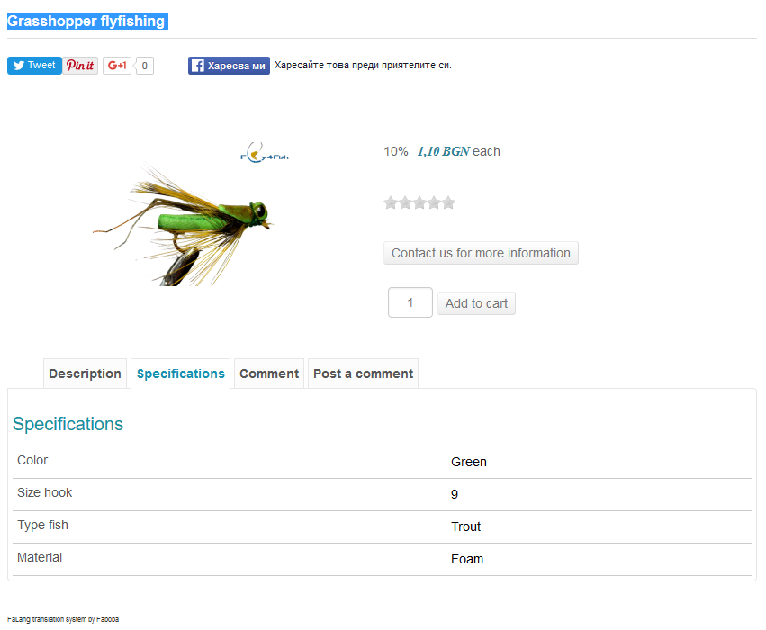

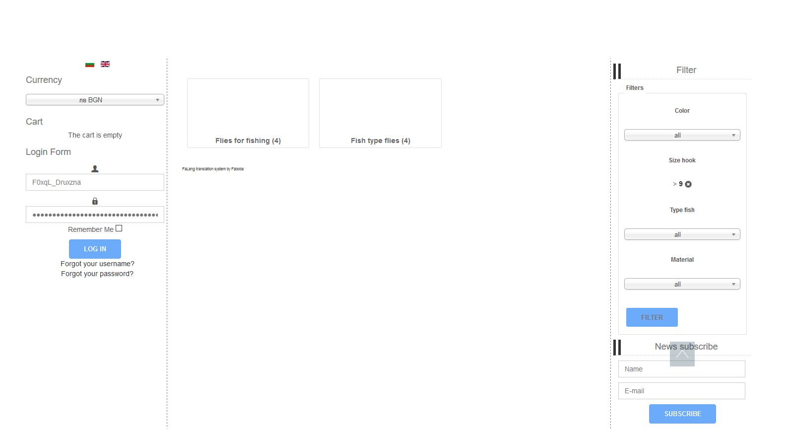

www.fly4fish.com/en/flies-for-fishing.html
when go to filter and chose from "Size hook" 9
i have only one product which use this value that product is : "Grasshopper flyfishing "
but result show all category
  • Posts: 86077
10 years 4 months ago #237505
The problem comes from that same "menu" option of your filter module.
As I said in a previous message of this thread, you need to enter here the id of a menu item of the type HikaShop products listing but looking at the situation on your website, it seems that you entered in it the id of a menu item of the type HikaShop categories listing.
Correct that and it should work.
