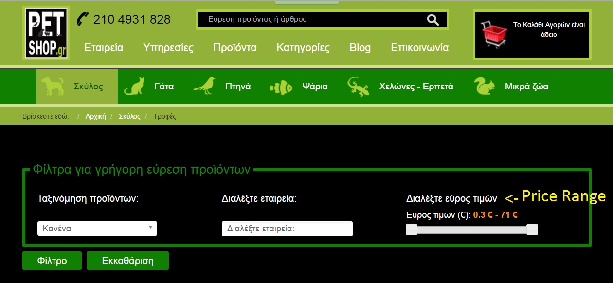

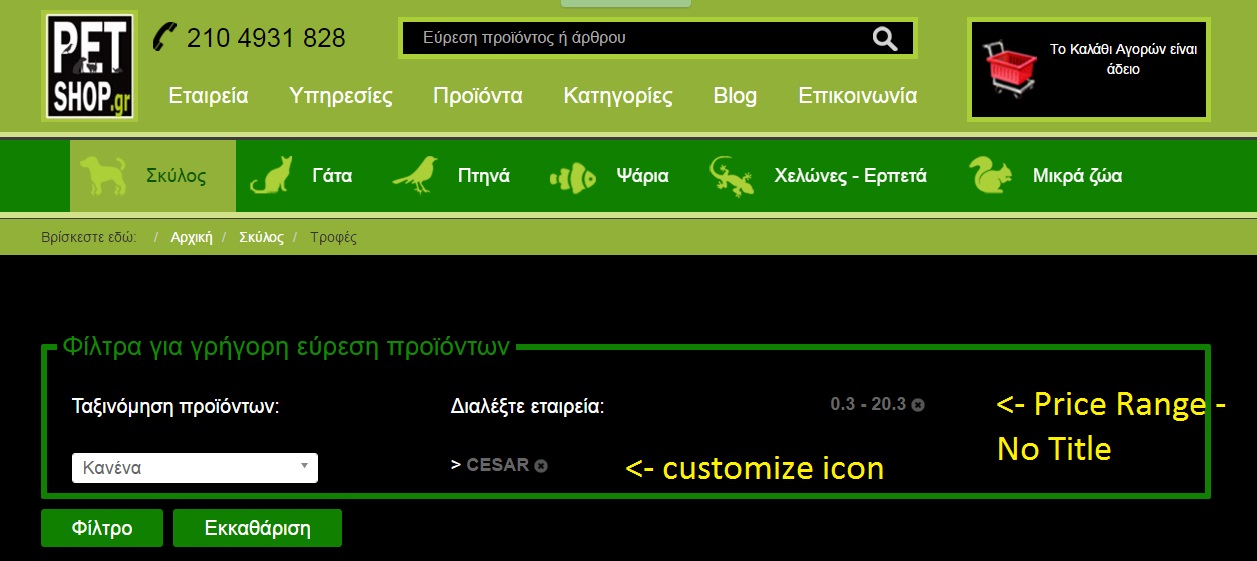

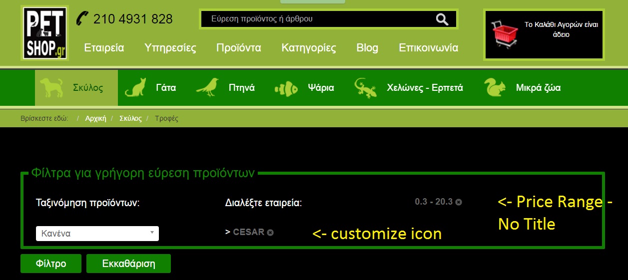

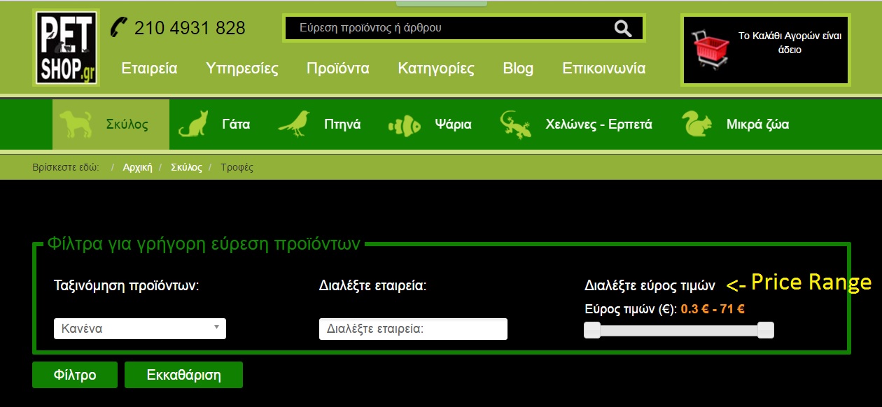

I want to customize the filters' results. No the introductory filter page (Before-filter.jpg) but when the user applies a filter (After-filter.jpg).
I notice that when price range filter is applied the title "Price Range (Διαλέξτε εύρος τιμών)" is dissapeared.
I want to customize the delete icon too (select another file, not just replace the ../media/com_hikashop/images/delete2.png file).
I look at the filter.php file but I can't figure how to do it.
  • Posts: 86077
  • Thank you received: 14186
10 years 4 months ago #237384
It will indeed require modifying the administrator/components/com_hikashop/classes/filter.php file.
It's that code that you want to change there:
<img src="'.HIKASHOP_IMAGES.'delete2.png" />
Regarding the cursor filter, try turning off the "deletable" setting of the filter.
