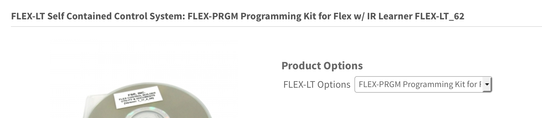

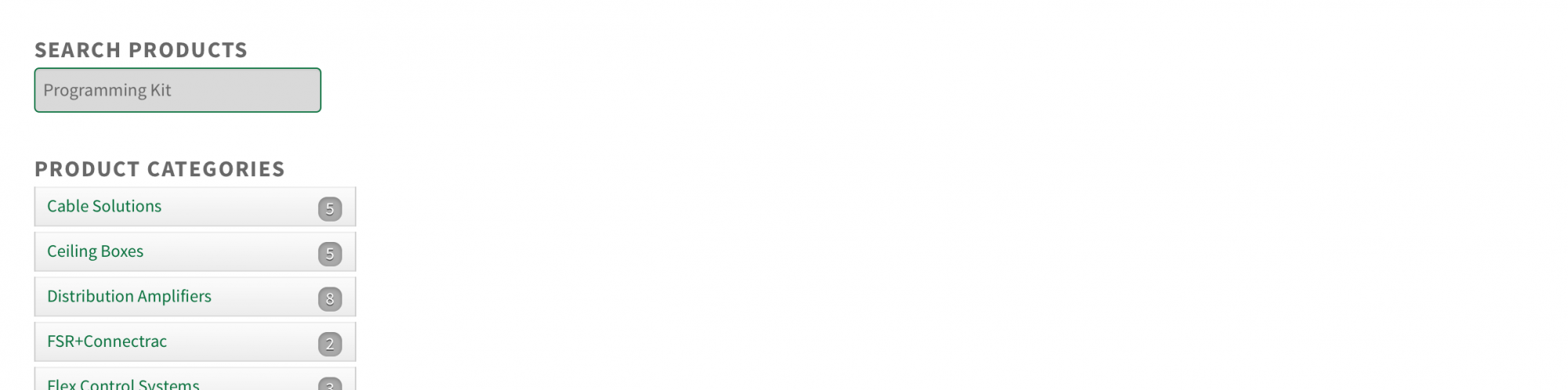

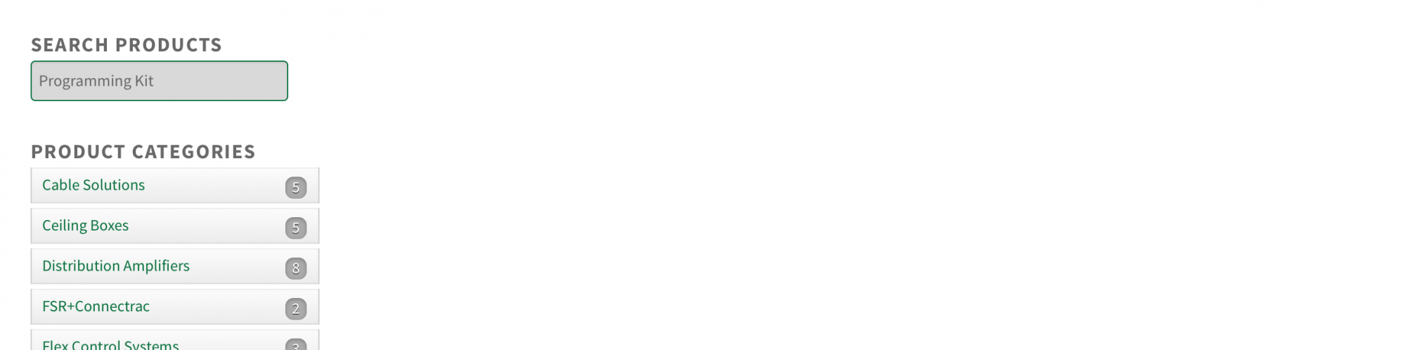

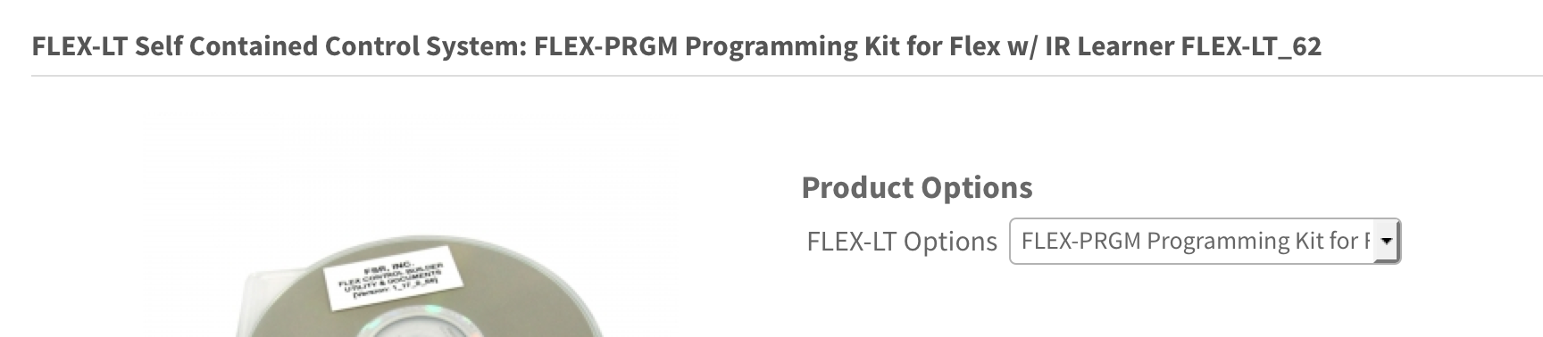

10 years 2 months ago #243381
In order for variants to be searched using the Hikashop filter, are there particular fields that should be included in the "apply on" field?
We have a text field filter setup and applied on the product name and product code, however, terms from the variant codes are not appearing in results.

10 years 2 months ago #243383
Filters are for products listings. So the text filter search is done on the products data only, not the variants.
So you would have to copy the text to be searched in the main product (in a custom field for example), or use the standard Joomla search system with the HikaShop search plugin which has an option to search in variants.
