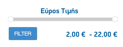

Hello!
My client wants a pretty specific layout of the eshop we have built and i was wondering if you could help me do that! I m sending you an image to see the layout he wants of the cursor filter.
May i ask, how can i remove the ":" that appears on the title?
Thank you in advance
10 years 3 months ago #239668
To remove the ":" from the cursor title, you have to do add a language override on the key: CURSOR_TITLE_SEPARATOR
www.hikashop.com/support/faq.html#tran
The other modifications are mainly css.
