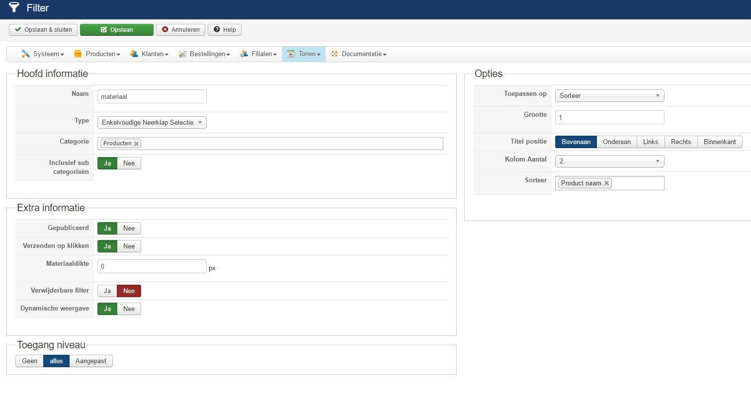

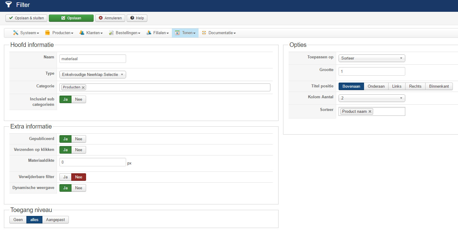

I get several SQL errors on different Filters. Some work fine, others don't (see Error message above). Can't figure out what's wrong?
