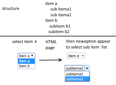

i have a hiearchy that exist for many products . I don't know if i have to use the characteristic orcategory or fields filter way .
what i kno is tha on the browser client side i want a select box ( call it select1) and after select an item inside this selct1 widget a new select box appear ( call it seelct2) with the subitem relative to item seelct in the first select ( seelct1) .
Does hikashop can do that in the gui way ( no need of php code / non coding )

You can do that with filters. Each select would be a filter with the dynamic display option turned on.
That way, when you select something in one of the filter, it would refresh the page and you would see only the possible values in the second filter for the value selected in the first filter.
