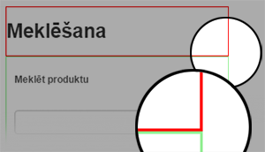

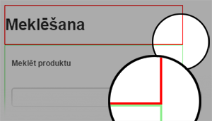

Hi, I have a problem. Basically I'm using a text filter as a search feature (works great BTW), so I have a text filter (called Meklēt produktu) within a Hika Shop filter module (called Meklēšana). It works. The problems thou occur when I try to style the module. I gave the module class suffix: "searchLV". The problem is that the filter itself is not included within this class - "moduletablesearchLV" when I inspect the page.
For me this means that I can not style (apply CSS) to the entire module (Meklēšana).
Also, there's a custom HTML module underneath the module I've just described, it's called: Kontaktinformācija, and it overlaps with the filter (hikashop_filter_module). Can you help me ?

  • Posts: 14
9 years 7 months ago #261253
See the website I gave once again, I've highlighted the region of problem using custom.css file "attached to my template"
The CSS's following:
.moduletablesearchLV {
border: 1px solid black;
.moduletablekinfo {
Can you see the overlap now ?

  • Posts: 14
9 years 7 months ago #262004
Emm, you see, "Meklēt produktu" should be in the same border region with "Meklēšana", as "Meklēt produktu" is a text filter displayed in the module "Meklēšana". Instead it's within the border with "Kontaktinformacija" which is a different module.
  • Posts: 86179
  • Thank you received: 14217
9 years 7 months ago #262027
Ok, I see what you mean but the problem is just a CSS problem between the two modules. It's not particularily linked to the filter module of HikaShop.
If you add a height to the filter module and a clear:both on the second module, it will display fine:
monosnap.com/file/HjT5ORPJnuFU1uB1BEFWuv36rZi7I9
