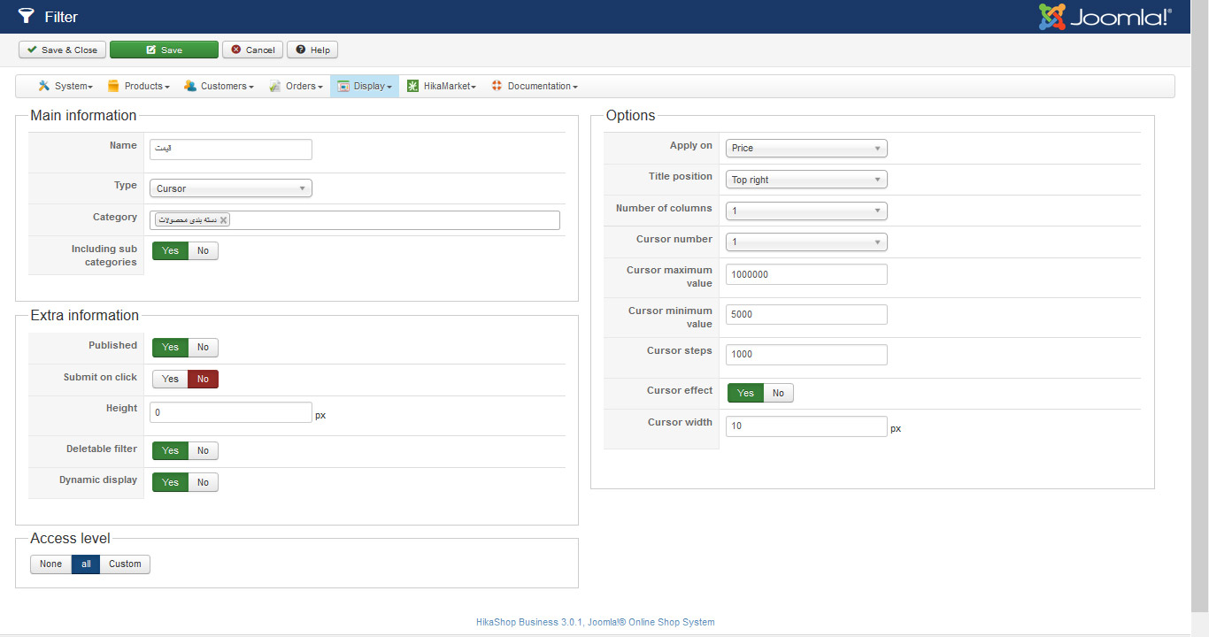

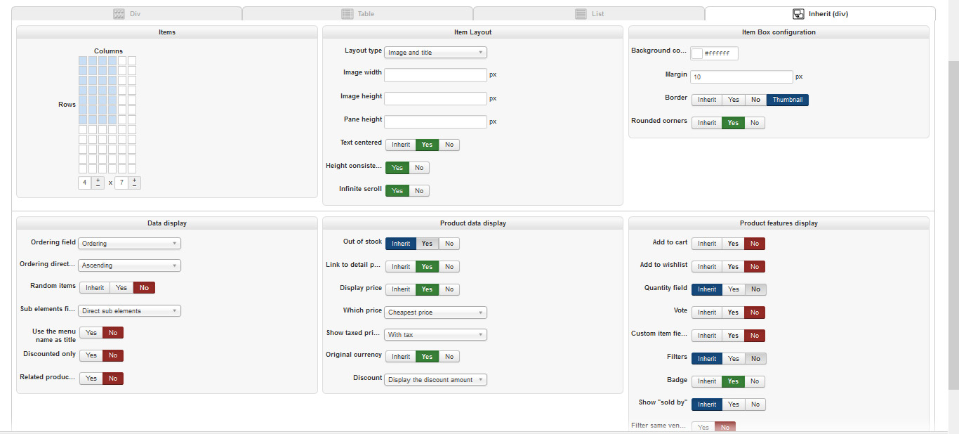

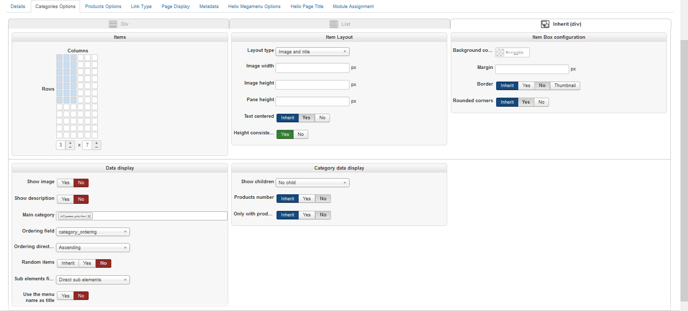

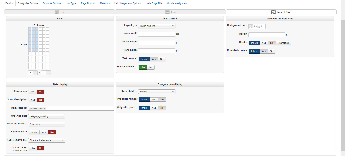

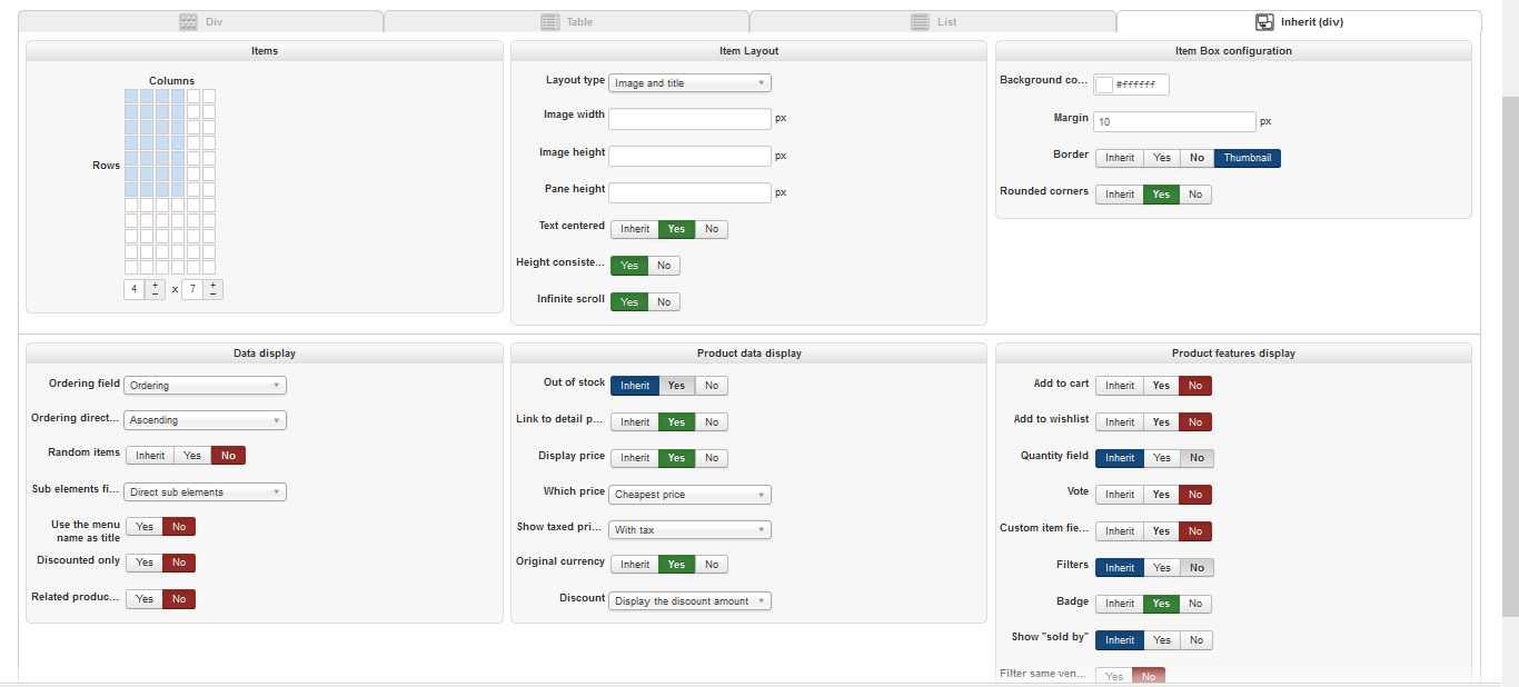

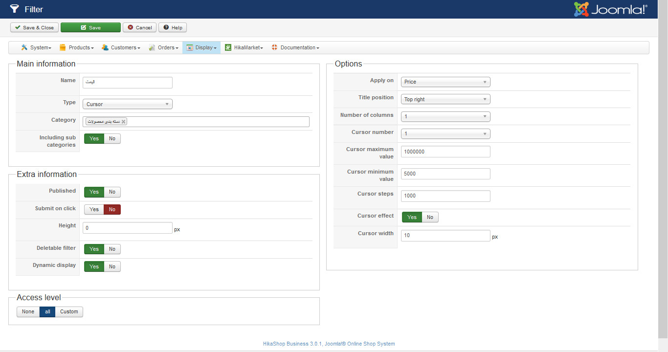

Could you provide a screenshot of the settings under the "categories options" and "products options" tabs of your menu item and one of your filter ?
Also, do you have the "redirect POST mode" setting activated or turned off in your HikaShop configuration ? Changing that could circumvent the problem.
  • Posts: 14
9 years 5 months ago #265345
Please see the attached screenshots. redirect POST mode is activated but when I turn it off the problem persists.
