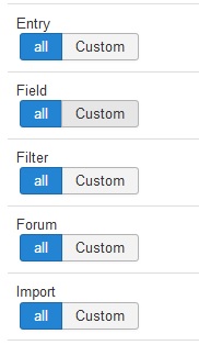

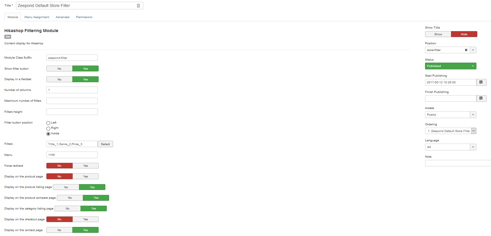

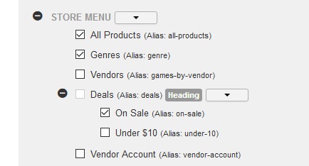

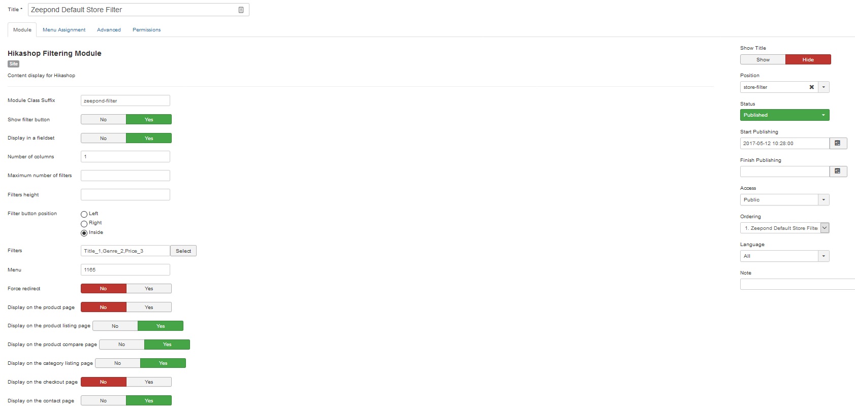

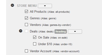

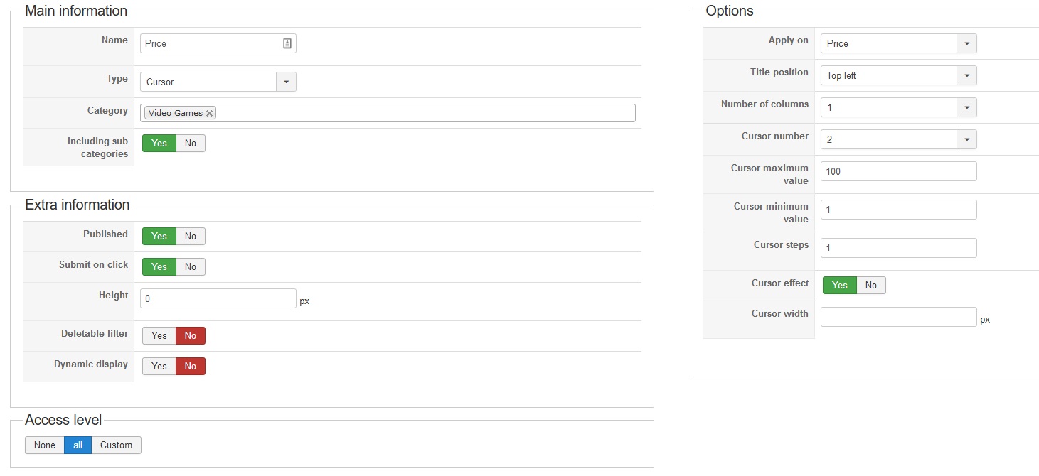

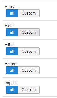

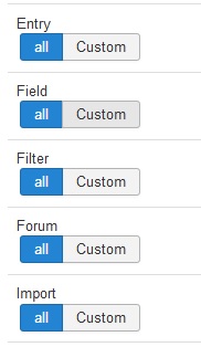

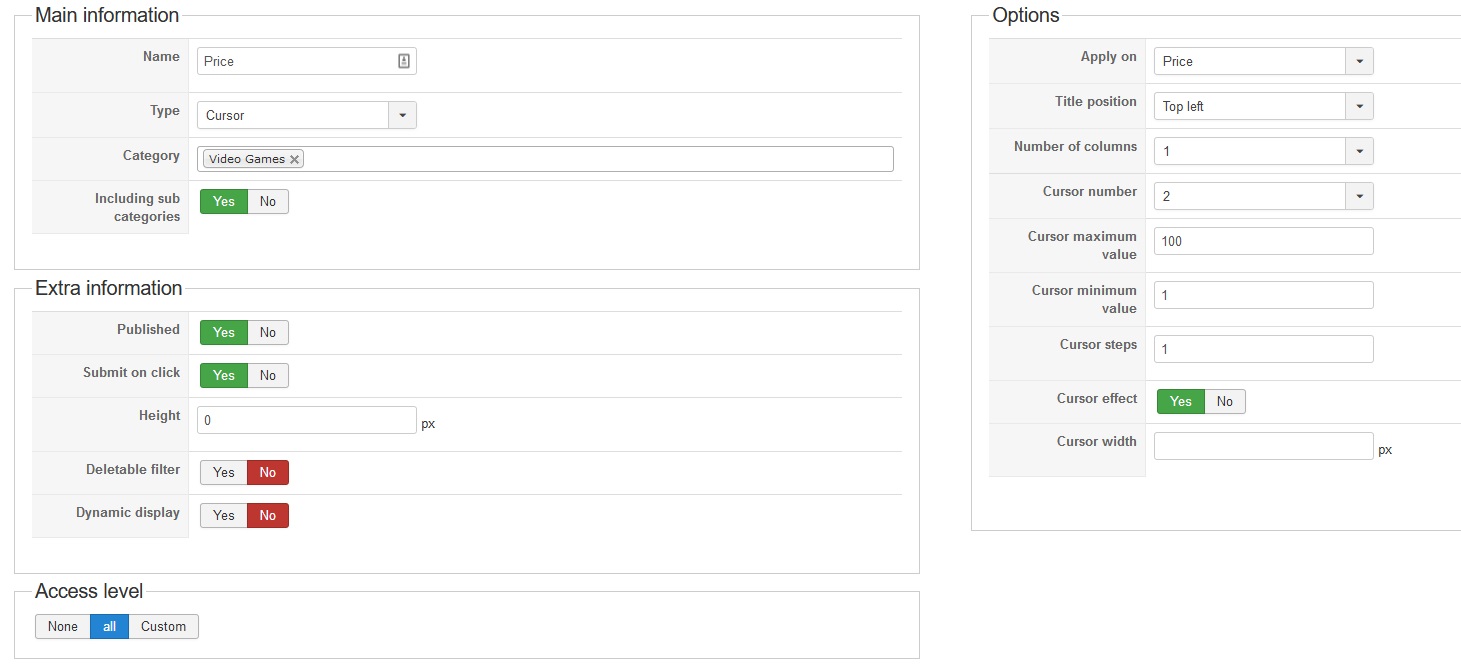

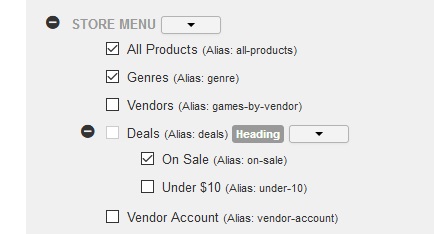

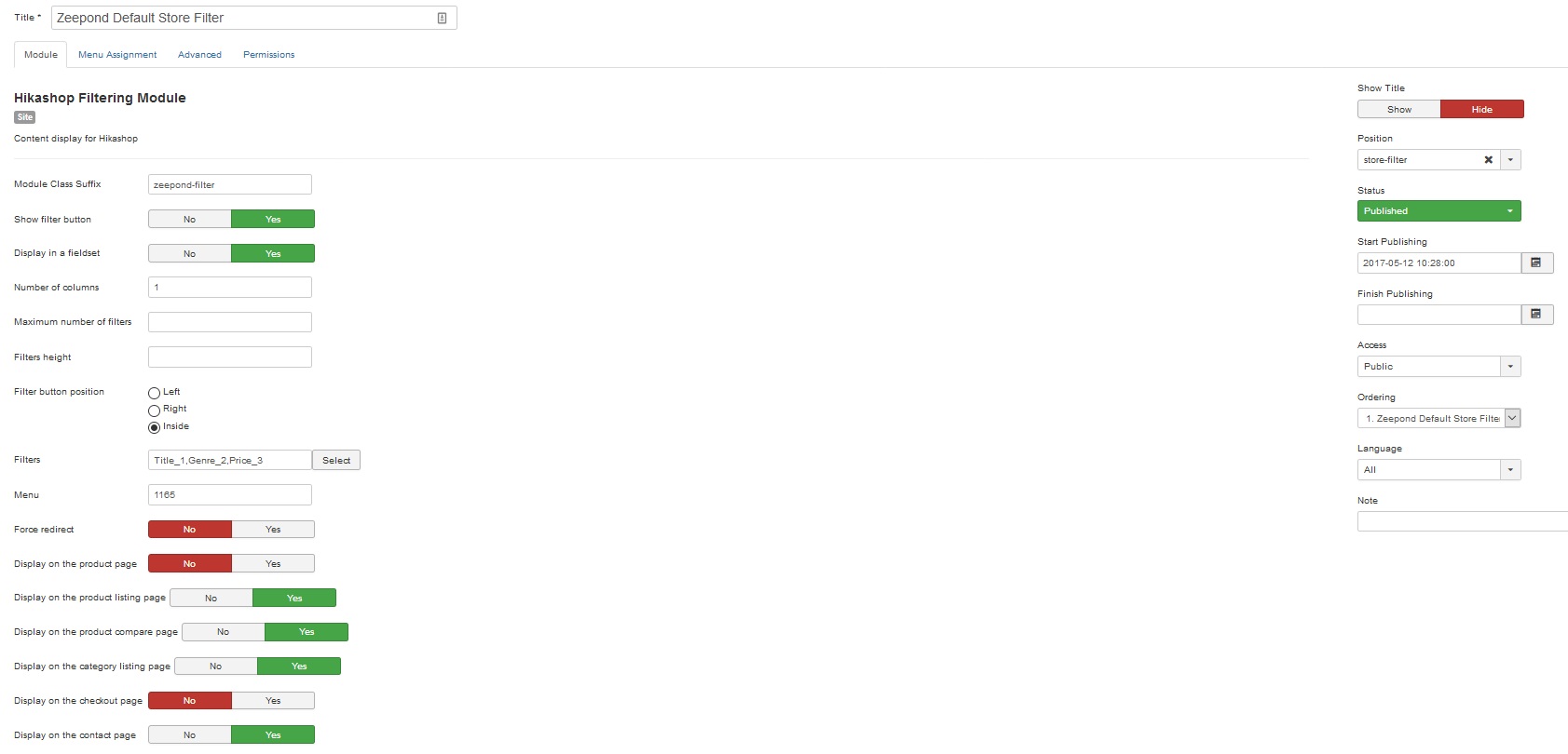

I'm having an issue with the display of the cursor filter on our construction site, I've got a filter module that consists of 3 separate filters (text on 'title', dropdown on 'genre' and cursor on 'price') the issue is that the price cursor filter is not displaying to public users, all the filters have been given the same access level in their configuration (screenshots attached) I've checked the access levels in the filter, module and in the features configuration page and can't for the life of me find where or what is causing this issue, as its only affecting one of the 3 filters.
Logging in displays the cursor filter fine and it works without issue but I would like the filter to work without requiring login.

The filter is there:
monosnap.com/file/zz4WJgnzpiMNsgj0YVx8nA721DZ5GL
You can see its javascript is not being initialized because of a conflict with jquery.
Install and activate the extension jQuery Easy and activate in it the jQueri-ui option and it should then work fine.

Installed and working, didn't even think to check for conflicts.
Thanks,
