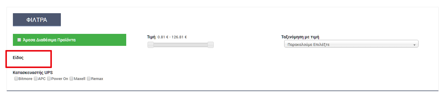

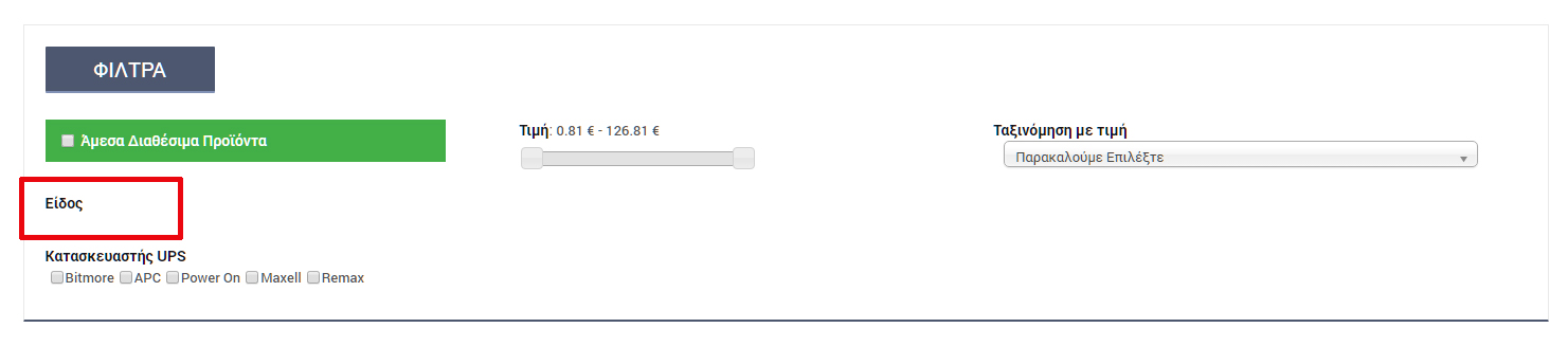

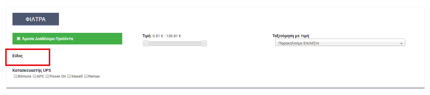

i had created a filter a long time ago, it used to be working just fine. Today i noticed that the values aren't there!
Custom field with values is created, i applied the filter to the custom field, each product of the specifiec category has it's own value selected.
I have no idea what could have happened here.
Any ideas please?
Thank you in advance

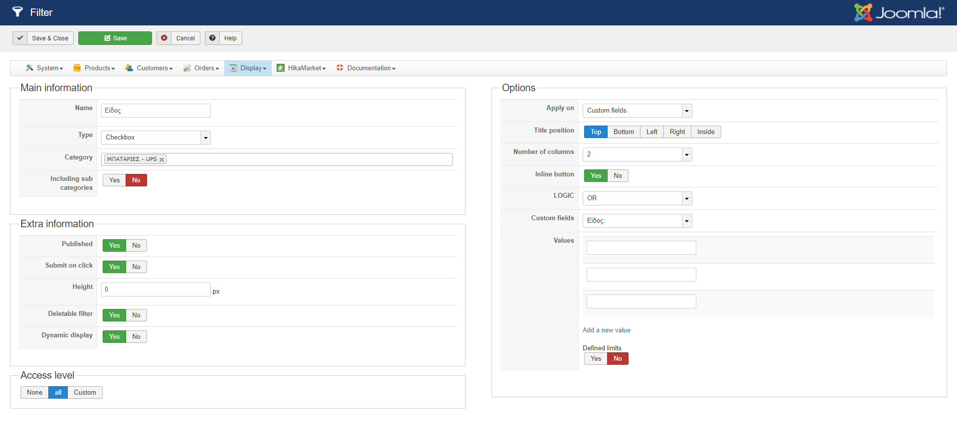

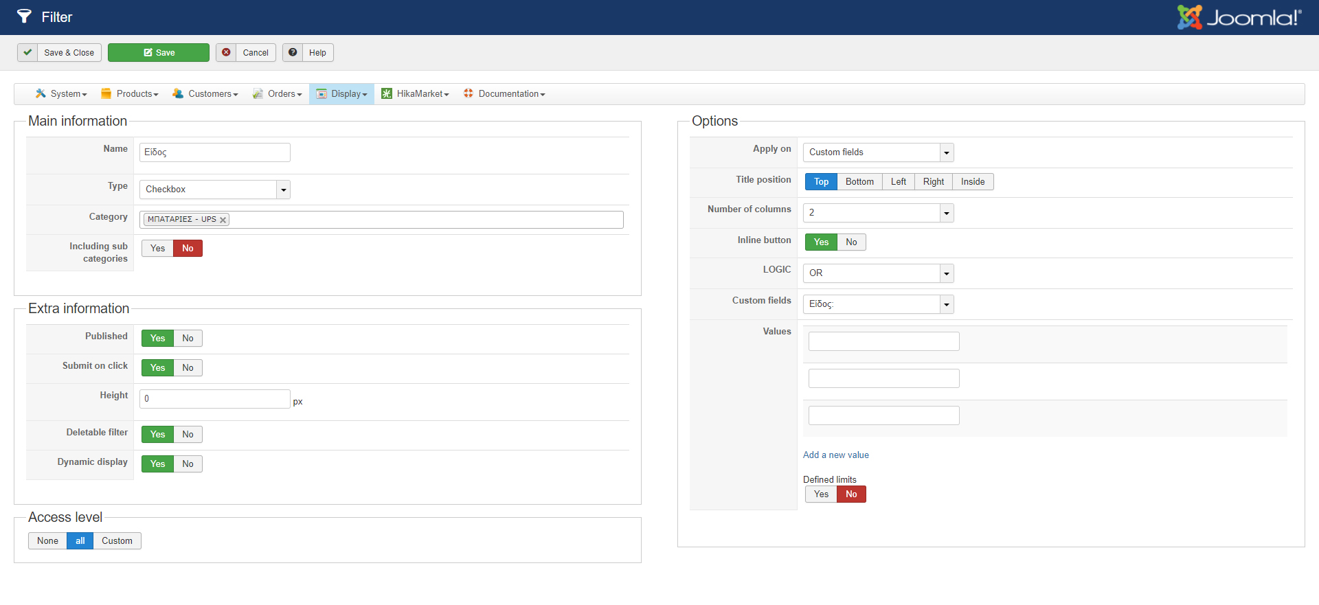

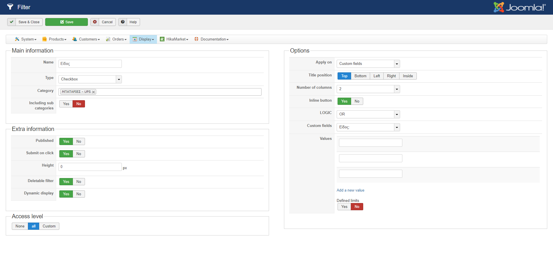

Could you provide a screenshot of the settings of your filter ?
  • Posts: 1184
  • Thank you received: 13
9 years 2 months ago #272494
here it is
Thank you
