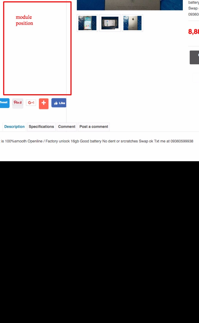

  • Posts: 490
8 years 11 months ago #273661
hi again
sorry i forgot to add the screenshot. i attached it below.
it is the module position sidebar 1 in my template. i think joomla thinks that module position is not empty so a white space is being allocated for the module.
BTW i am using advance module manager and i already set "hide if enabled = Yes"
  • Posts: 85786
  • Thank you received: 14079
8 years 11 months ago #273663
This has nothing to do with HikaShop or Advanced module manager.
It's your template which doesn't handle empty module positions :
www.regularlabs.com/forum/advancedmodule...mpty-area-on-sidebar
The following user(s) said Thank You: ronron
