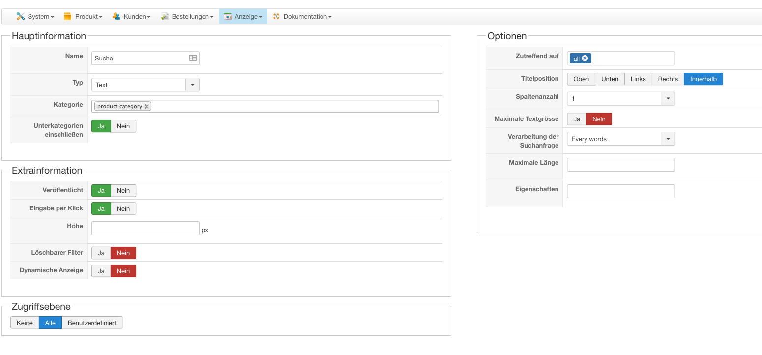

the option "submit on click" is turned on but it does not work.
What is wrong?

thanks for reply.
That's what I thought. I've already tried it, but there was no change.
Now I have tried again. It still does not work as it should. What do I overlook? Do you have a clue?

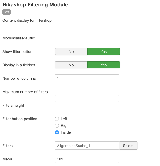

You need to configure the filter module so that the button is displayed inside the form and not outside. There is a setting for that there.
Otherwise, if the button is outside, it won't be seen by the form.

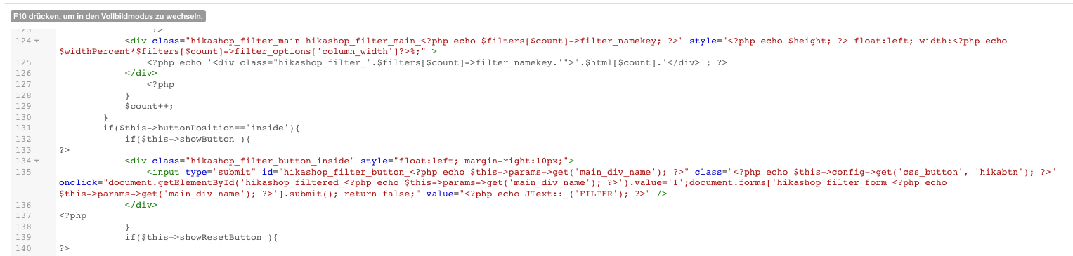

You'll have to edit the file "filter" of the view "product" via the menu Display>Views and change the lines:
Code:
<a href="#" id="hikashop_filter_button_<?php echo $this->params->get('main_div_name'); ?>" class="<?php echo $this->config->get('css_button', 'hikabtn'); ?>" onclick="document.getElementById('hikashop_filtered_<?php echo $this->params->get('main_div_name'); ?>').value='1';document.forms['hikashop_filter_form_<?php echo $this->params->get('main_div_name'); ?>'].submit(); return false;"><?php echo JText::_('FILTER'); ?></a>
Code:
<input type="submit" id="hikashop_filter_button_<?php echo $this->params->get('main_div_name'); ?>" class="<?php echo $this->config->get('css_button', 'hikabtn'); ?>" onclick="document.getElementById('hikashop_filtered_<?php echo $this->params->get('main_div_name'); ?>').value='1';document.forms['hikashop_filter_form_<?php echo $this->params->get('main_div_name'); ?>'].submit(); return false;" value="<?php echo JText::_('FILTER'); ?>" />
8 years 8 months ago #288694
by studio-n
Replied by studio-n on topic Submit on click
sorry, but it does not work. The button is inside and the code is changed.
