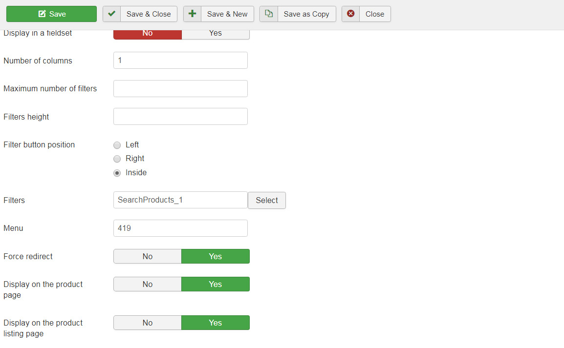

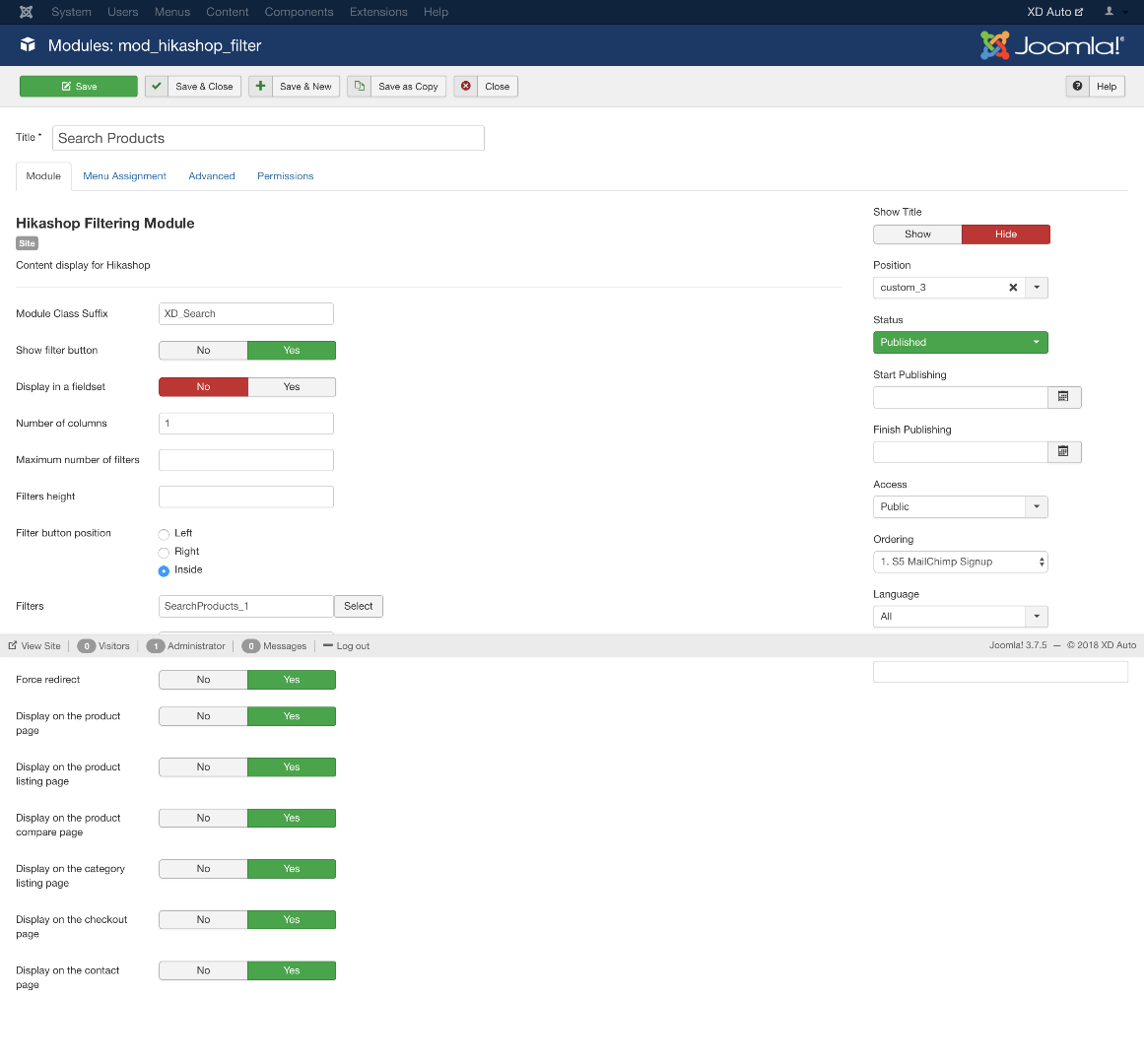

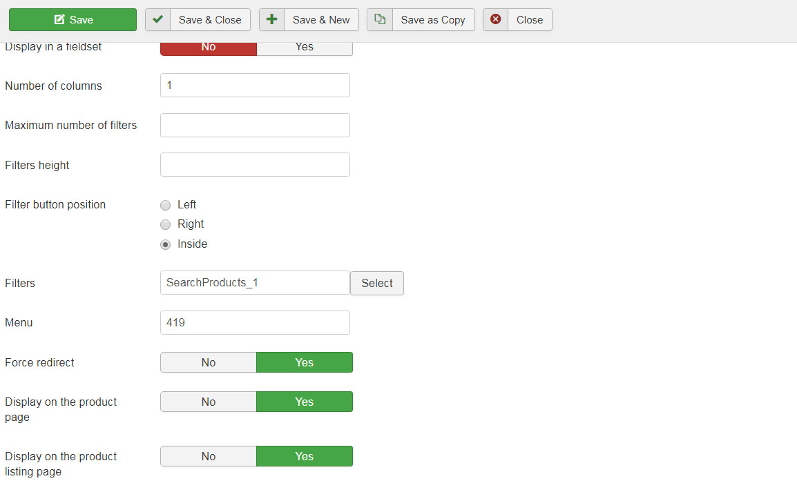

Hi, i am trying to setup a product search, but whenever i try to search something, it redirect me to 404 page. can you please guide me where did i done wrong?
Attached is my setting

In the filter module, you have an option "menu" (which we can't see on your screenshot).
There you're supposed to enter the id of a menu item which by default display all your products.
I suspect that what you entered in that setting is wrong.

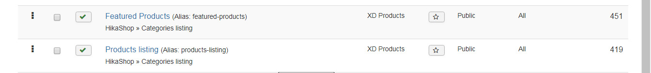

Hi, sorry the bottom part of my browser blocked tat field.
the Menu id i had already set but it showing 404, thats why i created this topic to look for help.

This is correct.
I've checked your website, but the URL generated for the filter form is not correct, and that shouldn't normally happen.
So I'm thinking that it must be a problem with an old version of an override of the view file displaying the filter module.
Rename the file templates/YOUR_TEMPLATE/html/com_hikashop/product/filter.php and try again after clearing the cache of your website and it should hopefully work properly, which would indeed indicate a problem with that view override.
