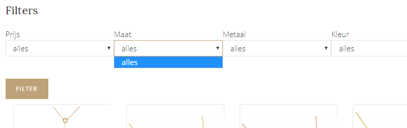

I have a problem with the functionality of filtering of my products. I have setup dynamic filtering on my custom fields. Unfortunately the filter is not working. I onle have the option in the pulldown 'all'. So the content of the custom fields is not showing. I have tried a lot to fix it and search the web and this forum to find a solution, but no.....

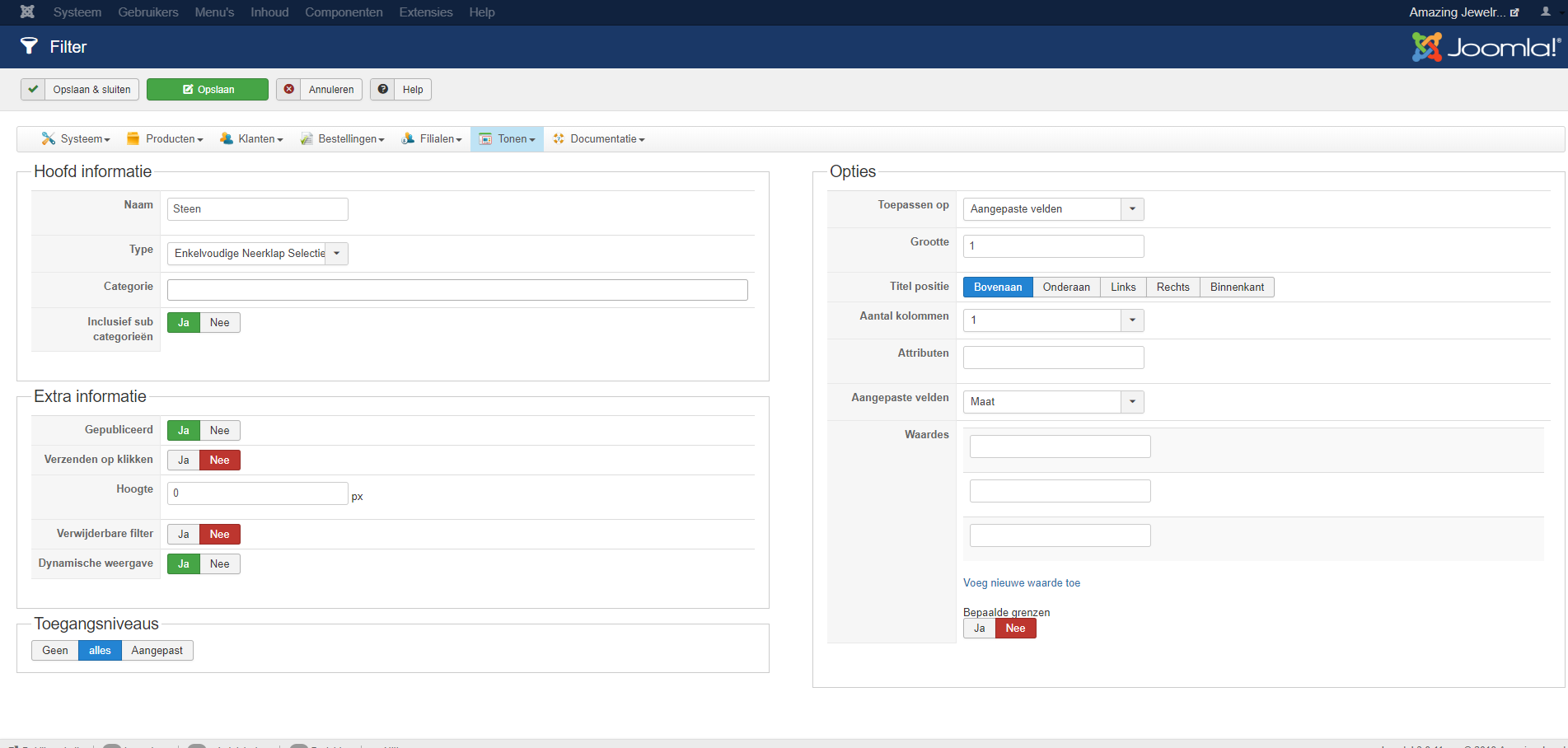

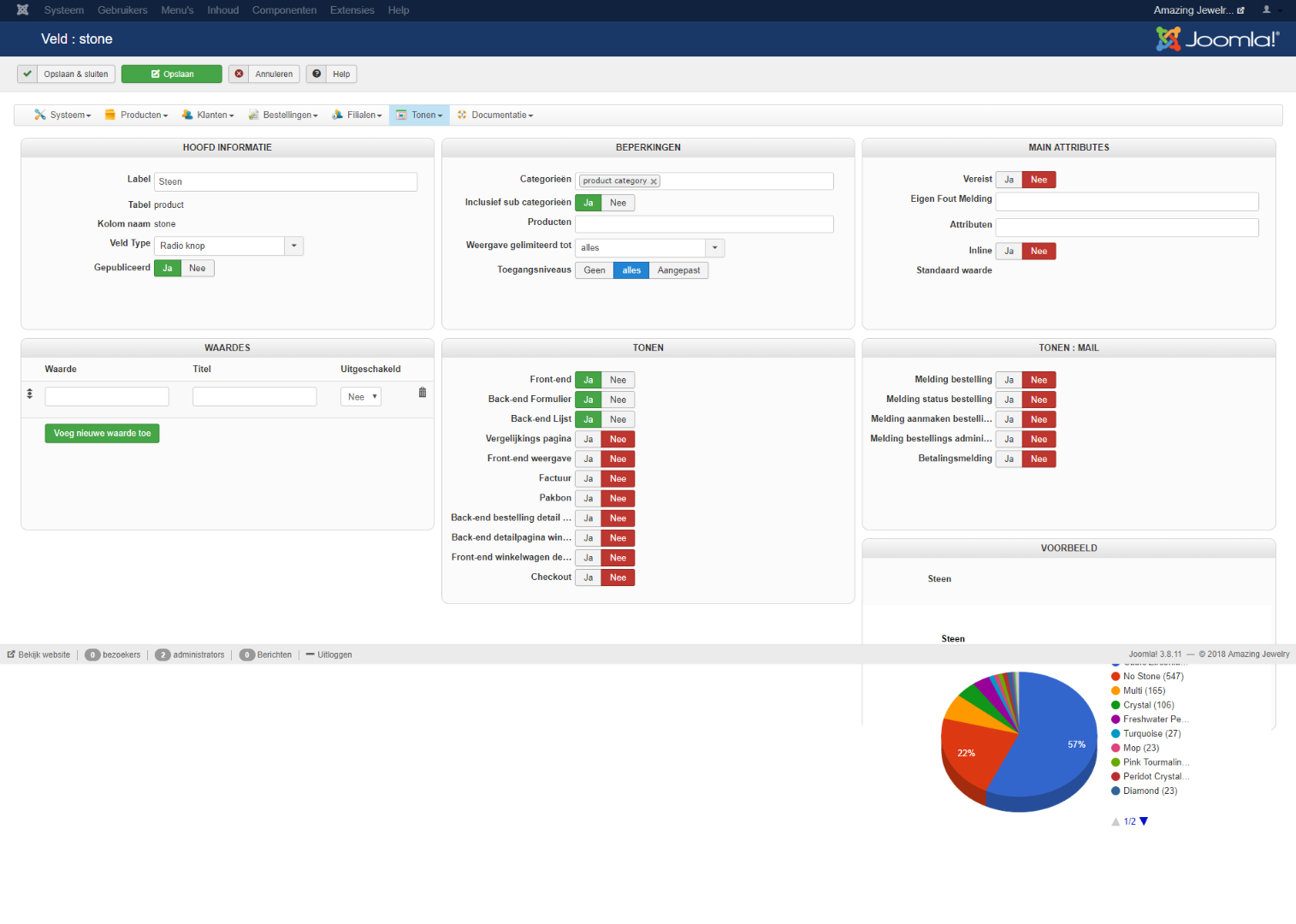

Would it be possible to have a screenshot of one of your custom field configuration and the configuration of the according filter ?
  • Posts: 62
7 years 10 months ago #296877
Hi, Sure, no problem. See the attached screen shots.

Your radio custom field do not have values ; I suppose that the reason why the filter cannot list the possibles values since it access that information from the custom field configuration.

7 years 10 months ago #296912
Hi Jerome,
Problem solved! I thought the data was taken automaticaly/dynamically.
