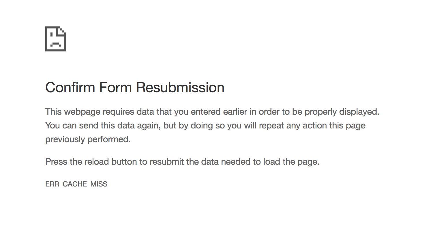

When using the Hikashop filter to search for a product twice in a row, then clicking the back button, you get the browser error:
Is there a way to fix this?

It's not really an error (although the browsers make it look like one...), it's just a page explaining you that you need to refresh and resubmit the data to get the page you want to display because it was previously displayed with a data submission.
But yes, you can turn on the "redirect POST mode" setting in the HikaShop configuration to avoid that. In that case, the filter selection will be passed through the URL instead of the POST and thus browsers won't display that "error" page.
