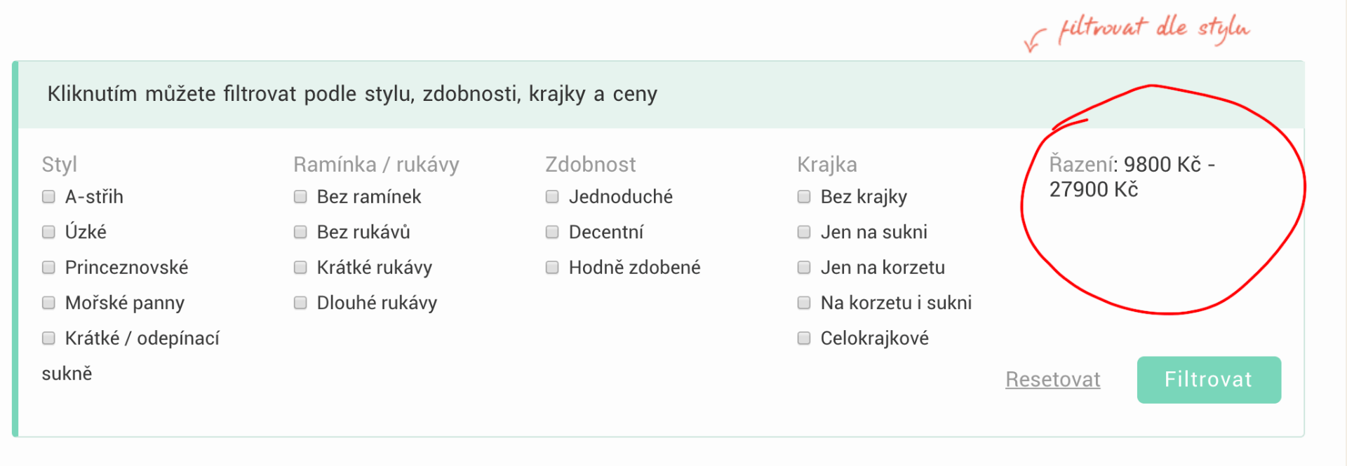

I am trying to set up a cursor for price filtering. Unfortunately, I also see only label and price range, but no cursor.
Please, could you kindly check it?
bit.ly/2J2Kuzu

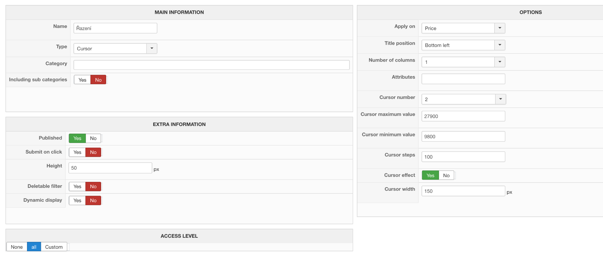

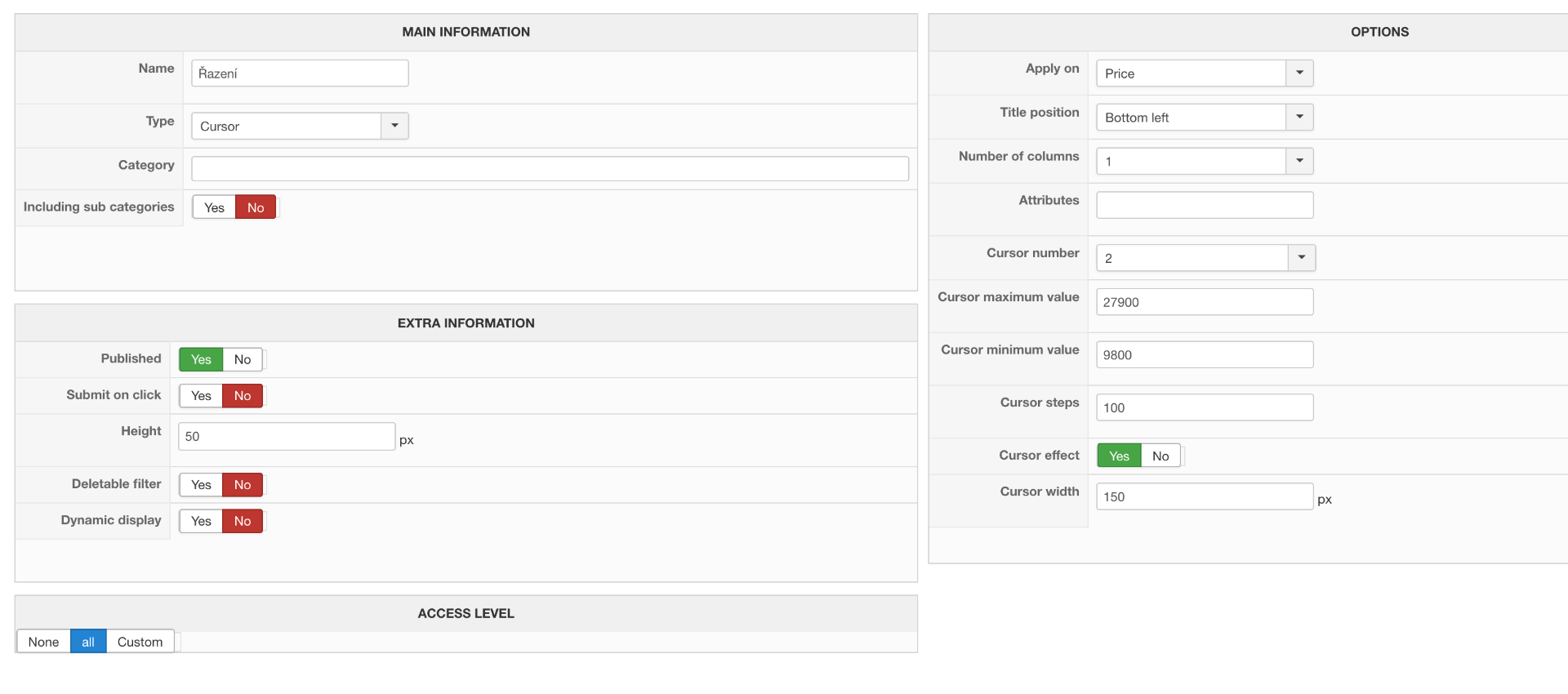

Also, I am sending you my configuration of that filter:
Thank you in advance for any help!

I reproduce your configuration, and on my side everything works as expected, so there something different on your website that maybe leads to this issue :

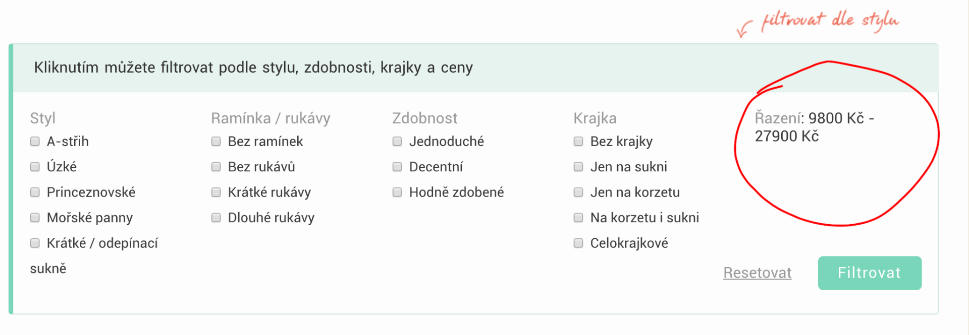

I also tried default template ProtoStar and the result is exactly the same.
You can see here on bottom:
bit.ly/2PAo8aV
Any other ideas, please?

The issue is that you set the "frontend CSS" setting of HikaShop to "none" instead of "default".
Because of that, a big part of the CSS of HikaShop is not present, including the CSS used to style the slider used for the cursor filters.
So you need to take the CSS from the default frontend CSS of HikaShop for the slider and add it to your template CSS, or you need to use the default frontend CSS of HikaShop.

Exactly! Copying lines related with cursor, ui-slide, etc.. resolved my problem!
