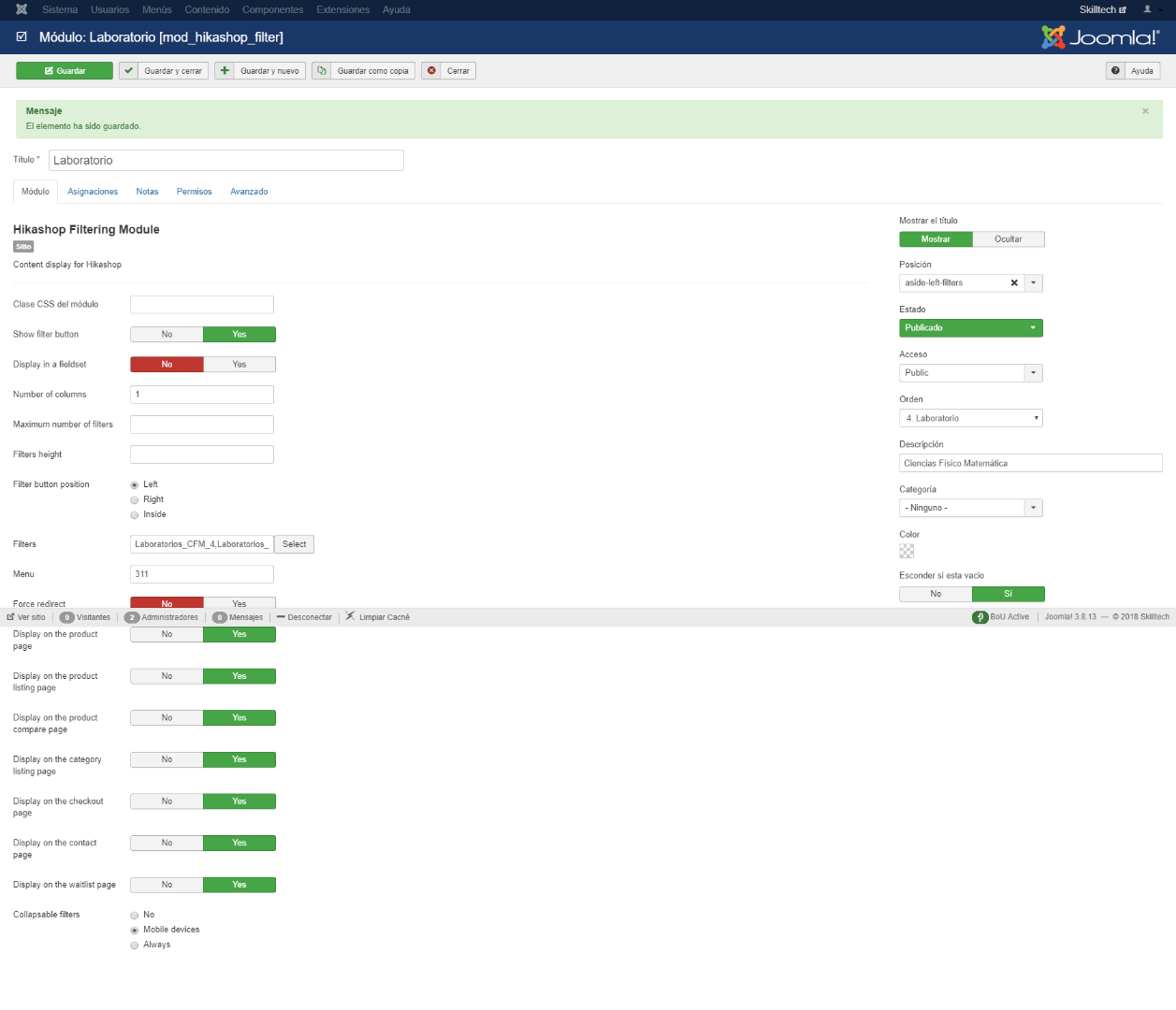

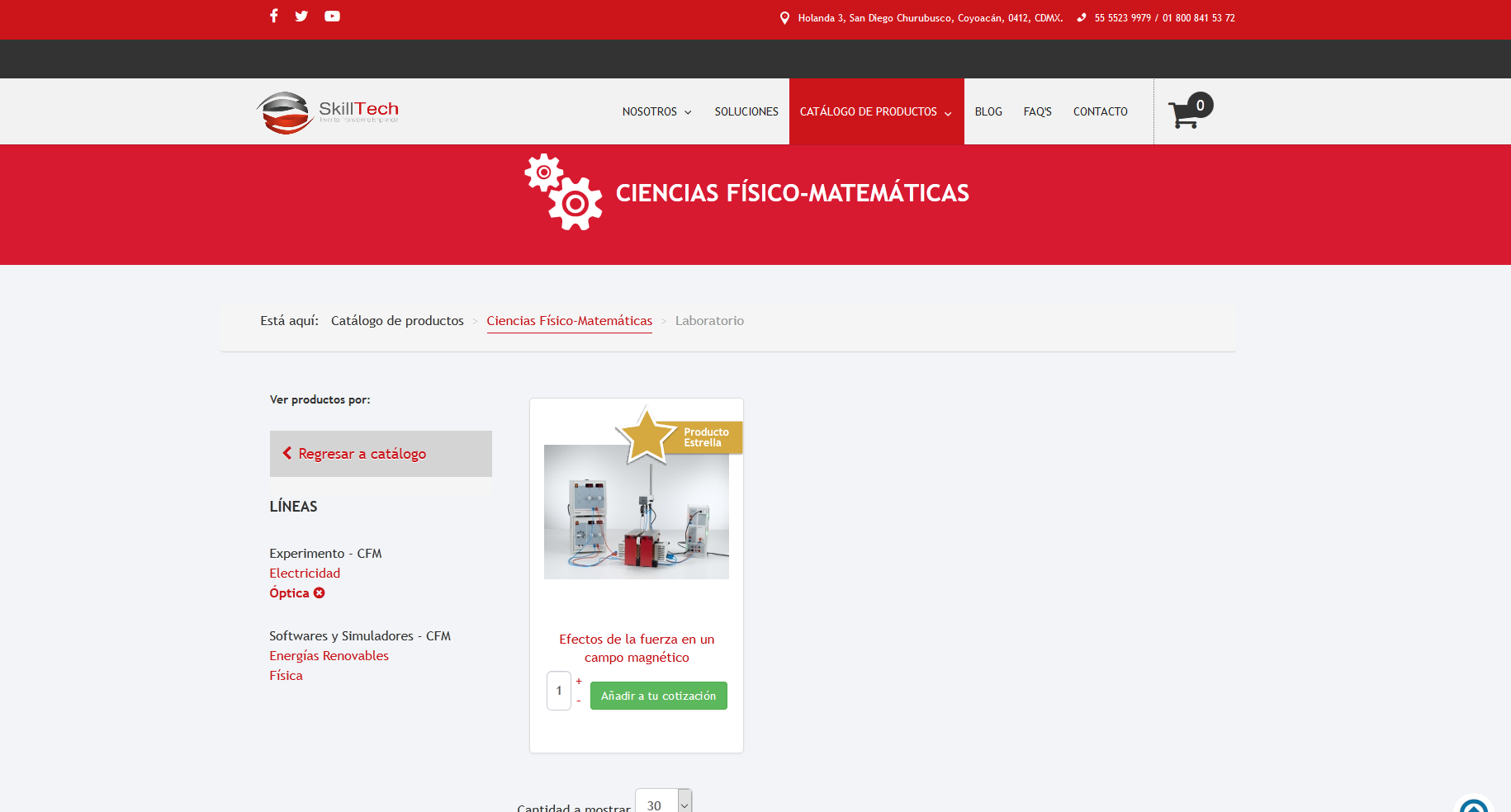

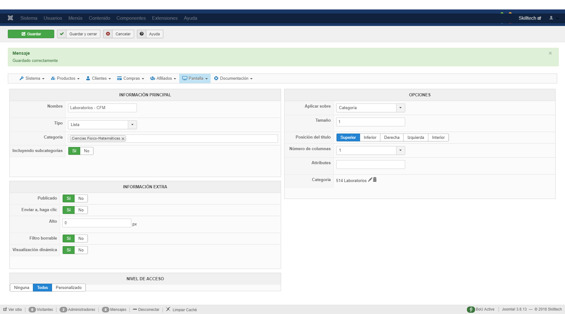

I'm currently creating a series of filters for a product page that are displayed in a module (01_normal.png). At first they seem to work with no problems, products related with the selected filter are shown (02_filter selected.png). However, when I try to remove a filter by clicking in the "delete" button, the page reloads but the module doesn't show all the filter options again, instead only the delete button appears (03_filter cleared.png).
The only way to display them again is by selecting other filter module or clicking the "Filtro" button. Nor Joomla or the server's error log show any issue.
I attach some images of the problem and the setting that I'm using for the filters and the modules.

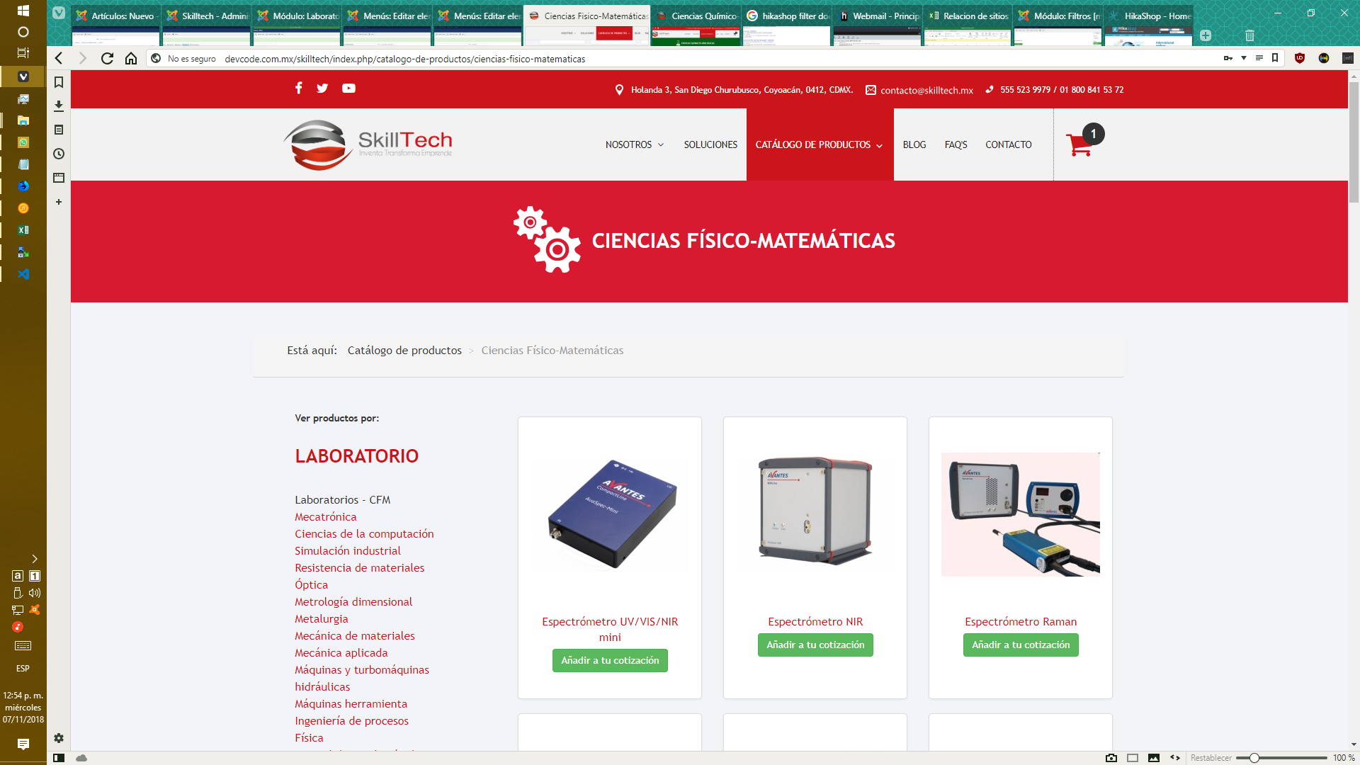

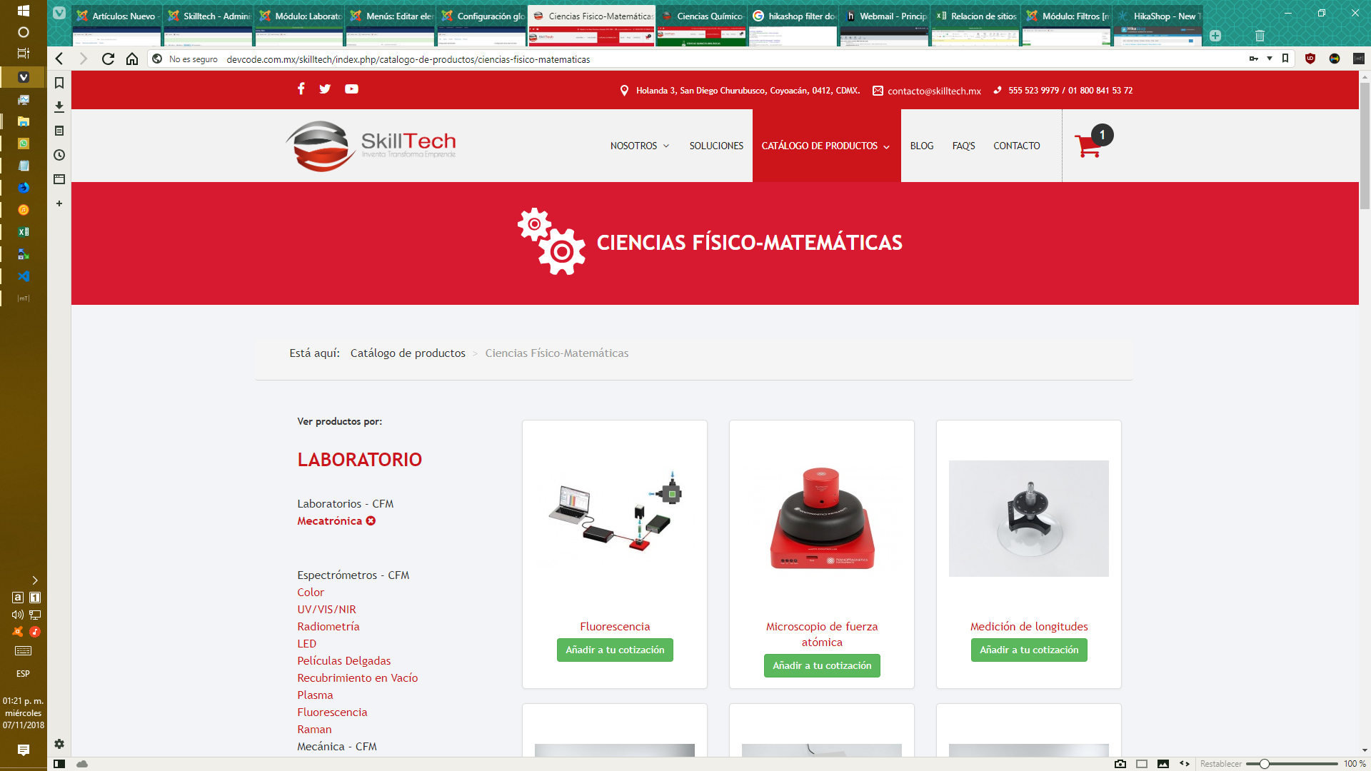

The thing is that my client isn't conviced on how the filter looked in some pages after I disabled that option. When a product is assigned to multiple categories of the same filter list, the selected filter and its delete button appears alongside the other categories of the filter list. Image 01
