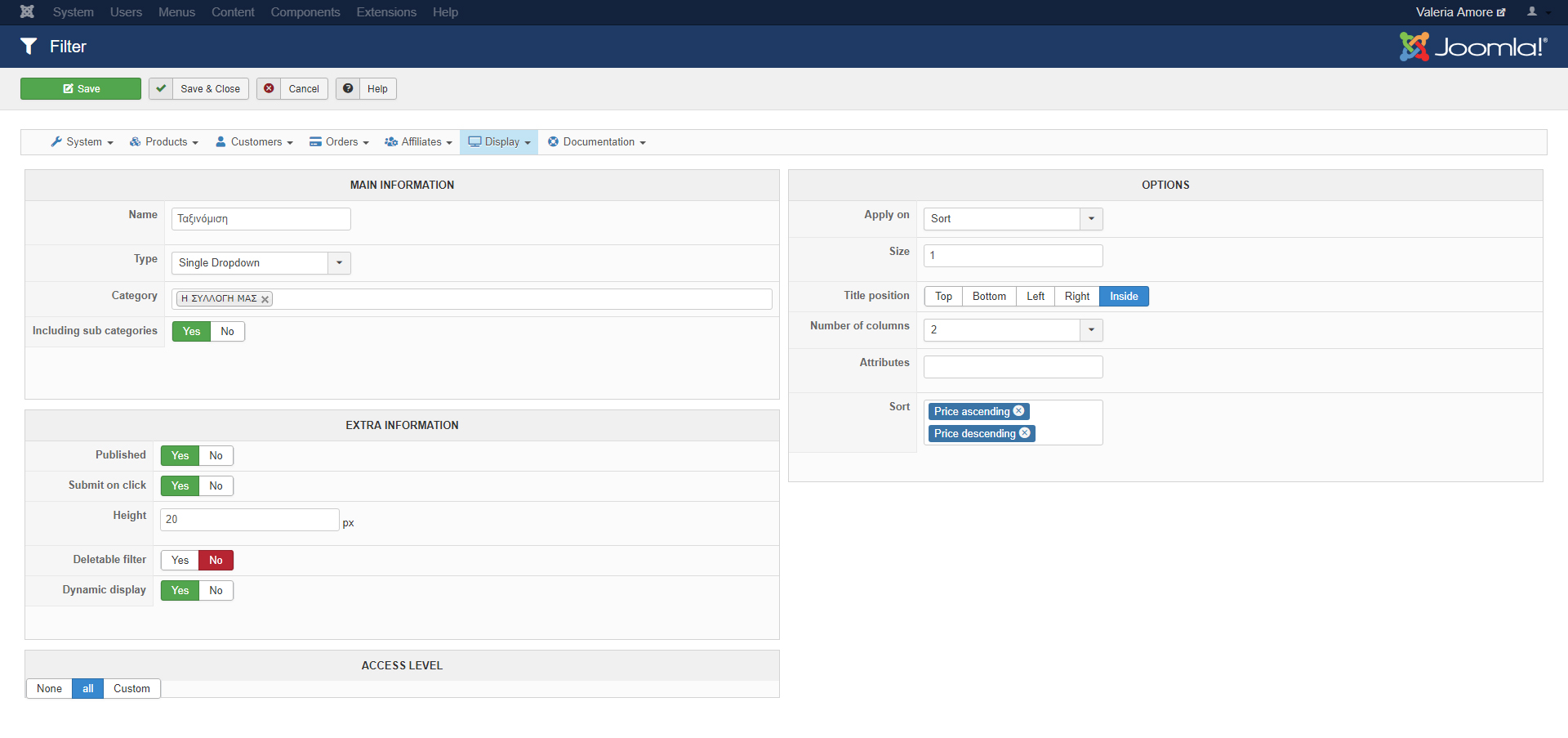

I have created the sort by filter but i do not see it ib product listings.
Am i missing something?

Try removing the category restriction of the filter.
And check that the filters display option under the "products options" tab of your menu item is activated.

if i enable the filter display option then all filter are displayed above product listing and i don't want that.
I have a filter module for all other filters in the left column of the page.
I need just the sorting filter above products.
Thank you

Then you want to turn off the filters display option of the menu item. And instead, you create a second HikaShop filter module via the Joomla modules manager and select only that filter in the module settings and configure it to display in the position at the top of the main area of your template on the product listings pages.
