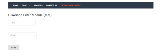

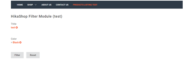

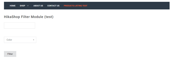

Hi, I have problem with „Deletable Filter” option for filters type TEXT and which have title position set as INSIDE. After removing selection using deletion button next to the filter field the title of the filter which should be inside the field is not visible (the title of the filter is visible only after usage of global RESET button which reset all filters selections and not after usage of deletion button next to the filter field). If I choose other title position for test field – for example left– the title of the text filed is visible after using deletion button next to the filter field. The problem concern only TEXT type filters – for example for single dropdown type filters with title position set as inside deletion function is working properly and title of the dropdown filter is visible inside the field.
Please find attached images:
1) filters before selection
2) filters after selection
3) filters after deletion using deletion buttons next to the filters which caused no title inside text type filter

5 years 11 months ago #308533
Try changing the line:
if(strlen($value) < 1) {
to:
if(strlen(trim($value)) < 1) {
in the file administrator/components/com_hikashop/classes/filter.php and that should fix the problem.
Ideally, I would recommend to not set the title inside for the text filters and instead add a placeholder and if necessary hide the title with CSS. It will be better for accessibility and you won't have that issue.

5 years 11 months ago #308558
Ah right, I was looking at the code of HikaShop 4.2.0 which is to be released soon, and I didn't think this area had changed.
With the 4.1.0, it's the line:
if($filter->filter_options=='inside' && empty($name)){
that you want to change to:
if($filter->filter_options=='inside' && strlen(trim($name)) < 1){

  • Posts: 84025
  • Thank you received: 13614
5 years 11 months ago #308748
Add the code:
		if($name == ' ')
			$name = '';
after the code:
		if(!empty($selected)){
			$name=htmlentities($selected[0], ENT_COMPAT, 'UTF-8');
in the administrator/components/com_hikashop/classes/fitler.php file and it should fix the problem once and for all.
