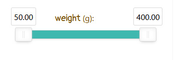

How to remove hundredths of grams in the filter?

6 years 3 months ago #320142
Before the line:
$options['range'] = '{min: '.$cursorMin.', max: '.$cursorMax.'}';
you can add such code:
$cursorMin = (int)$cursorMin;
$cursorMax = (int)$cursorMax;
$minVal = (int)$minVal;
$maxVal = (int)$maxVal;
in the file administrator/components/com_hikashop/classes/filter.php and that should hopefully do it.
