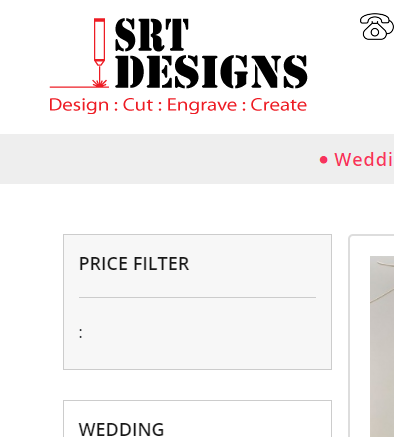

5 years 11 months ago #325384
by srtdesigns
Price Filter has lost its values was created by srtdesigns
srtdesigns.co.uk/wedding
-- Joomla version -- : 3.9.22
-- PHP version -- : 7.3.23
-- Browser(s) name and version -- : various
I was creating some new products when I noticed the Price Filter which usually shows £0 - £20 with a green bar between the prices has disappeared. It worked fine before and the only thing I can think is the latest version of Joomla has been installed since last checked. Any ideas?
