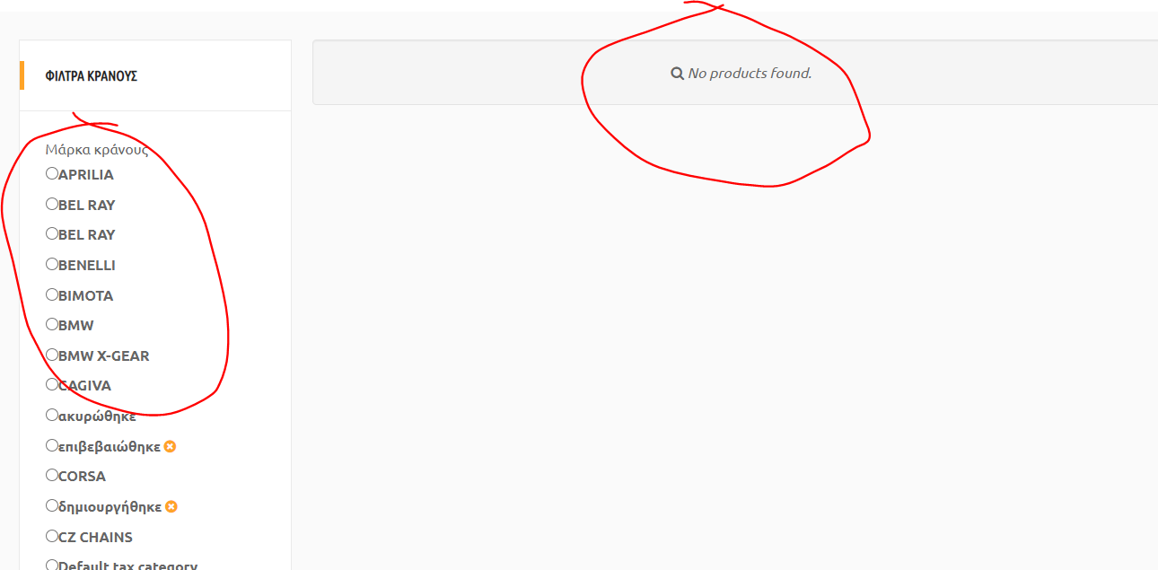

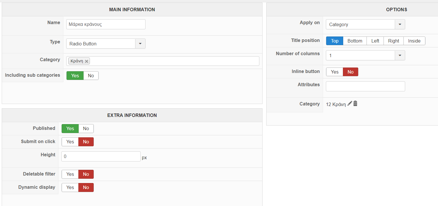

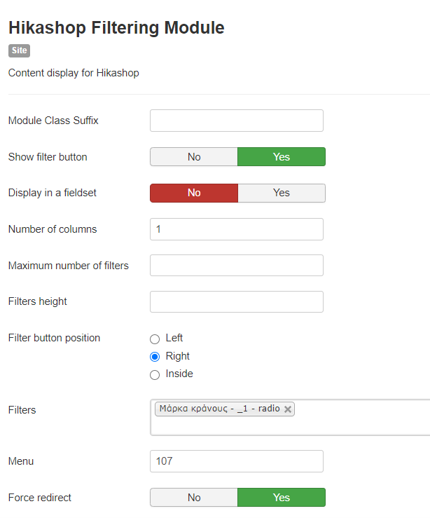

I'm using a filter for product categories.
I have setup the module and the filter accordingly but I get "no products found".
Url of the product category
liomas.eu/havellas-eshop/krani
Filter module settings
Filter settings
Thank you in advance!
Yannis

  • Posts: 64
4 years 7 months ago #326814
So I think I found the problem.
My products belong to a subcategory of the targeted category.
But the filter searches only products belonging directly to the filtered subcategory.
I have selected to "Include subcategories".
Can you fix this bug?

  • Posts: 84043
  • Thank you received: 13619
4 years 7 months ago #326844
I think we're going in the wrong direction here.
In the setting "menu" of your module, you've entered 107.
So the filtering will be done on the products displayed by default by the menu item with the id 107.
If that menu item is not a menu item of the type "products listing", or that this menu item is configured to not display any products by default, it would explain why you don't get any products when you use the filter of that module.
So I would recommend to first check the settings of that menu item via the Joomla menu manager.

  • Posts: 84043
4 years 7 months ago #326898
The menu item looks fine.
So I checked the situation on your website and the filter seems to work fine.
It seems that your grief with it is that it's only displaying the products directly inside the category selected.
However, there is no setting to change that.
The category filter is only capable of that.
The "include sub categories" setting of the filter is for the display of the filter, which means that if you display the filter module on a products listing, then the filter will display only based on that first "category" setting and the "include sub categories" setting.
For what you want to do, I would recommend to approach the problem differently.
Instead of creating a category filter, I would recommend creating a "HikaShop content module" configured to display the categories in the sidebar position. Then, when clicking on a category of the module, it will display the products of the category clicked on, and since your menu item is configured to display all sub elements already, it will display the products of the sub categories.

  • Posts: 84043
4 years 6 months ago #327043
It's indeed a good idea to improve the documentation on that.
Regarding the use of a categories listing module, I don't see the problem. You can have the categories listing module on top of the filters module. The customer can click on a category to get the products of that category. And then he can uses the filters on the module to filter the products of that category.
One thing you need to be careful though is that you need to deactivate the "force redirect" setting if you have it activated as otherwise, the filter module will ignore the current category he is in and will filter the products of the menu item you have in the "menu" setting of the module.
