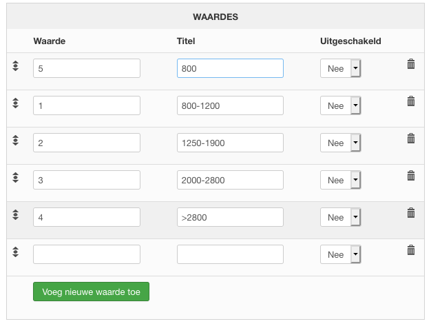

Trying to use the less-than sign (< or
&lt;
) as part of a value of a custom field. It doesn't work while the greater-than sign (>) does. See screenshot. What to do about this?

I found the issue is related to Joomla's filtering for security.
Change the code:
$field->field_value[] = $safeHtmlFilter->clean($title,'string'). '::' .  $safeHtmlFilter->clean($value,'string') . '::' .  $safeHtmlFilter->clean($disabled,'string');
to:
$field->field_value[] = $safeHtmlFilter->clean($title,'raw'). '::' .  $safeHtmlFilter->clean($value,'raw') . '::' .  $safeHtmlFilter->clean($disabled,'string');
in the file administrator/components/com_hikashop/classes/field.php and it will fix the problem.
