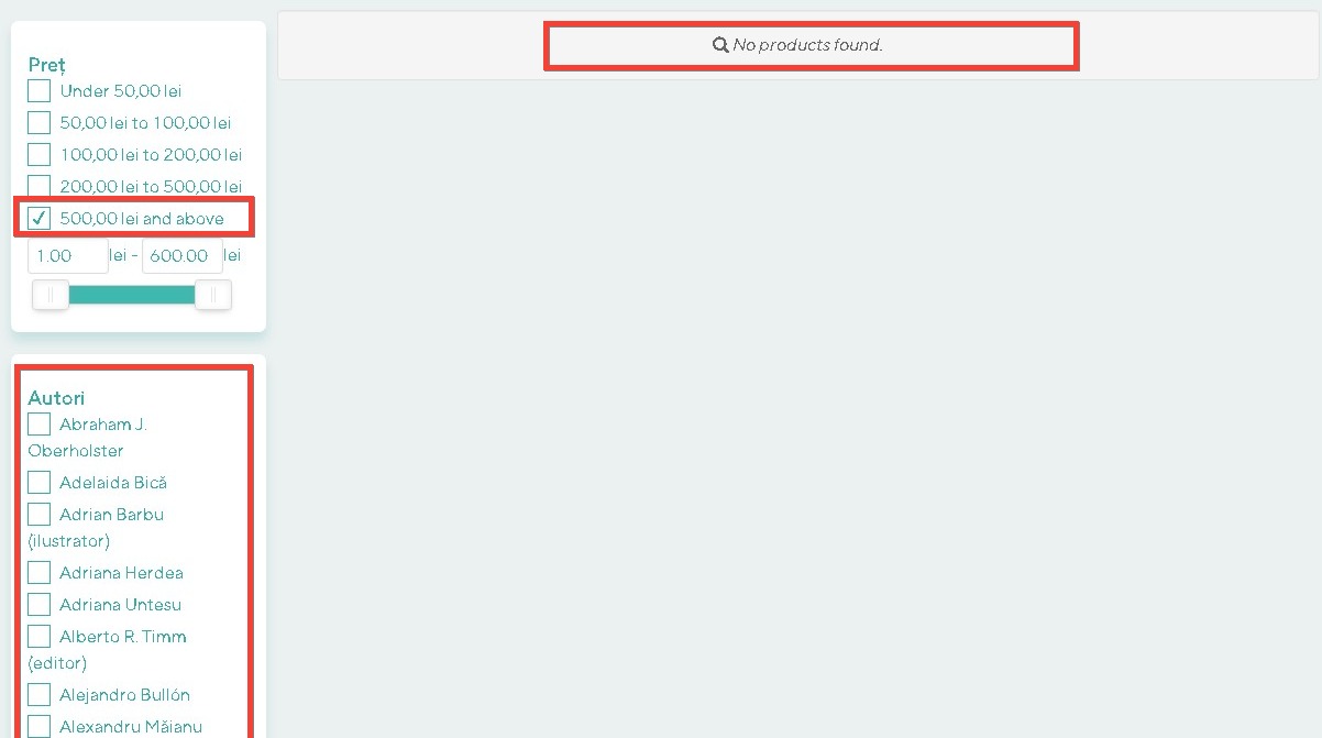

All the filters from my page are set to "Dynamic display: ON".

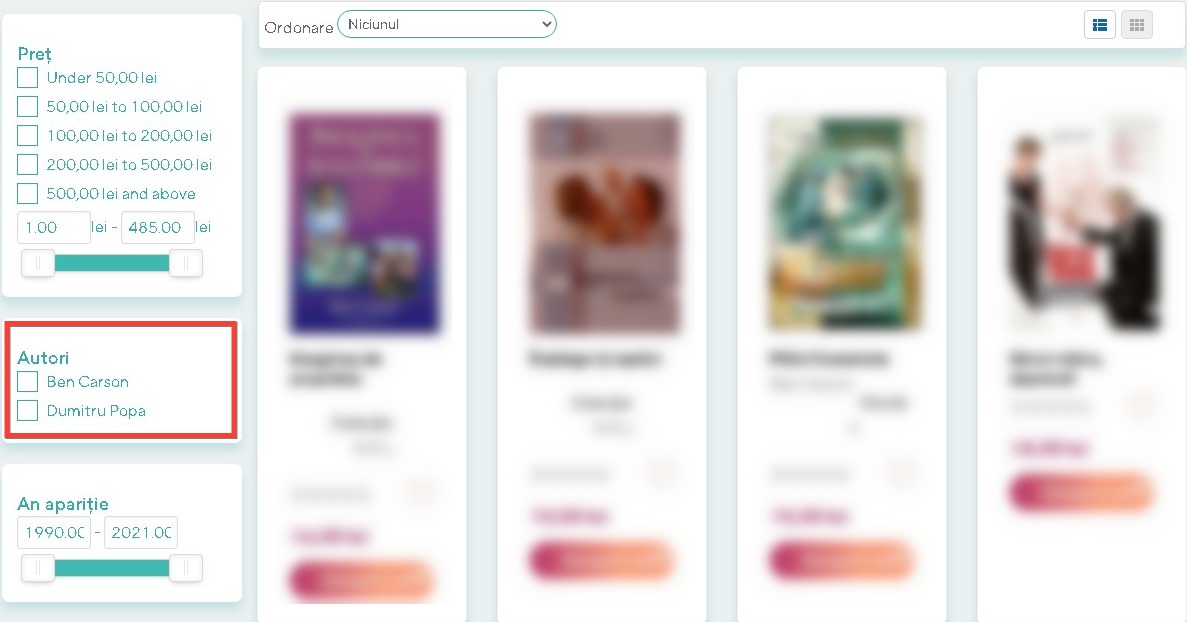

I have a filter that show a list of checkbox's with Authors and is working well until I use another filter and that filter doesnt applay to any product, so the result it is: No products found.
But also, the filter that shows the Author's, it will show all of them, is this how it should work?
I'm expecting that the filter to not show any of the authors.
And the same thinck is happening with all the filters that are set to Dynamic Display

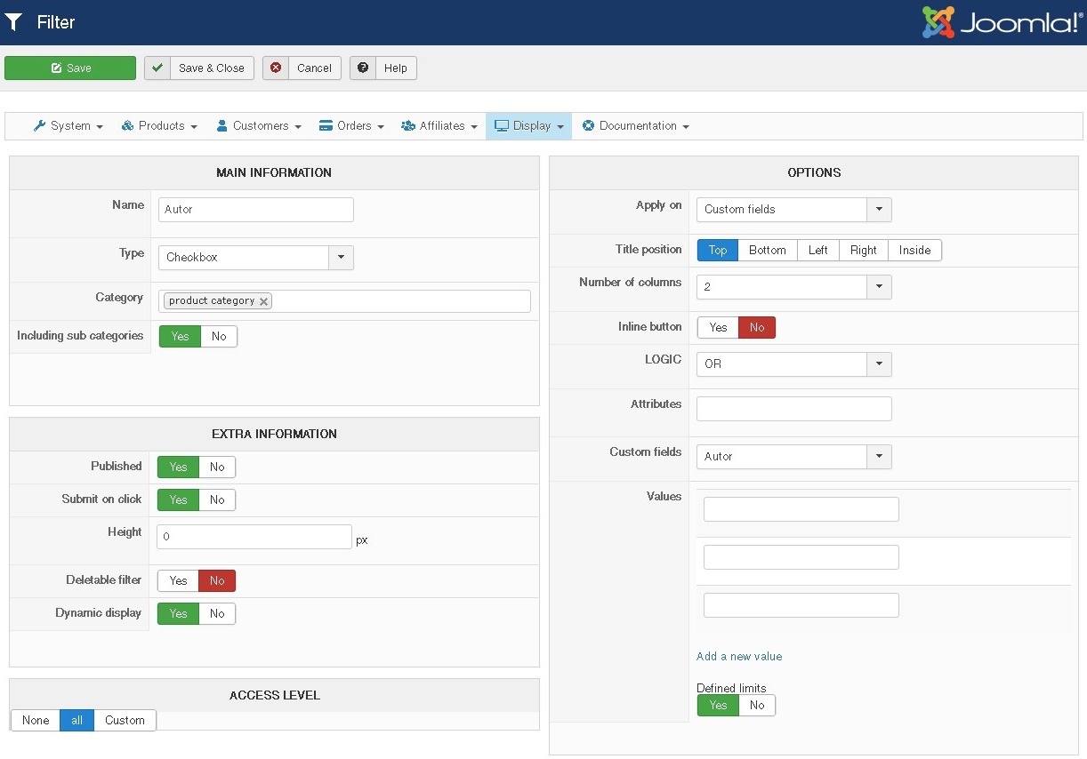

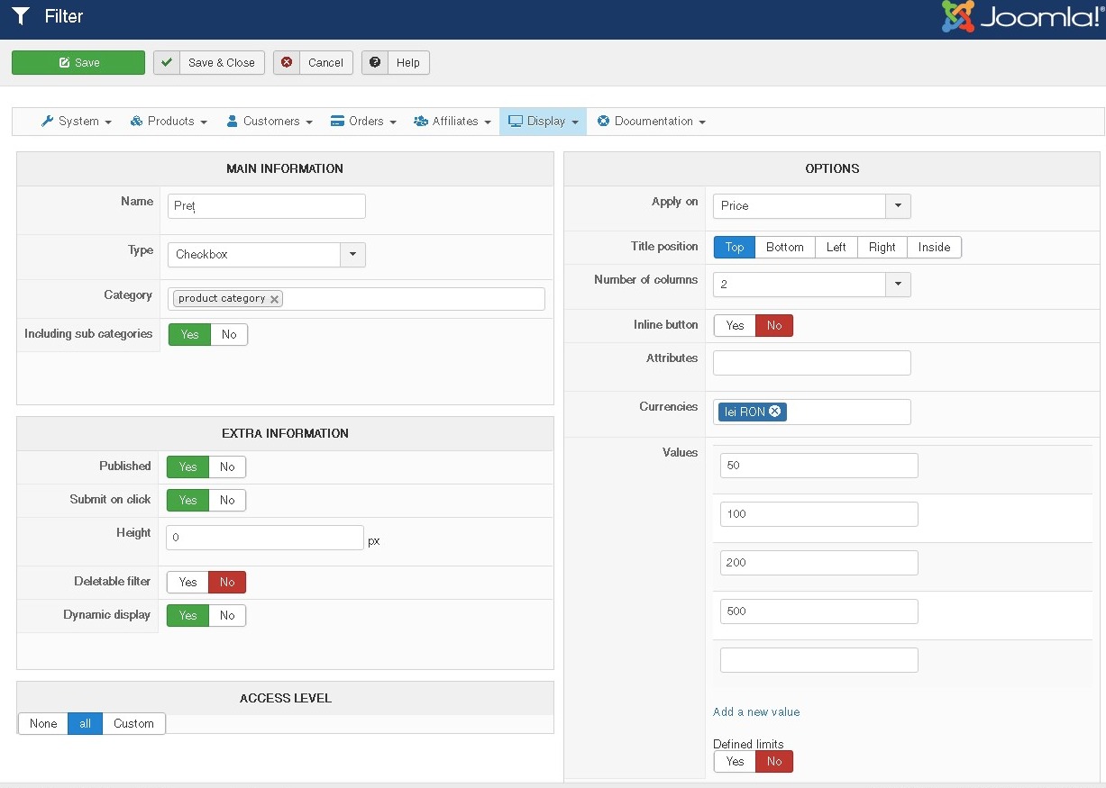

in order to better understand the situation can you provide these elements :
- An Url link to the issue.
- A step by step process in order to reproduce your issue
- your relative filter settings screenshot
Awaiting your returns to be able to progress on your subject.

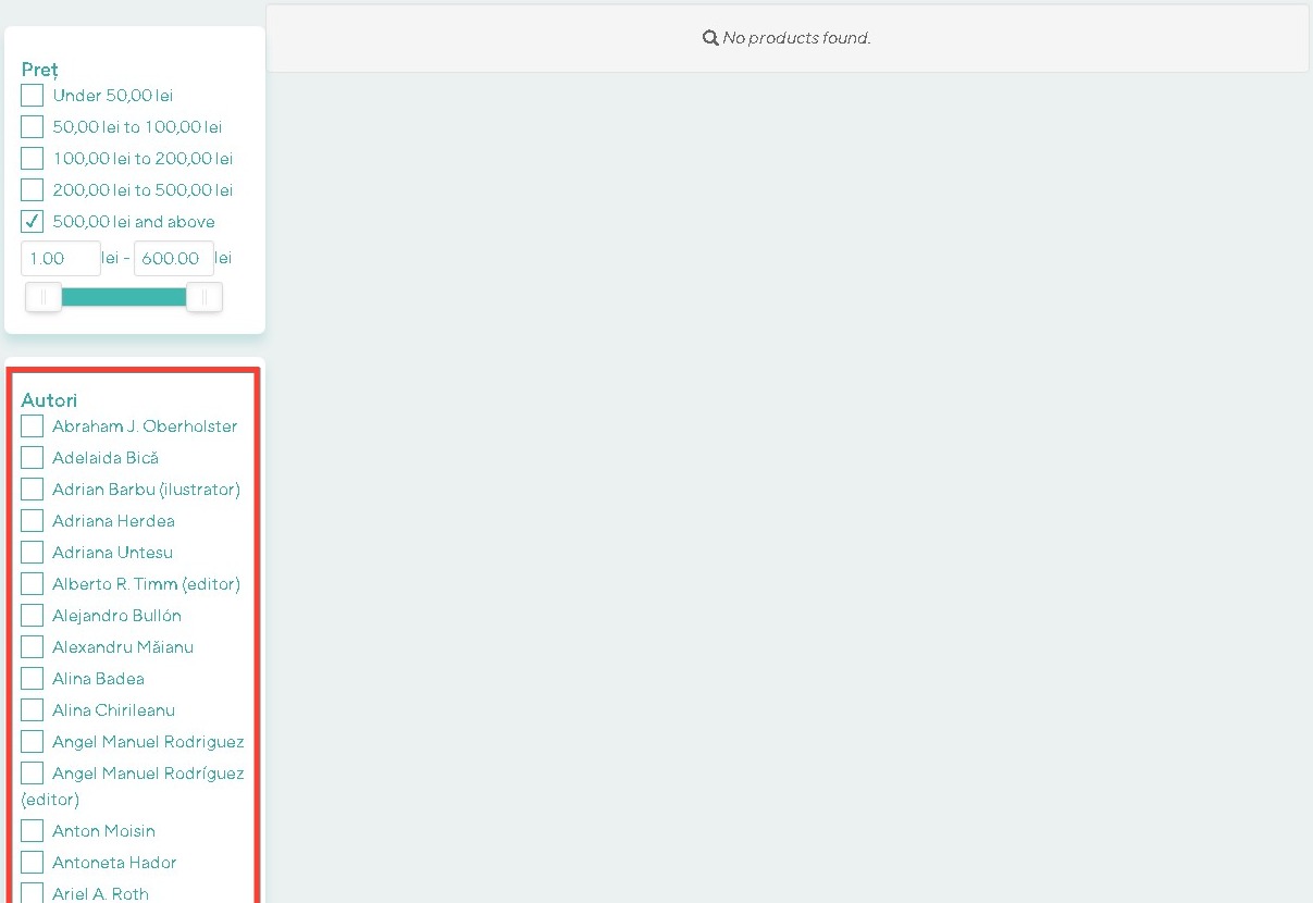

- From the first filter select the last checkbox (500,00 lei and above), that is the price.
There is no product with the price of 500 or above, so theresult it will be "No products found".
In the second filter "Autori", witch it means "Authors" you will see the entire list, but in back-end, only 2 Authors are set for 2 or 3 products.

I've made a patch for that. Please download the filter.zip file attached and replace the file administrator/components/com_hikashop/classes/filter.php by the file in the zip and it should hopefully change that behavior to work like you want.
Please report the result of the test so that we can add that for the next version of HikaShop on our end.

The filter behaves the same.
I made sure I put the file where it should be, cleared the cache and tried several times.
