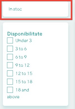

I have create a filter of type " In Stock Checkbox " and the checkbox is not visible in the front-end, only the label.
Also, if I set the: Submit on click = No, in front-end I get this notecie:
Notice: Undefined variable: onClick in

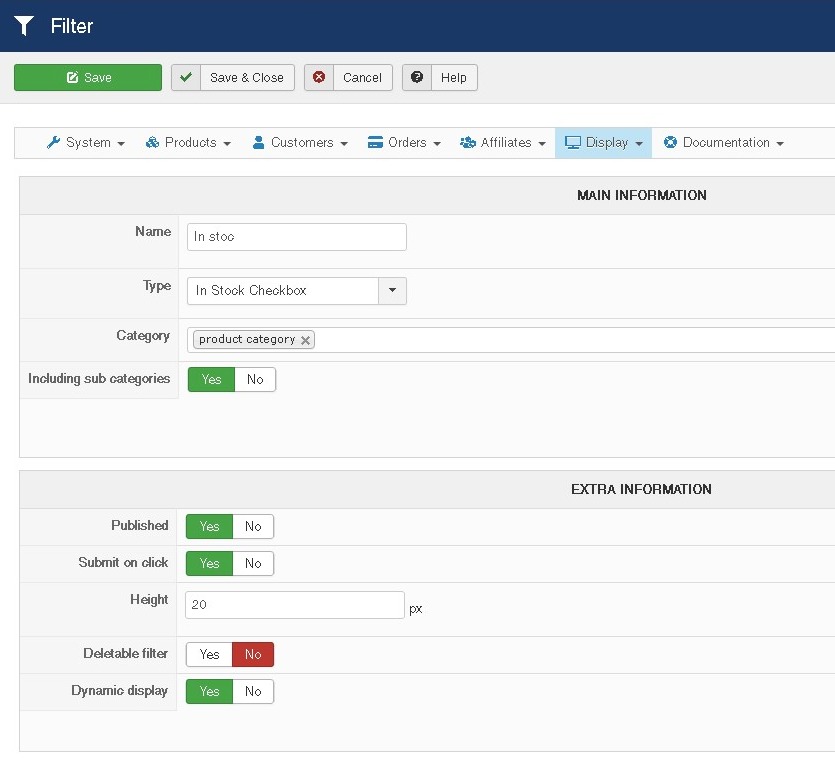

This is the filter config:

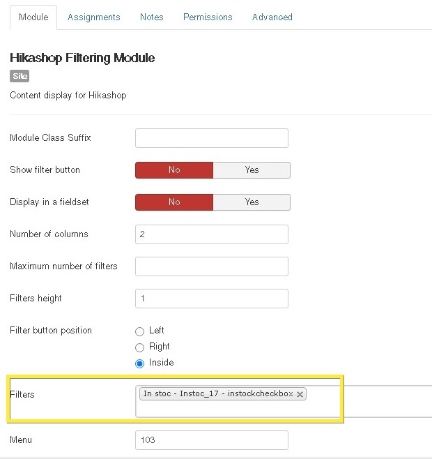

This is the module config:
The front-end:

5 years 6 months ago #330249
I'm not sure why the filter wouldn't display.
If you get the notice message, it means that the HTML for the checkbox is generated.
And I configured an "in stock" filter in the same way on my end and it displays fine.
So all I can think of is that it would be an issue linked to the template.
But if that was the case, the checkboxes of the other filter below should also not appear.
So it's probably not that.
Could you provide the URL of that page so that we could look at it ? Maybe there is some CSS targeting that checkbox ?

5 years 6 months ago #330339
Completely my fault, sorry for bothering.
I didn't checked well, the problem is caused by a css class that I have created to customize the checkbox .
