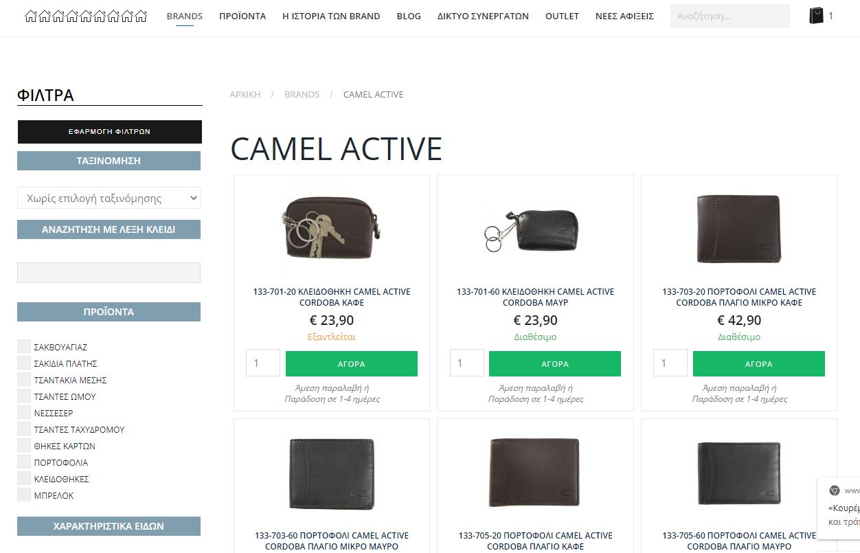

Something strange happens, in home menu item i use a uikit icon via this class "add-icon-home", when i search or check a hikashop filter this icon multiplies more and more. Is this coming from hikashop?

The issue comes from your template. When we refresh the different areas of the page in AJAX (with tmpl=raw), the template adds some of its javascript to add that icon:
i.imgur.com/QECteg3.png
There are several ways this could be fixed:
- modify the javascript adding the icon to replace the HTML instead of adding
- modify the javascript adding the icon to only add it if it's not already there
- add that javascript only when the tmpl parameter is empty in $_REQUEST
Any of these three solutions need to be implemented in the template so you'll have to your template support.
