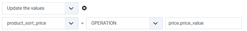

there's something weird about updating a value and then displaying the results via a mass action. In the result display, it looks like the updated value contains the equation for the new value instead.
This only happens for displaying results immediately after changing the value. If I run another mass action to display it again, the value is correct.
EDIT: It's very simple, but here's the mass action that corrects the inconsistencies:
Last edit: 3 years 2 weeks ago by NTV.
