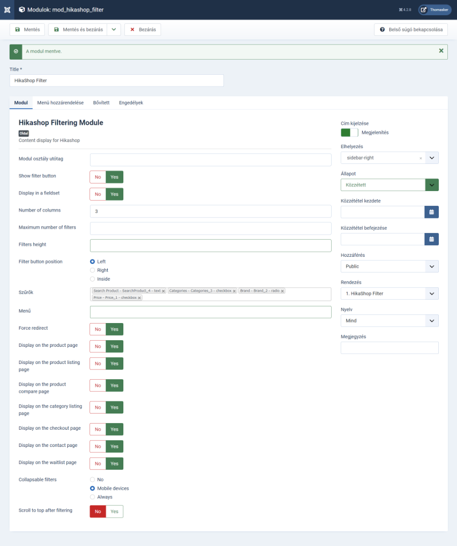

Hello my name is Aron! I need a help.We use a hika shop however the module filter not display. The position is good I checked it. The module is also switched. But the title doesn't even appear. What might be the problem ? :( :( :(

It's probably that the filters themselves are configured to not display where you've configured the module to display. Either the filters are unpublished, or their "category" setting is set, which means the filter would only display in the selected category, and your page must not be the page of the products listing of that category.
