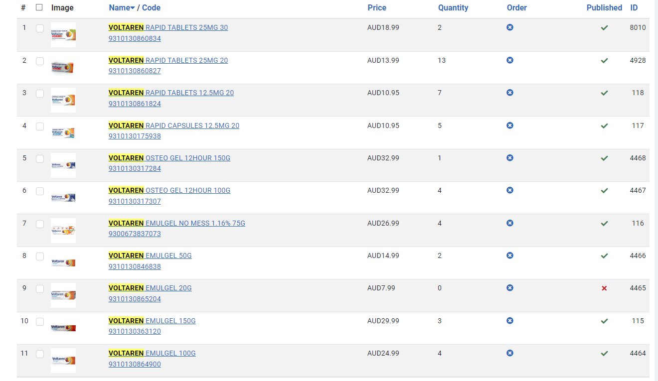

this is a weird one. We keep getting a 403 error when we search for 'Voltaren' on the front end using smart search. It has been indexed several times. We've cleared out the canonical urls and but the issue persists. Users can navigate to the 'Voltaren' products ok and 'eb ajax search' finds the items perfectly well. Also, the suggested terms are working ok with 'Voltaren' in the 'smart search' search box. Even when I unpublished the products and re-indexed to ensure nothing would show up, it still got a '403' error upon searching for this term.
It's a new site we're building so I can't guarantee it will be up all of the time. Any ideas would be helpful.

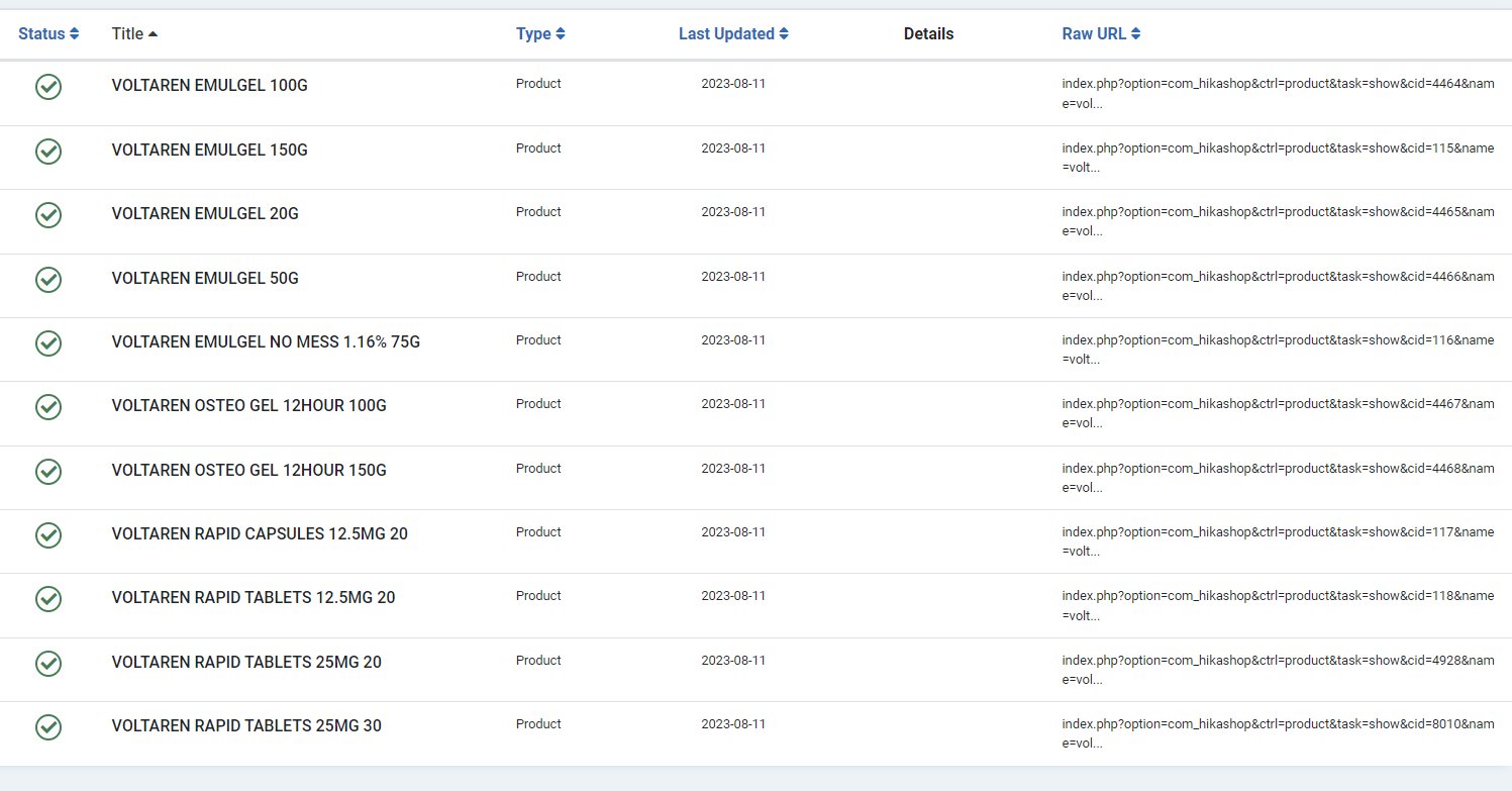

the only error shows up as part of the Smart Search indexing;
"Duplicate entry '1-0' for key 'PRIMARY'"
Let me know if clearing out a specific db table will help. Otherwise we might leave it to see if a future version of J4 fixes the issue.

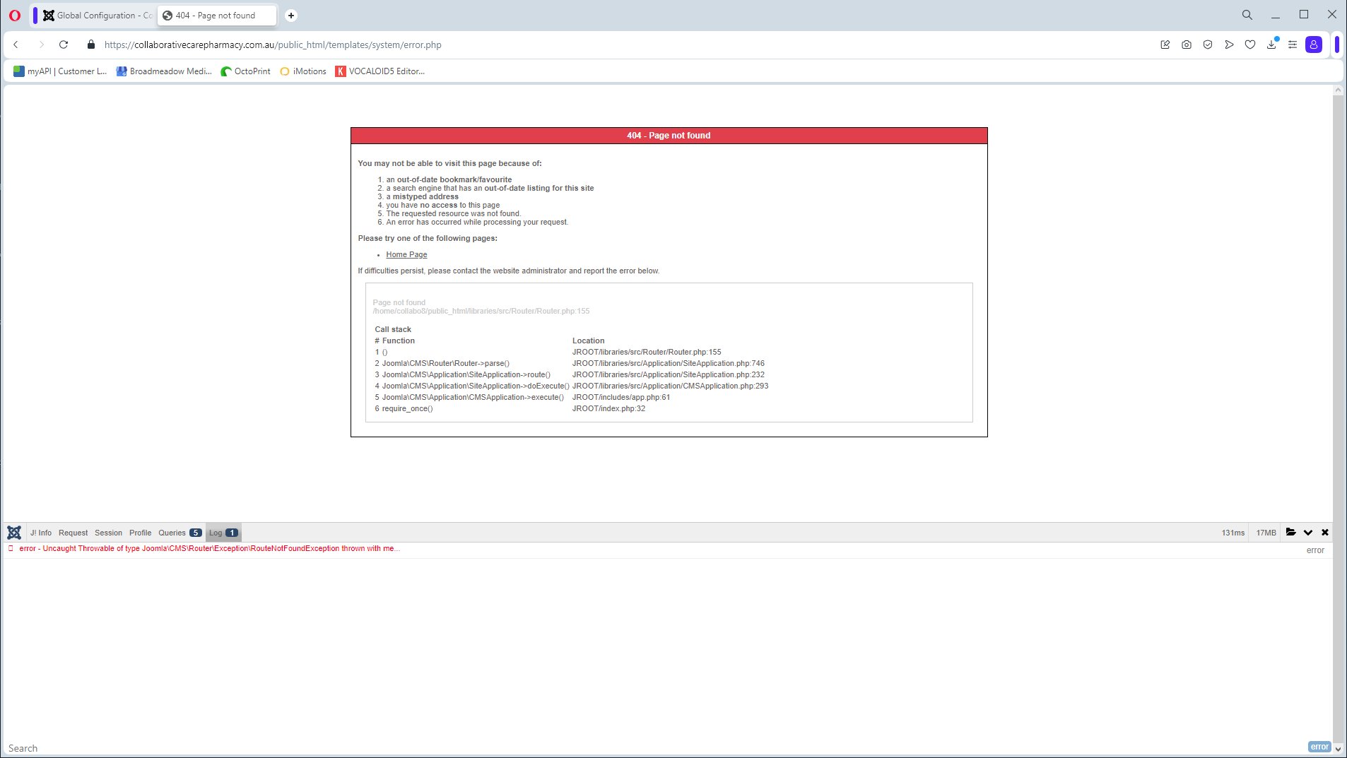

have pm'd you with backend access. I did change the 'error.php' in the template directory but the debug info still didn't show up.

I was able to activate the system error.php and debug for you to check out. The best way is to enter 'Voltaren' via the 'Advanced Search' page.

You're not supposed to call the error.php file URL directly. If you do, you should normally not see anything. But even so, it won't tell you anything about your problem.
As I said, the source of the problem is not on your website. You need to contact your hosting support or server administrator (if you have your own server) as the problem is not on the website and you can't do anything about it from the website itself
