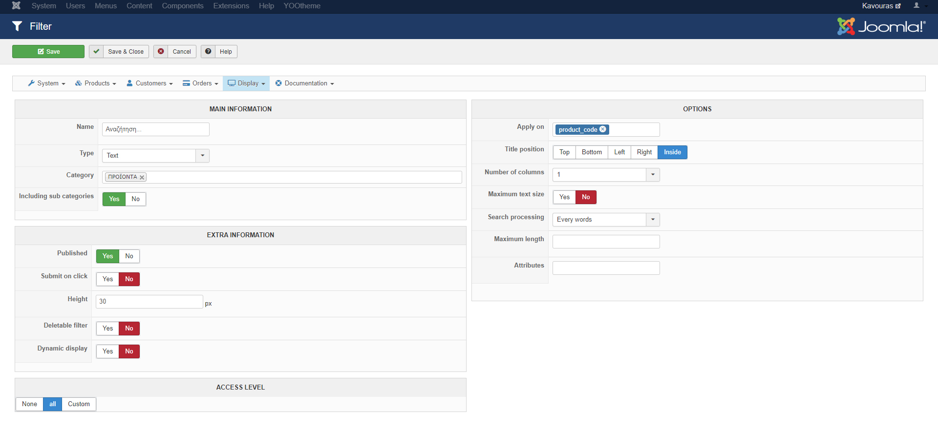

Hi!
I did it but it's not working. I need the search filter to apply to titles also not just code.
Thank you

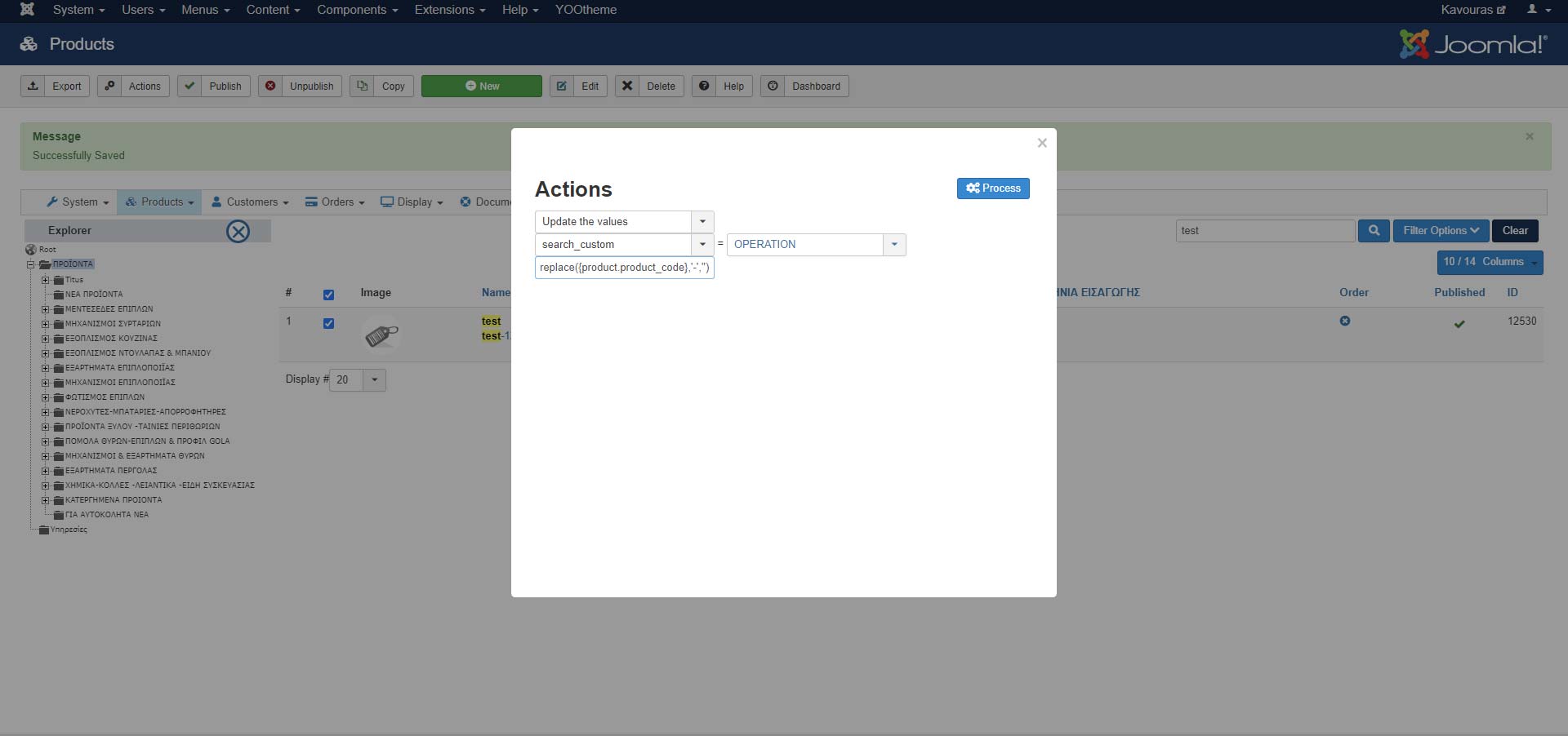

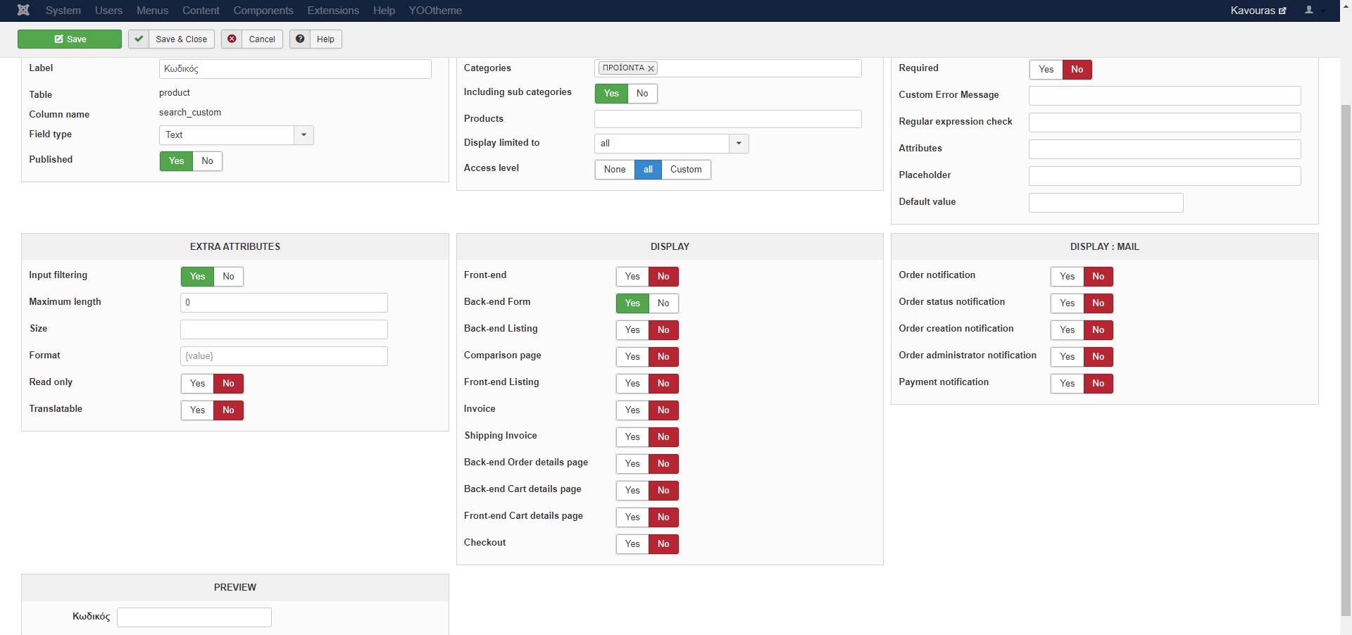

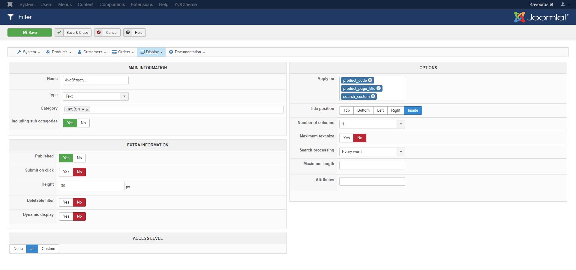

Hi!
I created the custom field and did the filter as you said but the mass action didn't work.
The value of the custom field after i ran the mass action is 0.
Could you check the screenshots if everything is correct?
Thank you!
  • Posts: 86180
2 years 11 months ago #355725
I would recommend doing it with a normal mass action (with a filter on the product_id to target only one product first) and see if you get any error when you run it.
Otherwise, you could also try running a MySQL query directly in the database via PHPMyAdmin. Something like that:
UPDATE #__hikashop_product SET search_column = replace(product_code,'-','');
