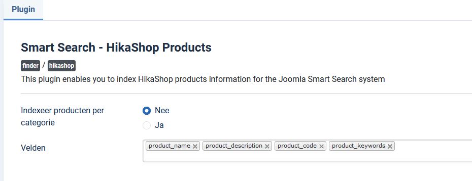

Could you provide a screenshot of the settings of your HikaShop finder plugin via the Joomla plugins manager ?

I don't seem to find variants in the index.
Re-indexed it etc.
Sure, screenshot attatched.

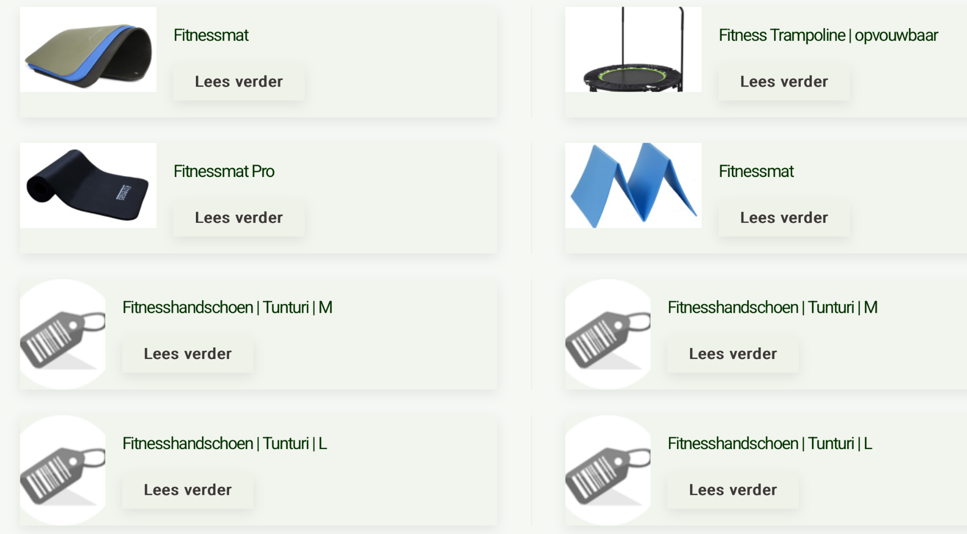

  • Posts: 122
2 years 5 months ago #359936
hi Nicolas and Nico,
The smart search works super fine now, but the variants doesn't show the standard product image, if there is not a specific variant image.
See the attachment.
best regards,

  • Posts: 86077
  • Thank you received: 14185
2 years 5 months ago #359952
Thank you for your feedback. I've made some extra modifications in order to handle that properly. Here is the new zip for the finder plugin:
