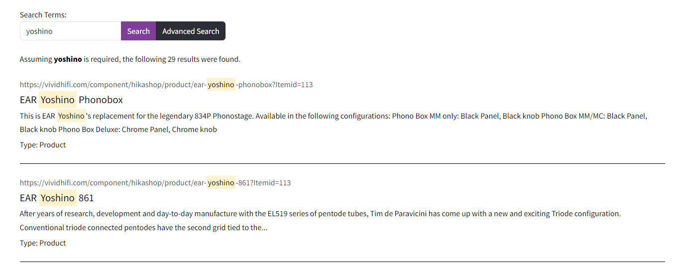

I am using Joomla smart search to search for products. The search results are displayed correctly but I get a page not found error when I click to open any product in the search result
This is the URL of the search results
vividhifi.com/component/finder/search?q=yoshino&f=1&Itemid=142
This is the URL when I click a search result and get Page Not Found error
vividhifi.com/component/hikashop/product...oaW5vIl0=?Itemid=113

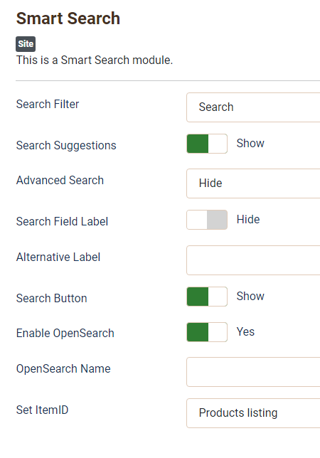

This is my search module setting

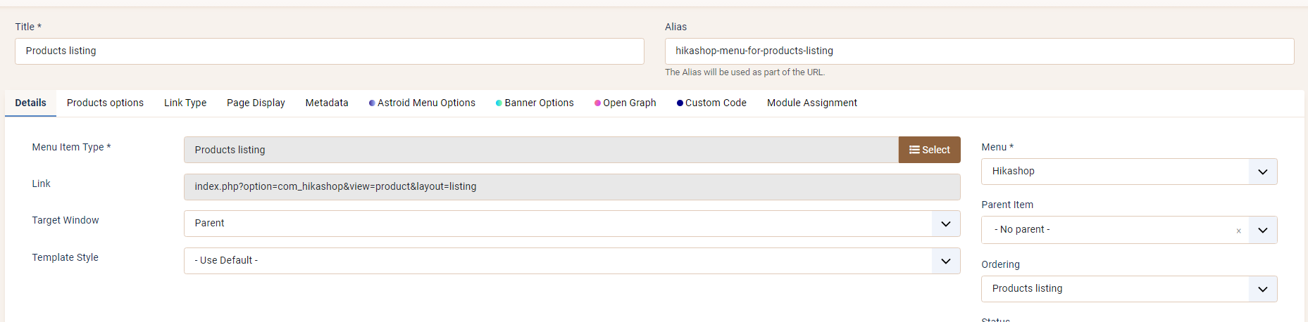

I'm not sure. First, could you provide screenshots of the settings of the menu item with the id 113 ?

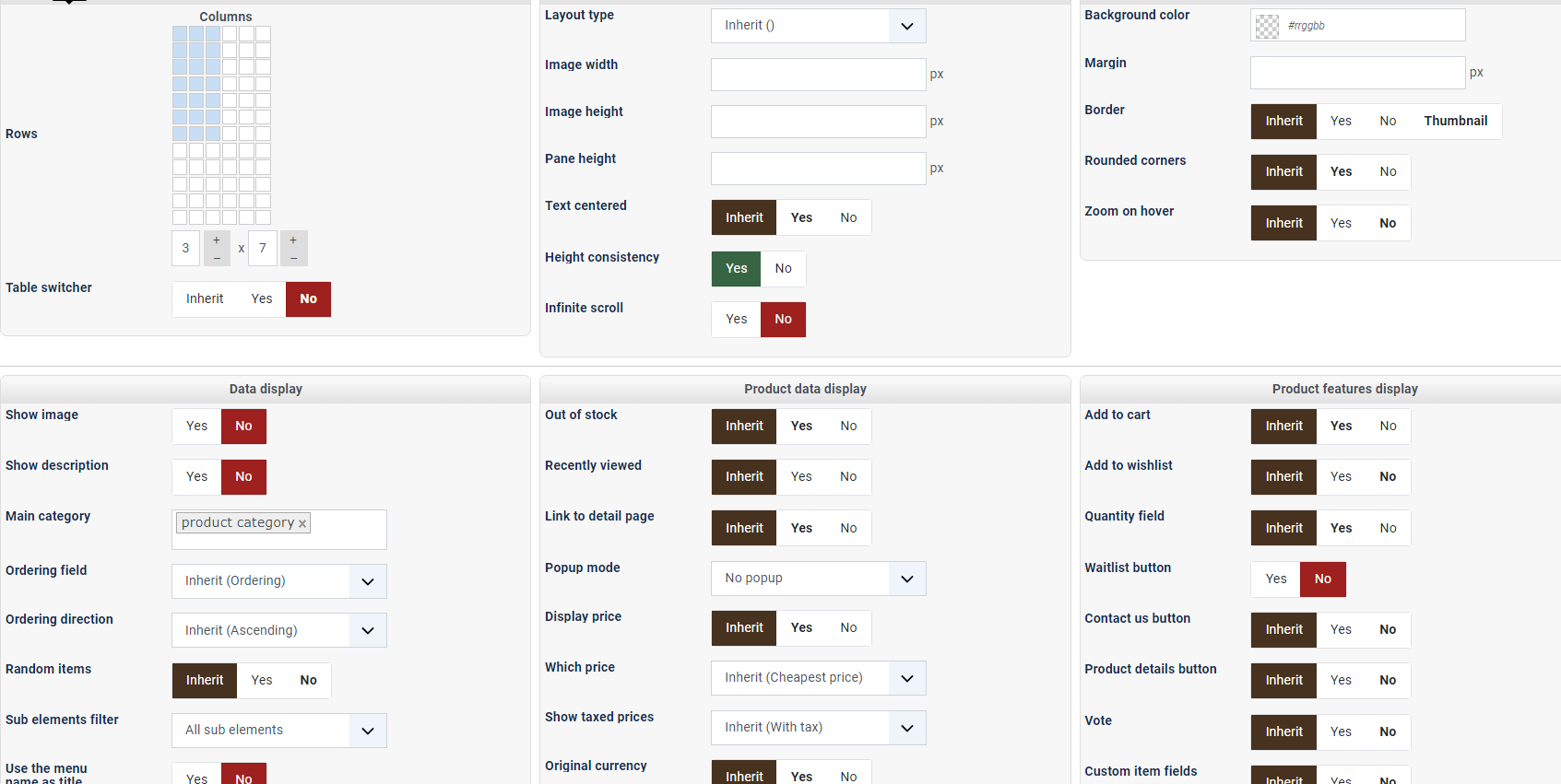

Nicholas here are the menu item settings

Your screenshots don't show all the settings. While the ones I can see look fine, I can't say for the others.
Is the menu item not enabled ? Is the menu item limited to some languages ? Is the menu item limited to some users groups ?
