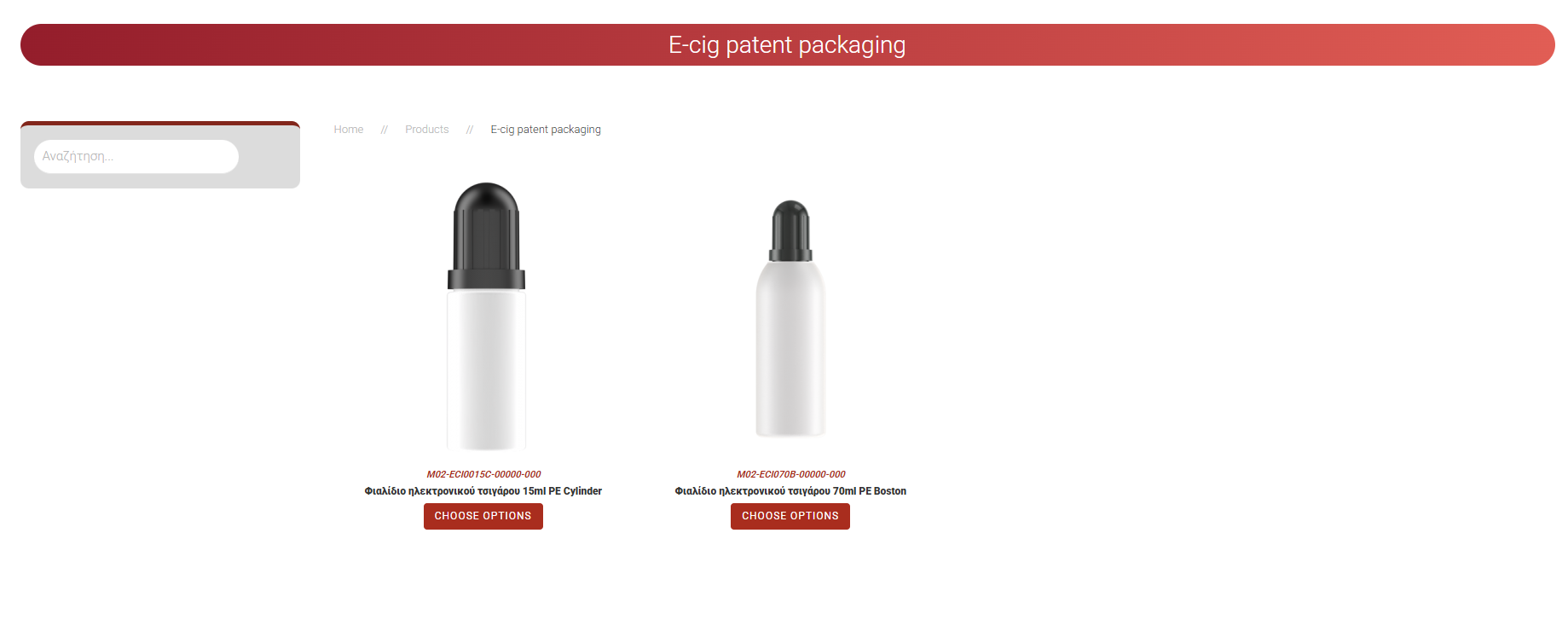

When i click a filter, the system filters the products accordingly and then all the filters disappear from the filter module and it only shows the search filter (search filter is not added in the filter module btw).

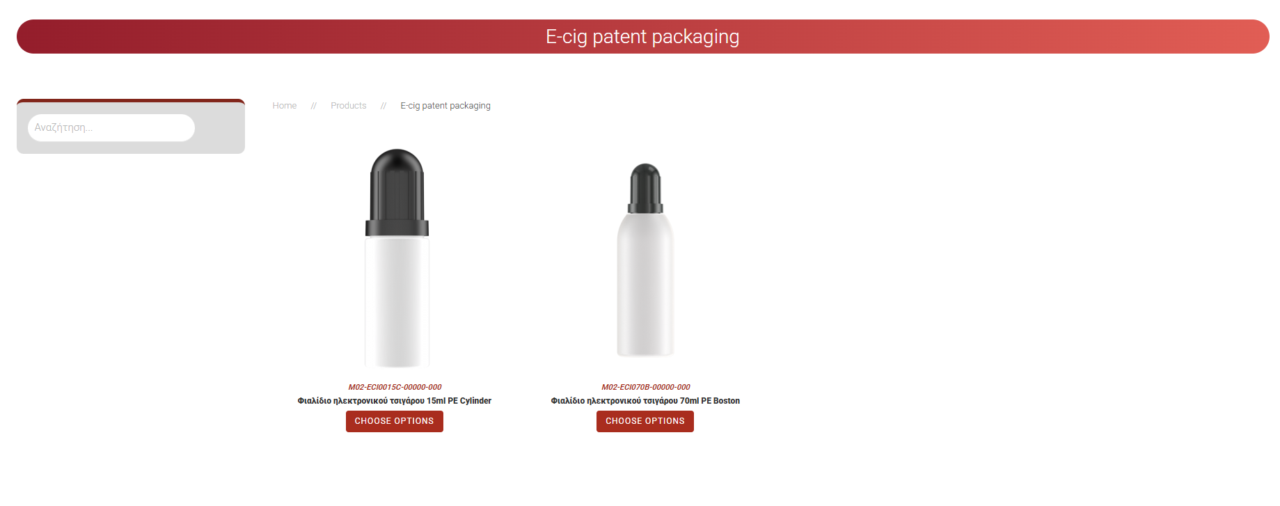

i disabled dynamic display but the same thing is happening.
I should be able to reset the filters but they still hidden.
Thank you

If it is not the "Dynamic display" setting, the cause is the AJAX refresh of the filters: when you click "Filter", HikaShop reloads each filter block in the background, but on your SEF setup that background request returns the full page instead of only the filter block. The script then puts the wrong block (your search box) in place of the Material / Volume / Family filters, so only the search filter stays visible.

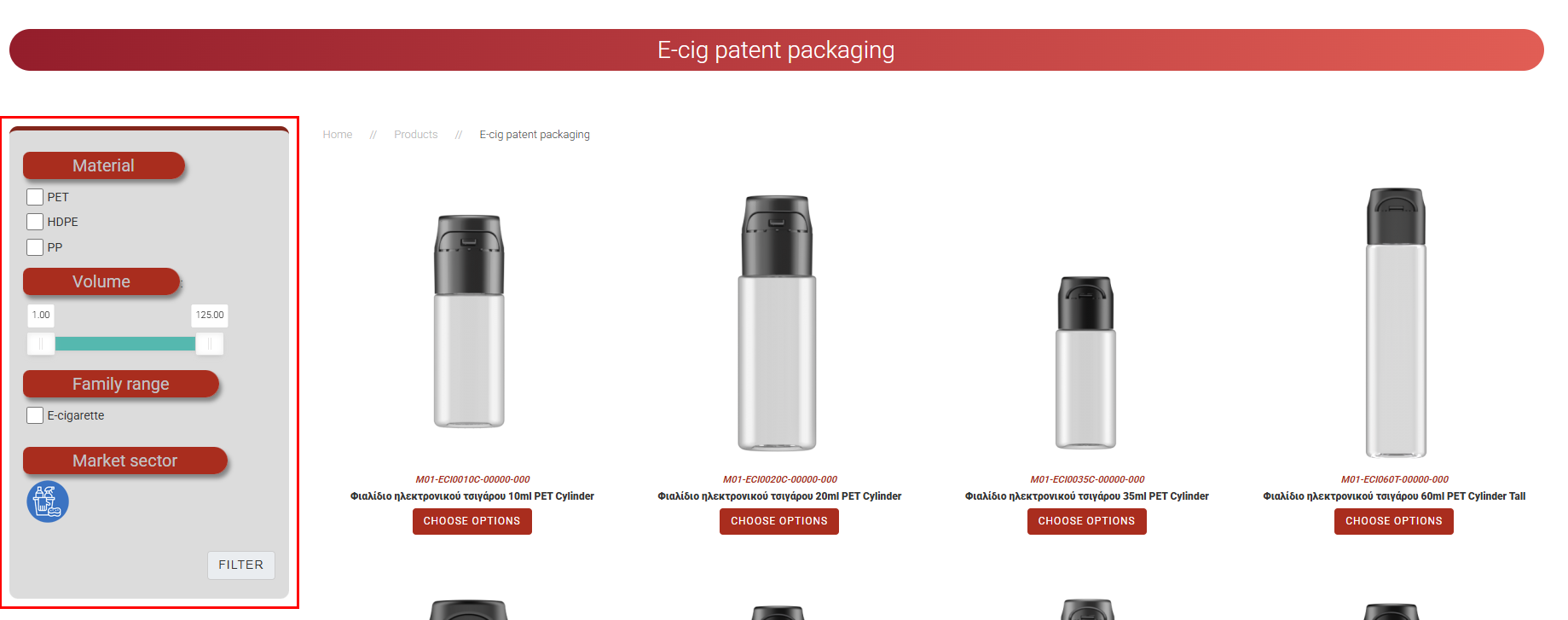

A normal full page reload of the same filtered URL shows all the filters correctly, so your products and your filters are fine, only the AJAX refresh path is affected.
