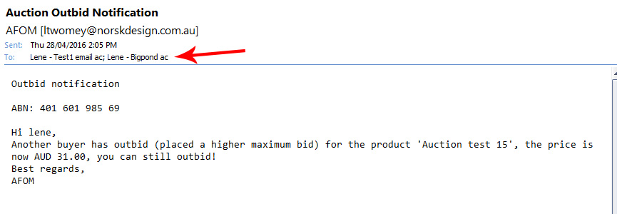

10 years 4 months ago #238251
These 2 issues are weird, no matter what I do on my end I never succeed to reproduce it and receive an email which was belonging to another customer.
1. Regarding the Email issue when we add the email to send to the Queue we also specify the ID of the customer so that kind of issue can only happen if both customer have the same email or if your system is redirecting your customer emails.
I also tested it with both Hikashop / Hikatest users and it worked fine, so could you test it with 2 new Users account with different addresses and describe me how emails are sent ? (when manually launched, the cron worked properly).

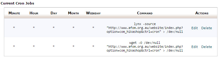

2. Regarding the Cron issue, if using the "Lynx" command you should also try it with the "wget"commande :
wget -O /dev/null "http://www.yourwebsite.com/index.php?option=com_hikashop&ctrl=cron" > /dev/null
And if it still not working, you should ask to your hosting company if you can actually use these commands.

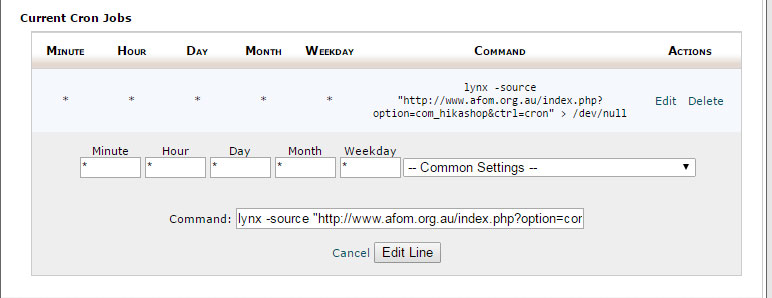

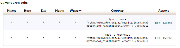

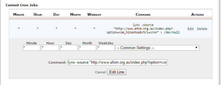

10 years 4 months ago #238465
Hi Mohamed,
I just removed the php file, that did not work at all, no emails received. I changed it back to what's listed in your user doc (both lynx and wget), image attached. Tested another auction, did not receive any emails before 15 minutes into the auction. I have set the server cron job to trigger every minute.
Regarding the emails, I am using two different email addresses that goes to two different mail boxes. Today I changed one of them to an email from a different provider, made no difference, image attached. By the looks of it, the emails are distributed to everyone that is in on the auction.

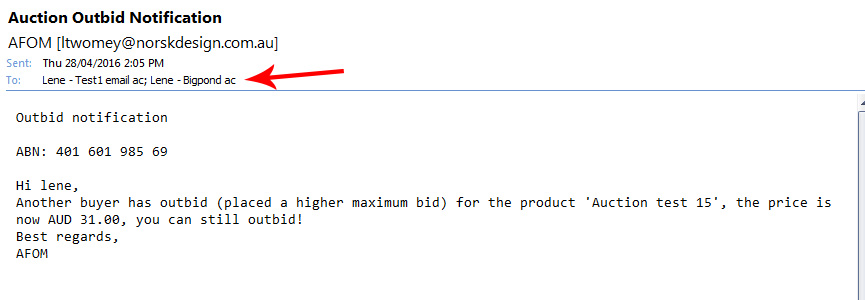

10 years 4 months ago #238628
Hello Mohamed,
I really do need your assistance here as I have no idea where to start. As you can see from the email image in my other post, it clearly shows that the email has been sent to both bidders. If you have a look at the user accounts in the backend, it is two users and two different email addresses and they do not go to the same inbox.

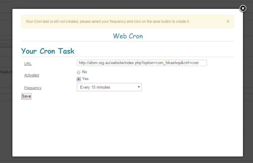

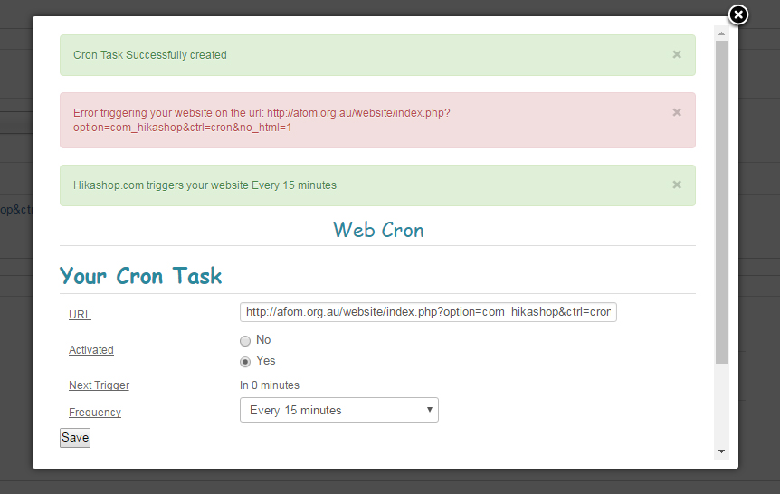

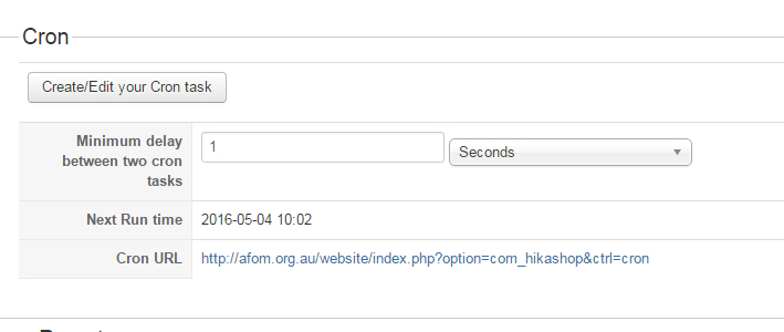

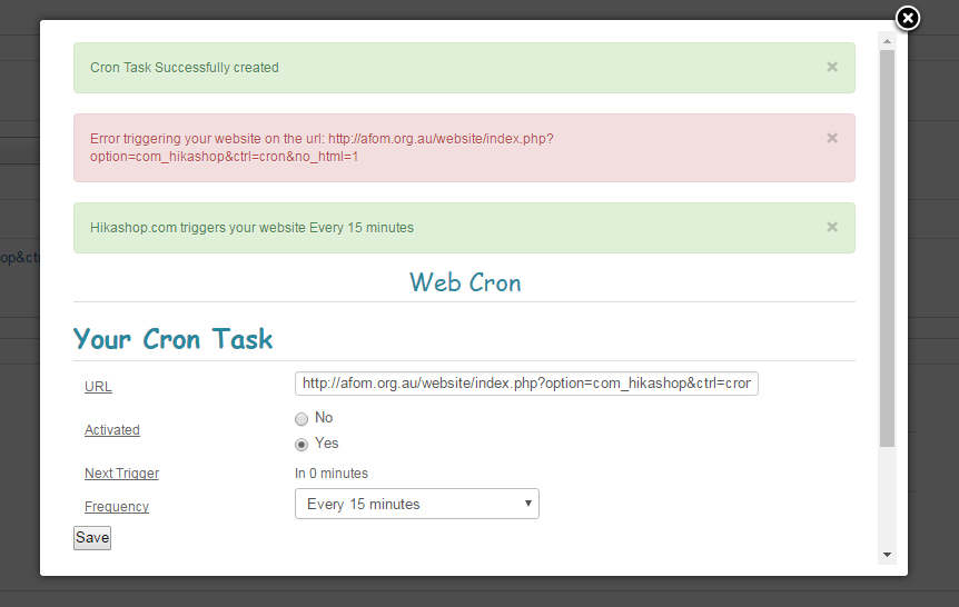

10 years 4 months ago #239086
Hello Mohamed,
I have removed the cron from the server and currently running it through the Hikashop server. I cannot see how you are not able to reproduce the email issue. If you setup another user and do an auction bidding with the two users you can see what I mean.
If you can provide me with an email address I can forward you the auction emails that is sent to the same inbox, some addressed to the correct bidder some notifications sent to both bidders.

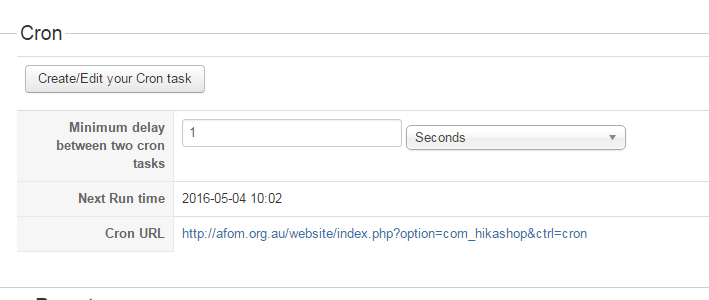

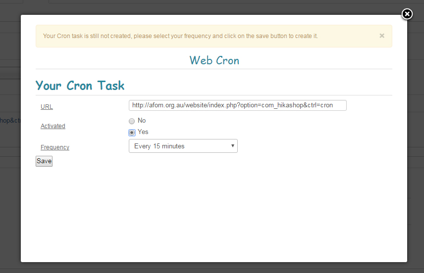

I have also attached some screenshots from the cron configurations;
cron-1.jpg - says 1 second -> I click on create/edit your cron task
cron-2.jpg - it tells me taht the cron task is still not created
cron-3.jpg - It shows an error triggering the website
The subscription is set to directory /website for both hikashop and hikaauction.
For auction you do need the cron to run more frequently than every 15 minute.
The email issue is critical, cron issue next.

1. Regarding the Cron issue, if using "wget" doesn't launch your Cron, then it's probably coming from the fact that :
- You can't use the "wget" command through your server, so you should ask it to your hosting company so that they can confirm it.
- You have a security system plugin which is preventing the "wget" command from launching your Cron, so you should check you system plugins.

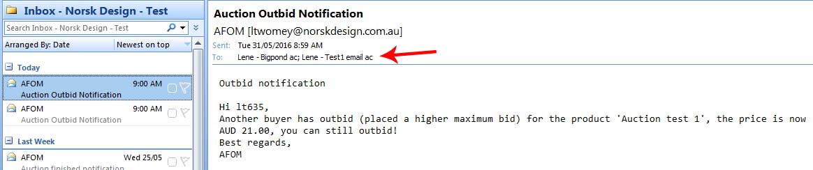

  • Posts: 191
  • Thank you received: 5
10 years 3 months ago #241027
Hello Mohamed,
I removed the email customization on all auction emails and tested again. I am still received emails that is address to both bidders, see image attached. The two accounts have different user name, email address and inbox setup.
For the moment the cron is running through Hikashop, I deleted the cron setup on the server. The htaccess file has been disabled and the same goes for admin tools.
If we can first fix the email issue then I will move on and start testing the cron issue.
Lene
  • Posts: 191
10 years 3 months ago #241036

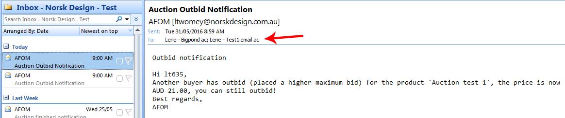

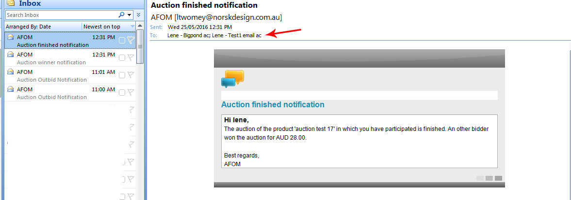

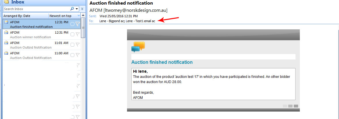

From the last test auction... the auction finished at 11.10am, the auction winner and finished notification was received at 12.30pm.
The auction winner notification only went to the winner (Lene - Bigpond ac, user lt635), but the auction finished notification addressed to 'lene' (Lene - Test1 email ac) was received in both inboxes. From the attached image, the email showing should not be in this inbox.
Lene

  • Posts: 191

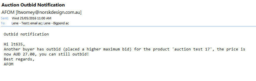

10 years 3 months ago #241526
Hello Mohamed,

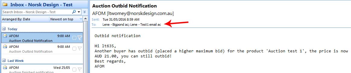

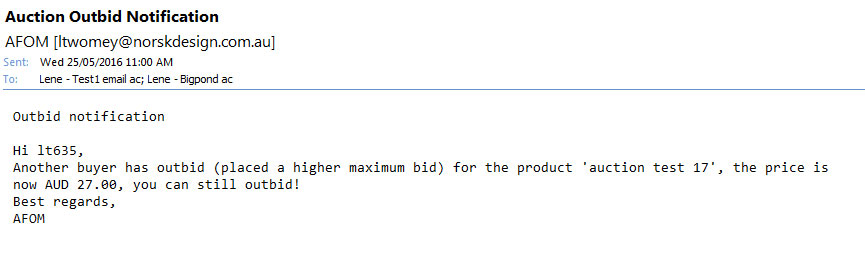

I still have the same problem with the emails. The process of what I am doing..
I have two email accounts and two inboxes. I put it 4 bids, two for each user. As you can see from the image attached one of the emails is addressed to both bidders.
Lene
10 years 3 months ago #241601
Hello Lene,
That's actually weird because even when I check it in your database, HikaAuction emails only have 1 destination email but in your case, the first email is properly sent but the second email is sent to both users.
Disabling the "eAccelerator" fixed your "Cron" issue but the email one is still remaining and is probably coming from a plugin which is interfering with your HikaAuction email delivery.
We'll continue to investigate on that issue and fix it as fast as we can !
