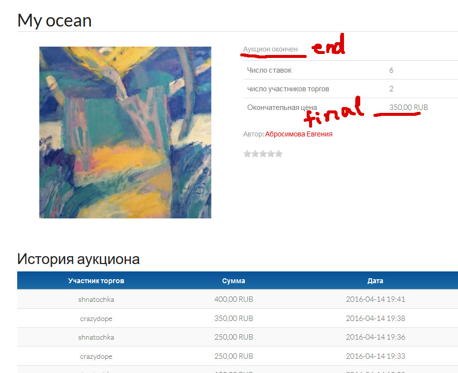

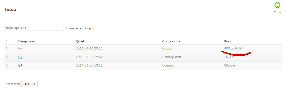

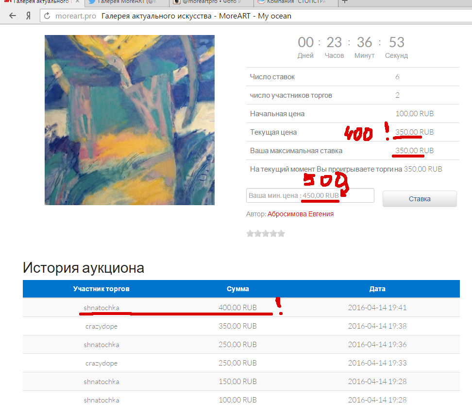

10 years 6 months ago - 10 years 6 months ago #236767 by ShNatochka
Replied by ShNatochka on topic Auction component
Hello!
I changed the code .But the auction is not working properly. The current price is wrong, the minimum bet is wrong, the final price is wrong, but at checkout the price is correct. Th у first screen is from user Crazydope, the second is from Shnatochka a the one moment.
And another question - e-mail is delivered only if I run cron manually.. Why?
Last edit: 10 years 6 months ago by ShNatochka.

10 years 6 months ago - 10 years 6 months ago #236810 by Mohamed Thelji
Replied by Mohamed Thelji on topic Auction component
1. I only gave you the code that will enable you to change the value of the final price through the validation link, but for other location as :
- Current price
- Final price
That are displayed through your auction page, you'll have to edit the code of the "show_default" file of the "productauction" view via "Hikashop->Display->Views". For the Final price you'll have to change these lines :
Code:
<span class="auction_details" name="final_price" id="final_price"><?php echo $current_price;?></span>
By :
Code:
<?php $maxBidOfWinner = $auctionClass->getMaxBidOfUser($this->element->product_id,$current_winner_id); if(isset($maxBidOfWinner) && (int)$maxBidOfWinner > 0){ $winner_price = $this->currencyHelper->format($maxBidOfWinner, $this->element->prices[0]->price_currency_id); ?> <span class="auction_details" name="final_price" id="final_price"><?php echo $winner_price;?></span> <?php}else{ ?> <span class="auction_details" name="final_price" id="final_price"><?php echo $current_price;?></span> <?php } ?>
But note that if you want to completely change the auction mode system, you'll have to create your own algorithm of calculation of current price.
2. You should configure it to be triggered automatically : www.hikashop.com/support/support/documen...ashop-cron-task.html
Last edit: 10 years 6 months ago by Mohamed Thelji.

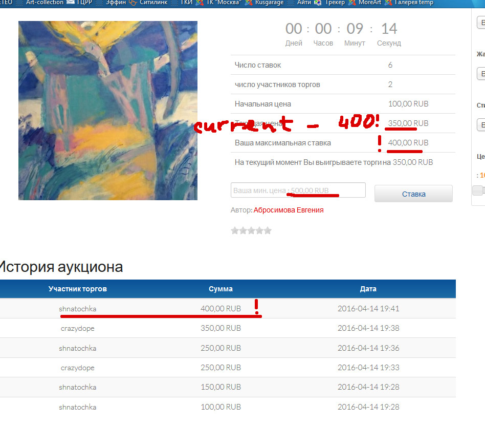

10 years 6 months ago - 10 years 6 months ago #237307 by ShNatochka
Hello! Yahoo! I have done it even without knowing php! Thank you, Mohammed for your support.
To change the price of the auction you don't need to do the changes described in the previous messages. When the setting of the auction mode "Free bidding" you'll have to edit the code of the "show_auction" file of the "productauction" view via "Hikashop->Display->Views". You'll have to change these lines :
Code:
$current_price = $this->currencyHelper->format($current_price_amount, $this->element->prices[0]->price_currency_id);
by
Code:
$current_price = $this->currencyHelper->format($max_bid, $this->element->prices[0]->price_currency_id);
But Now about the cron. I configured it as specified in the documentation. But 3 days later he started in 20:26 and 22:40. And yesterday he began to issue every 10 minutes "Task is completed. No file path specified". But for the participants it sends only when run manually
