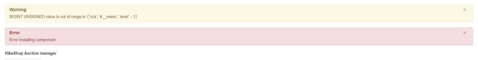

Hi after trying to reinstall displays this error:

Do you only have that error message with the HikaAuction component ? Did you try it with another plugin or component ? Because it seems that the issue is coming from something else.
Can you also try to check that documentation and try to install it via FTP ?
www.hikashop.com/support/documentation/5...-to-install.html#ftp

Interestingly, the test does not always give this error. I get this error on all your products (Hikashop, Hikamarket, Hikaserial and HikaAuction). What could be the reasons? I wrote to Joomla they told me to turn to you. It also happens on my server and on Localhost (127.0.0.1).
Last edit: 8 years 9 months ago by neo191987.
  • Posts: 86183
8 years 9 months ago #283823
This looks like an issue with your joomla asset table having some inconsistent data.
So if you use the same website, regardless of the server, you'll have the problem.
Also, do you have the problem with other extensions than ours ?
And if you go in the Extensions>Manage>Database menu and click on the "fix" button, does it help ?
How about the "rebuild" button of the menu manager of Joomla ?
