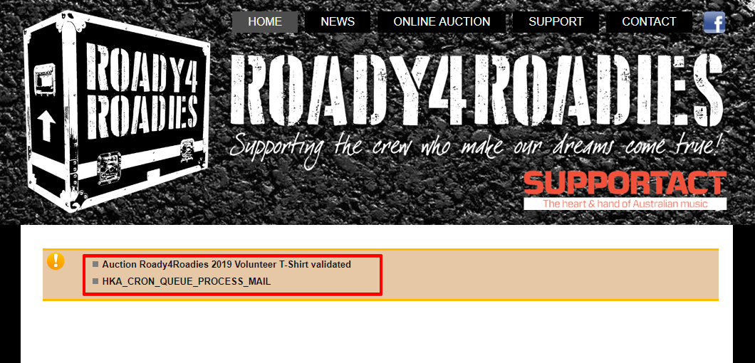

7 years 4 months ago #306060
That page isn't supposed to display anything but Cron system messages as it's only supposed to be called repeatedly by your server and not your customers.
As you can see through the screenshot I attached, the "Auction Roady4roadies 2019..." was validated and emails were sent. you can now check the last emails that were sent via "Hikashop->Customers->Emails".
