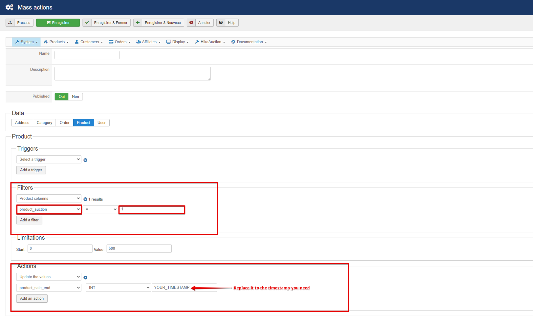

A solution can be to use mass actions via "Hikashop->System->Mass actions" and configure it like in the attached screenshot.
You'll just have to replace "YOUR_TIMESTAMP" by a timestamp of the date that you can generate via :
www.unixtimestamp.com/
Kind regards,
Mohamed

5 years 6 months ago #329581
Of course, using the solution I gave you with Mass actions will do the job. But you'll also have to make sure that the CRON (Hikashop->System->Configuration->CRON) is triggered either manually or automatically.
Kind regards,
Mohamed.
