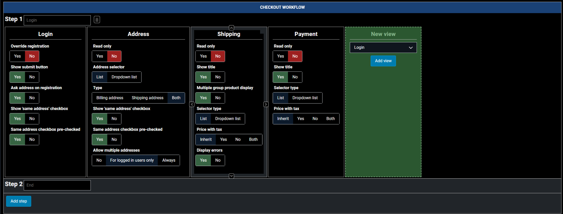

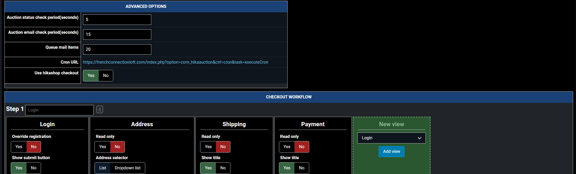

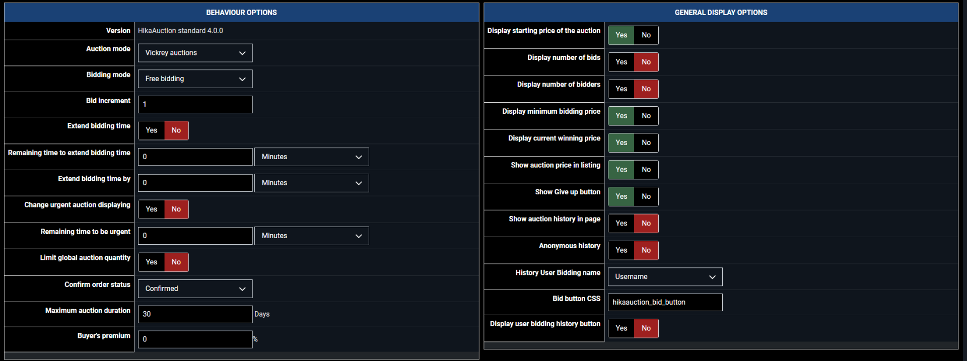

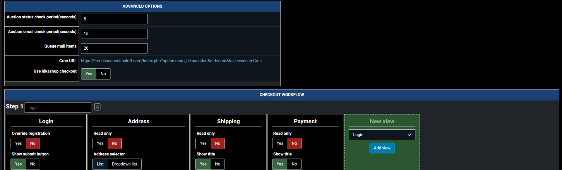

Please review my Hikashop Auction configuration screenshots.

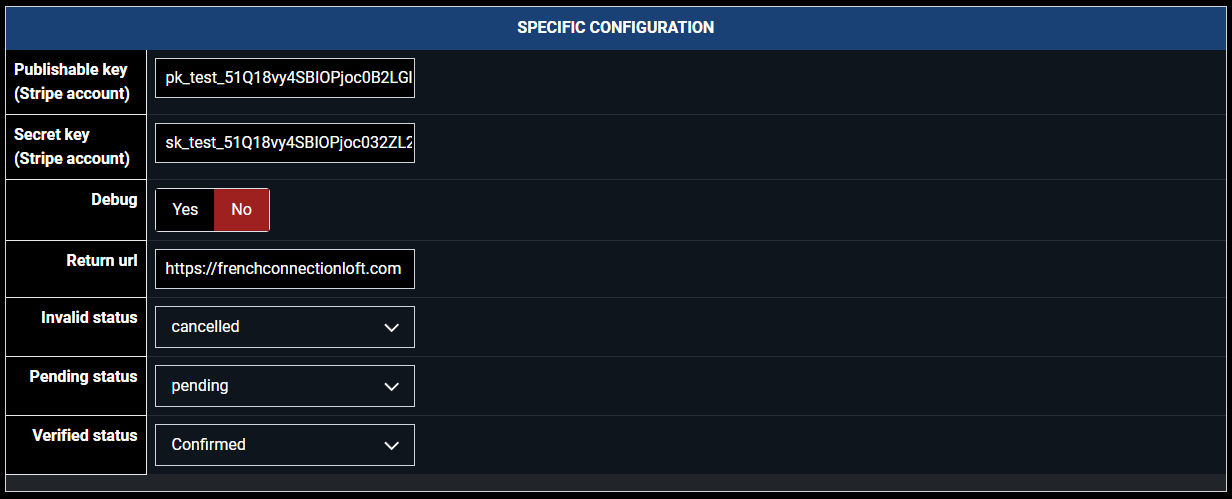

You are right, the problem is with the Stripe payment plugin return URL.
If the return URL field is empty, the checkout page redirects to the payment page but after completing the transaction, it redirects to a blank page.
Can that be corrected?

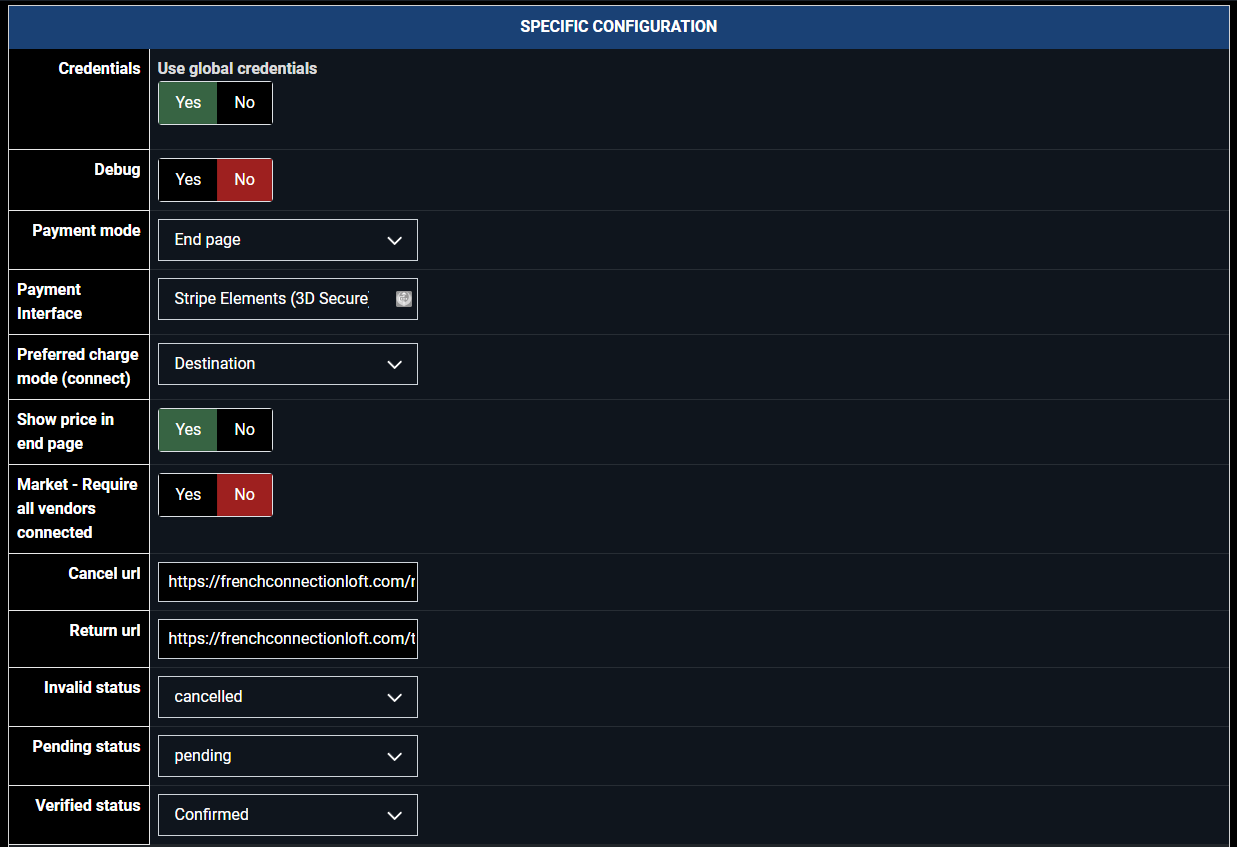

I uninstalled the Stripe plugin I originally used and purchased/installed the new Stripe V3 with Connect at the Hikashop marketplace.
If the return URL field is empty, the checkout page redirects to the payment page, after completing the transaction, it redirects to a blank page, not the thank you page.
If the return URL field has the thank you page URL, the checkout page redirects to the thank you page.

However, I've changed the payment mode to checkout instead of end so that the credit card form displays below the payment selection directly instead of at the end of the checkout and for some reason it works even with the return URL filled.
If this is ok like this for you, then fine. Otherwise, Jerome, from Obsidev, who developed the plugin would have to look into it further.
