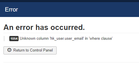

-- Error-message(debug-mod must be tuned on) -- : Unknown column 'hk_user.user_email' in 'where clause'

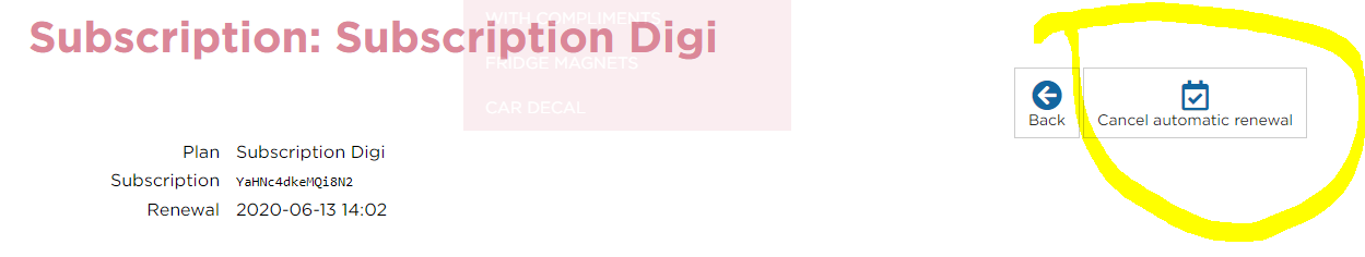

Subscription works as planned. The user group is changed to subscriber group after changing the setting. The user makes a payment through payal recurring payment. Everything works thank you for the plugin but when a user cancel automatic renewal from their account through the front end there is error on the backend when we try to view the subscription.
Please find the attached images that will help to better understand the error.

6 years 5 months ago #319131
by Jerome
Replied by Jerome on topic hikasubscription Error
The only place where I can find the the reference of "hk_user.user_email" is the search in the subscription listing.
It would mean that you have to replace in the file "administrator/components/com_hikaserial/views/subscription/view.html.php"
by
Please confirm if it solves your issue so we can include it as a fix in the component.
Code:
$this->getPageInfoTotal($from . $filters . $order, '*');
Code:
$this->getPageInfoTotal($from . $joins . $filters . $order, '*');

Thank you. Looks like it works.

Sorry to be a pain but i really need this to work. Is there a way for customer to unsubscribe once the purchase a subscription product.
From my account section there is cancel auto renewal button But this does not change the subscription status. To test this i made a test order which will charge me daily and hit the cancel automatic renewal button. There was no charge the next day but i got charged again the following day. e.g. on 19th i purchased the product and hit cancel automatic renewal, on transaction on 20th but account charged on 21st. Does that make sense. Am i doing something wrong or is the way it is suppose to work.
Thank you

6 years 5 months ago #319551
by Jerome
The Paypal recurring plugin is using the same API than the HikaShop paypal (classical) plugin.
That API do allow to create a subscription and receive notifications regarding its updates ; but the API do not have the access to cancel a subscription ; only the Paypal dashboard will propose that.
When a customer ask for the cancel of a subscription, he should see a message telling :
Paypal REST might be able to create subscription and handle the cancellation via the API too ; but for what we saw, it requires to create the plans and subscriptions directly in the Paypal Dashboard (or use the API to create them).
That Subscription API do have the same limitations than the Stripe API ; thus the same reason why we are not fan regarding an implementation which would generate a lof of restrictions (and potentially bugs) regarding the way than customer could buy subscriptions.
Code:
PAYPAL_RECURRING_CANCEL_INSTRUCTIONS="You need to login to your Paypal account and cancel the subscription in the preapproved payments"
