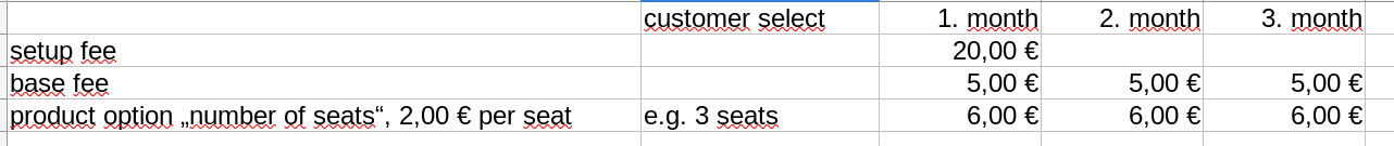

4 years 2 weeks ago #344308
Maybe this table illustrates my subscription plan better.
Additionally the plan must automatically renew each month, meaning a pdf invoice must be send to the customer 5 days before expiration so they could cancel before the auto renewal happens.
