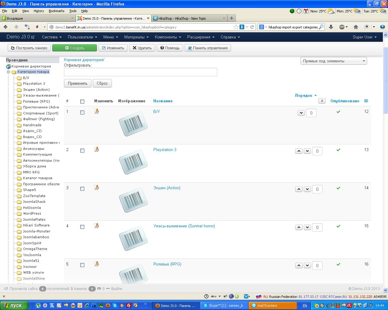

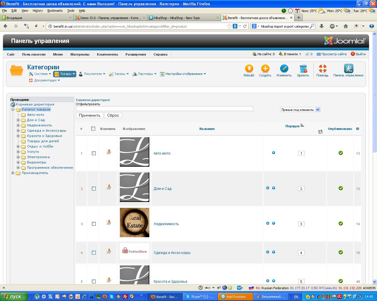

Hi try make imp\exp (csv) operation from J2.5 to J3 (last versions) all information transfer but categories structure not
-- url of the page with the problem -- : demo3.benefit.in.ua/
-- HikaShop version -- : 2.2.0
-- Joomla version -- : 3.1.5 Stable
-- PHP version -- : 5.3.6
-- Browser(s) name and version -- : Mozilla 22.0
-- Error-message(debug-mod must be tuned on) -- : was some errors like this column not exist but not make PrtScr (forget)
How to make export with saved categories structure?

hi in categories i dont see tree (add my csv file in attach)
Last edit: 12 years 11 months ago by master_b.
12 years 11 months ago #117847
Your csv don't have the categories structure.
That's why when importing in back, the categories don't have parent/children.
