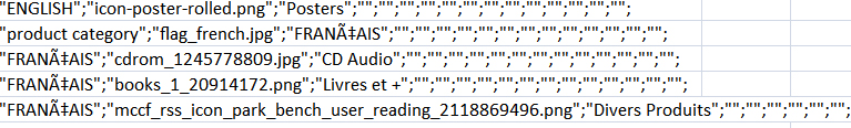

I am trying to export my categories and products.
When I do that I have the result you can see in the screenshot bellow.
How I can change that?
Thank you

12 years 11 months ago #118452
Import the CSV in UTF8 on your spreadsheet software with the ; as separator (or change the CSV separator in the configuration of HikaShop).
HikaShop can only export in UTF8.
  • Posts: 73
12 years 11 months ago #118466
HI,
Thank you but,
This is what I weas trying to do, but I don't know what is: "spreadsheet software"?
Thank you to explain even in few words ;-)
  • Posts: 26376
12 years 11 months ago #118467
Microsoft Excel, OpenOffice Calc, LibreOffice Calc or else.
  • Posts: 73
12 years 11 months ago #118560
I am still trying to export/import categories and products using a UTF-8 coding.
I didn't find the place to do that... Where in the configuration I have to look?
Thank you
  • Posts: 26376
12 years 11 months ago #118567
As Nicolas said, the option is "CSV separator" and if you take a look at our documentation, you can find easily the placement of the option:
www.hikashop.com/support/documentation/5...nfig.html#main_files
CSV separator : You can select here whether to separate columns by a comma or a semicolon in the CSVs you can export from HikaShop.
