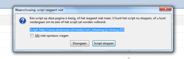

  • Posts: 252
12 years 10 months ago #122315
previously I mentioned that I get a script error on Massaction.
In the attached file you'll a picture of this message
  • Posts: 26376
12 years 10 months ago #122576
A problem with my sweety otree library ?
How many categories do you have ?

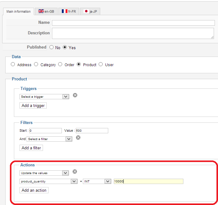

12 years 7 months ago #137580
By creating a new mass action, and using the options under the "actions" tab, for example you can update every quantity field of your products to 10000 like this :
