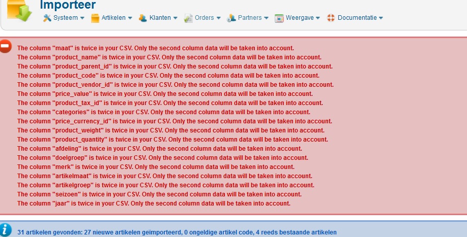

After the latest update of Hika shop 2.2 I get the following error on the import. see the attached file

12 years 11 months ago #119637
Thanks for the report, don't worry about the errors displayed it will be fixed soon, and it's not compromising the import.
