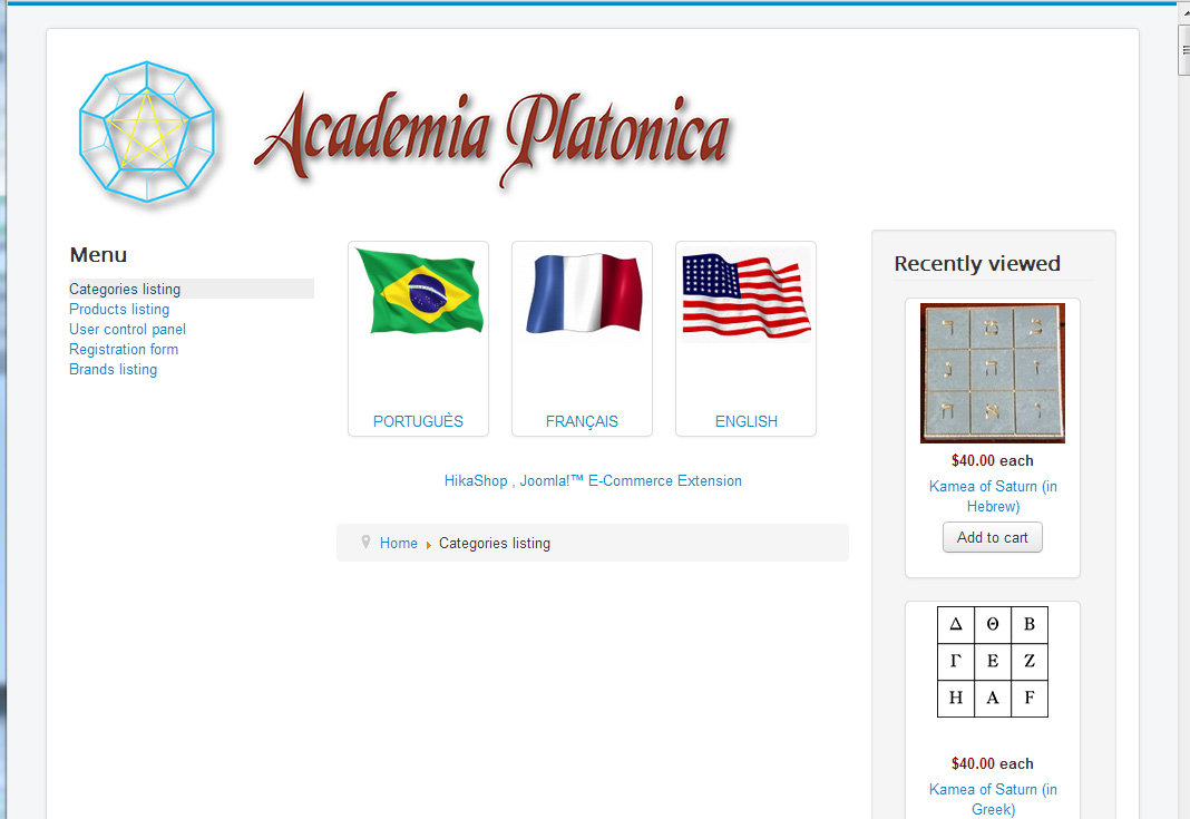

I export my catalog from a Joomla 2.5 and import it in my new website Joomla 3.1.5
I recover everything, categories and products.
I installed the photos and they show up very well.

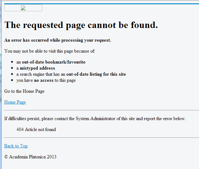

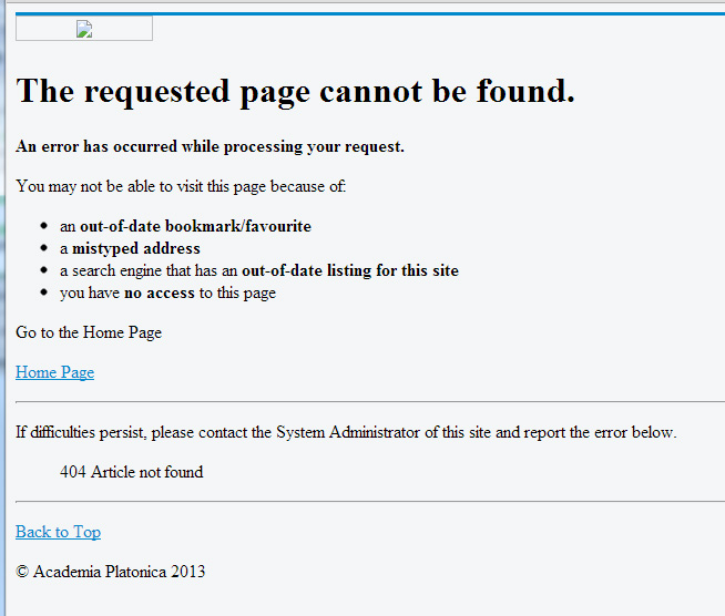

BUT when I try to use the menus from the categories or from the products I always obtain the same result: Pages cannot be found...
Everything is on the website but this is not working. What can I do?
I give you the screenshots below. The third one is the error.
Thank you for your help!

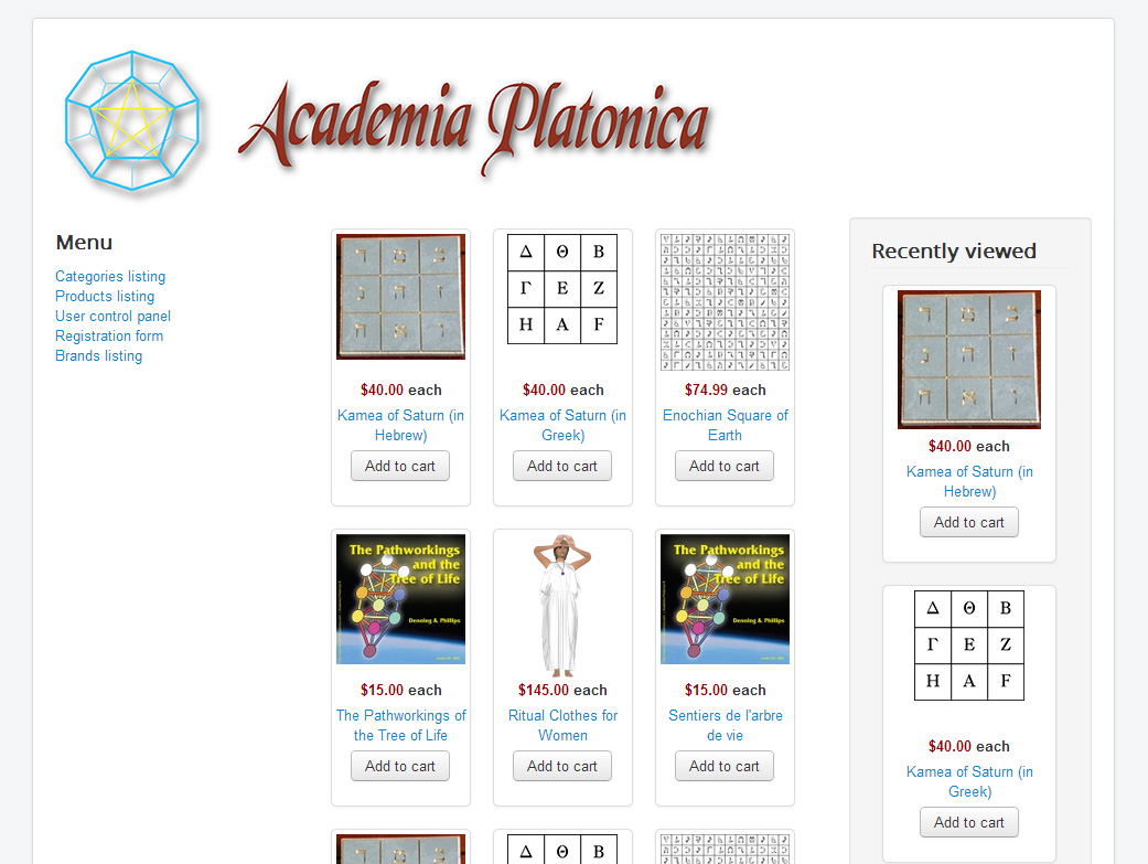

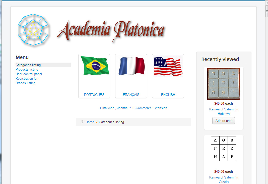

Categories showing well
Products showing well
ERROR when you click

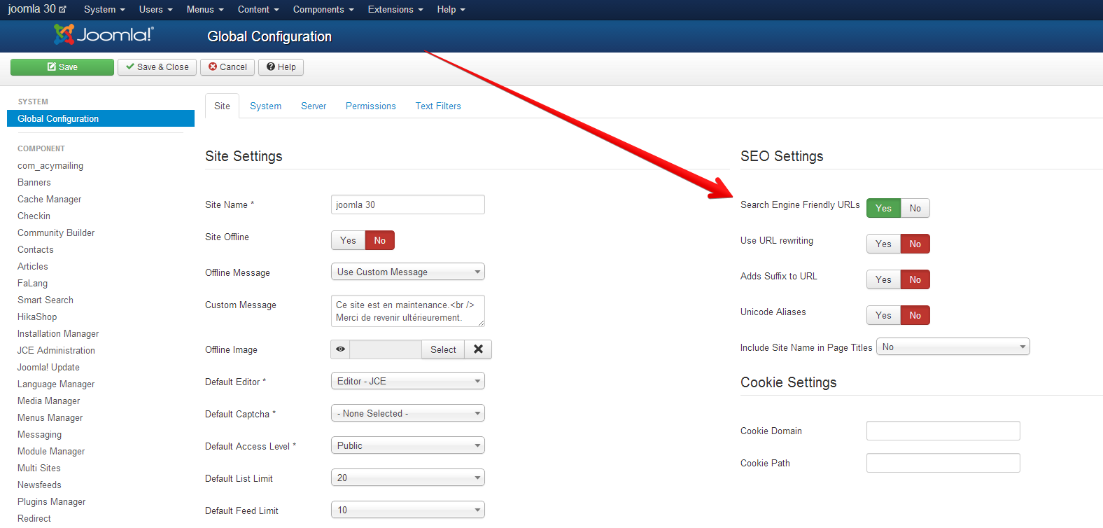

I don't think that the problem is "in" hikashop.
I think it's really something to do with the SEF.

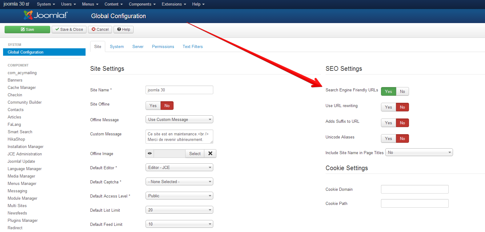

Go in the joomla configuration and turn off the SEF options and try again.
  • Posts: 73
12 years 11 months ago #120599

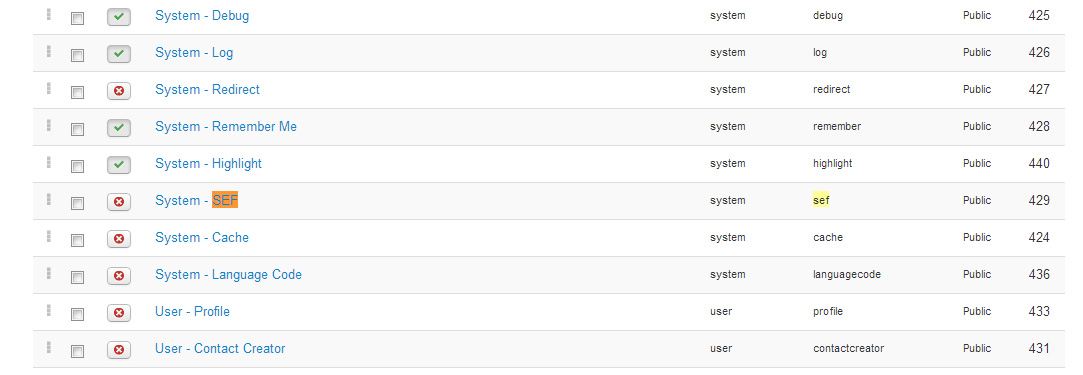

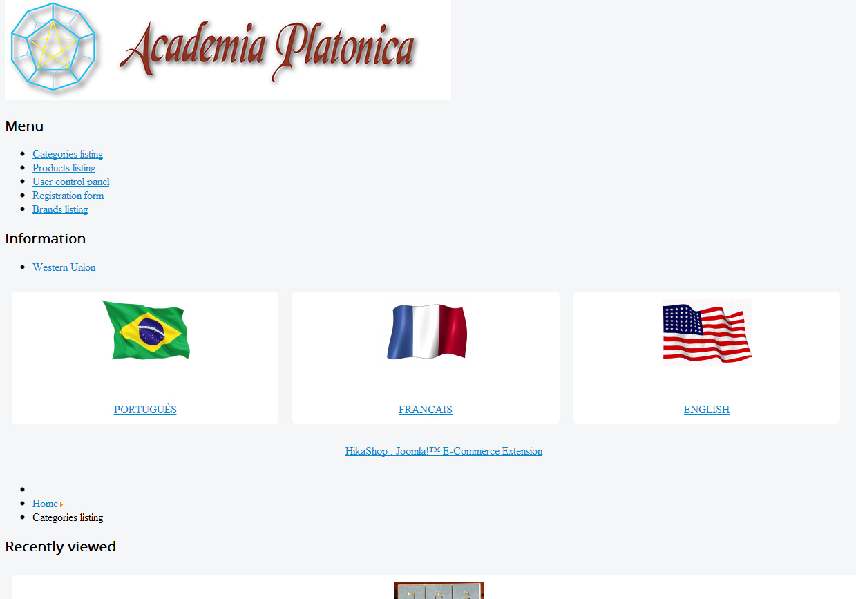

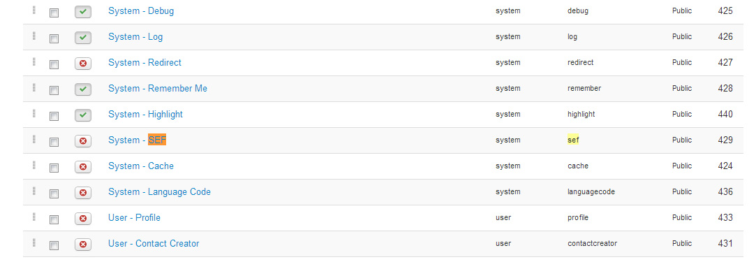

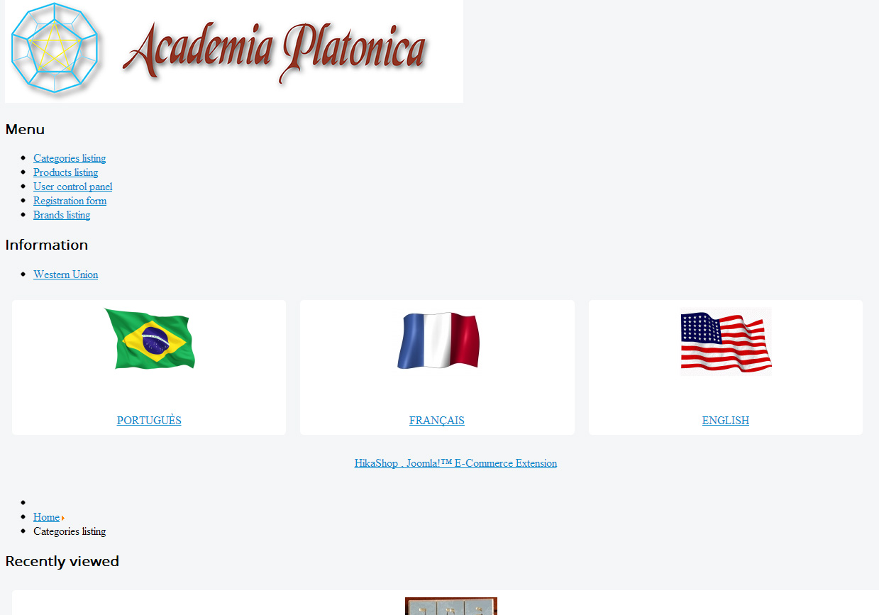

I tried to disabled the SEF as seen here:
And the result is worse:
  • Posts: 85952
  • Thank you received: 14142
12 years 10 months ago #120672
No, you should not turn off the joomla SEF plugin but the SEF option of the joomla configuration.
  • Posts: 73
12 years 10 months ago #120708
I did that and that doesn't change anything.

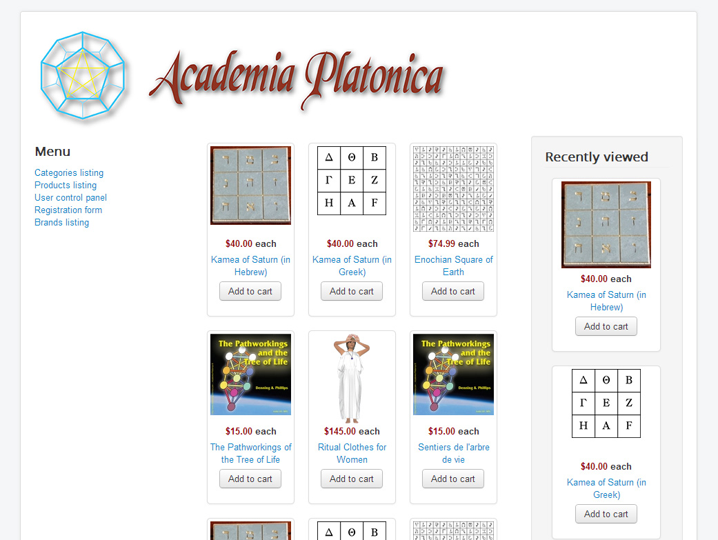

  • Posts: 85952
12 years 10 months ago #120710
I see that your URLs are still SEFed.
Can you please keep that option turned off so that we can look at your pages again ?
  • Posts: 73
12 years 10 months ago #120717
Ok. I did what you said and it works now :-)
The only remaining problem for now is: when you click on a product the screen get darker but the photo of the product doesn't show up.
Example: www.academiaplatonica.com/index.php?opti...e-of-life&Itemid=103
Last edit: 12 years 10 months ago by julian56. Reason: Update of the problem
  • Posts: 85952
12 years 10 months ago #120735
The photo works fine on my end.
I tried with different browsers and didn't have a problem on that page.
