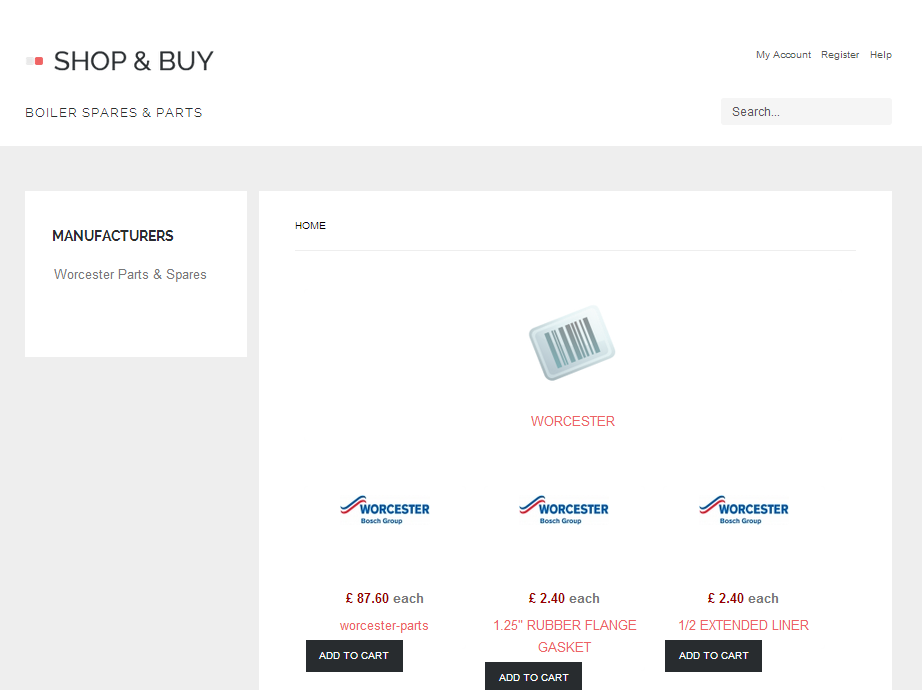

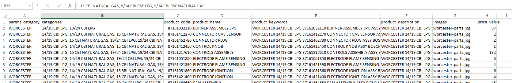

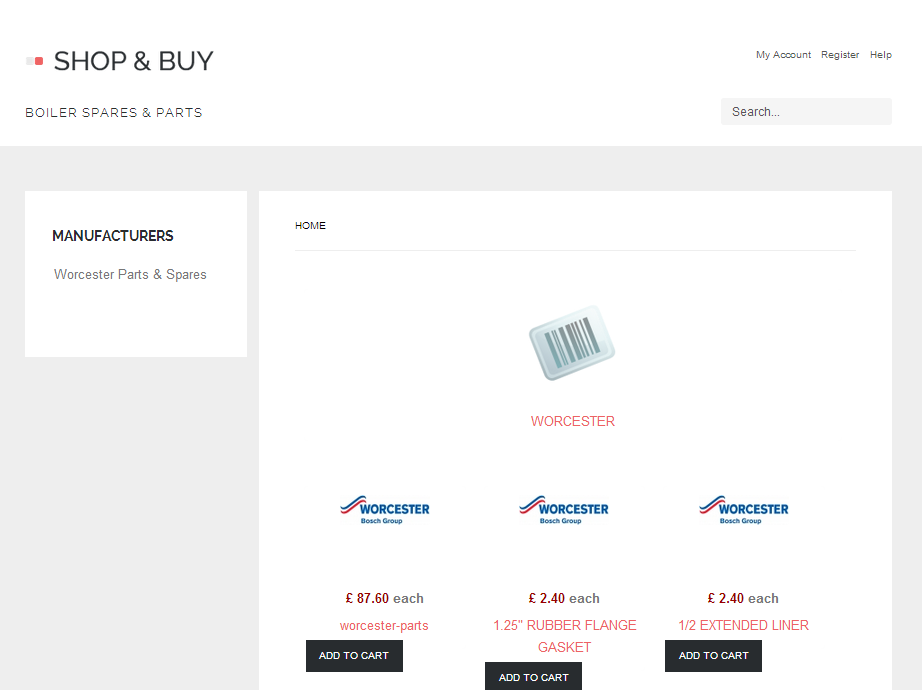

I have a query. It is with products showing on the front end in the root category which is not what i want. I only want them to show in the sub categories in which they are placed. This i have already changed in the display options for the menu id 686 to only show 'direct sub elements' in the 'sub elements filter' dropdown. However they are actually in the root in the backend also, which may be due to my import file. I asked advice from Nicolas about this and he suggested the format which i have attached.
My main point here is stopping those products from showing on the front end until i have clicked into that sub category.
Alex.

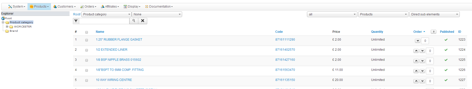

12 years 11 months ago #125338
Hi Jerome,
They are also in the categories they should be in, they are not in the parent category 'worcester' but in the category below root 'product category', which they shouldnt be entered into. I haven't even mentioned the category 'product category' in the CSV so i am not sure why they are being imported to this category also. It will end up making the site very messy as i think once complete there will somewhere in the region of 50,000 products on the site.

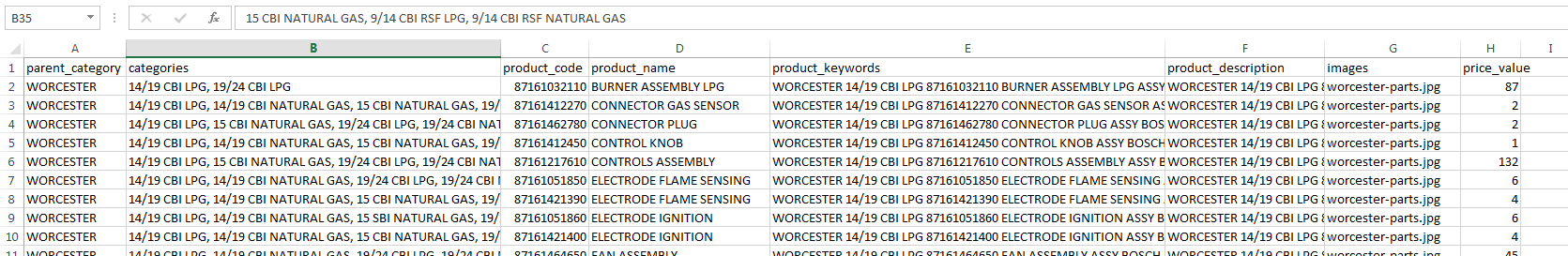

Note that if your categories are already created, you can simply delete the "parent_category" column from the CSV as the system will be able to link the product to the categories directly. Maybe that would help ?
I did a test on my end like below and I couldn't reproduce the issue:
product_code,parent_category,categories
my_prod_test_import,main category for test import,category of product for import

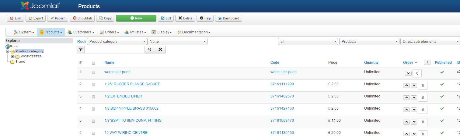

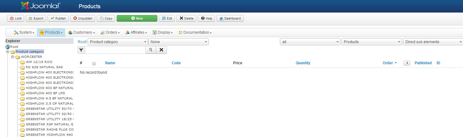

12 years 11 months ago #125439

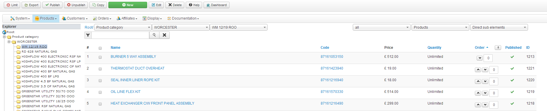

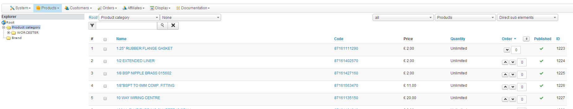

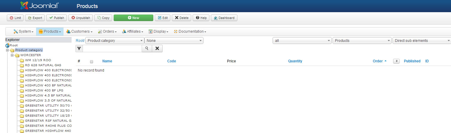

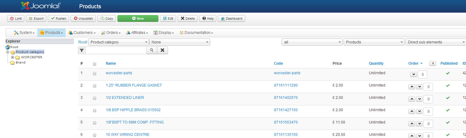

I have tried to import the products this time leaving the categories in place. (Firstly i truncated the hikashop_product table) So in the first screen shot i have no products at all. Then in the second i have loaded the CSV which i will send over and it has added the products back to the 'product category' and sub categories again. I am really not sure how i can work around this if you say you cannot reproduce the problem should i try a fresh joomla / hikashop install?

  • Posts: 86181
12 years 11 months ago #126547
As I said, I tried with the test v3 file that you sent. It worked fine.
All the products with a category specified in the "categories" column were inserted only in the categories stated in the CSV.
All the products without any category specified in the "categories" column were inserted in the root category since the system forbids products without categories.
As far as I can see the import works fine. I don't see why the server or website would change anything.
Did you see that most of your products don't have a category entered at all in your CSV (and thus they fall in the second group of products I talked about above and thus are added to the main product category) ?
