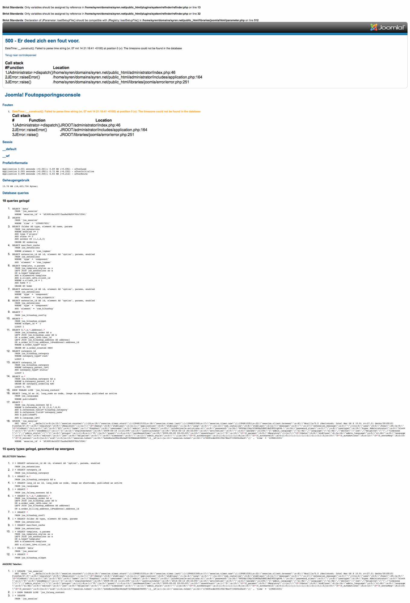

12 years 4 months ago #148307
Hereby attached a screenshot of the error on the screen with all the reporting on.
I saw something about timezone. For your information: the Joomla timezone is set to Amsterdam.
12 years 4 months ago #148316
It seems like you have an error through your rsfinder system plugin, so can you un-publish it and test it again ?
  • Posts: 91
12 years 4 months ago #148371
I disabled it, but it's still not working (same kind of error). I could give you access to the site (or a copy of it).

  • Posts: 91
12 years 4 months ago #148863
Tried to create a screenshot of the error but to my surprise no error. So I think (and hope) I had some cache problem after de-activating RSFinder. So RSFInder seems to be the problem. I can live without RSFinder but I'm curious what the exact problem is and if Hikashop (or RSFinder) can solve this.
But for now the problem is solved.
