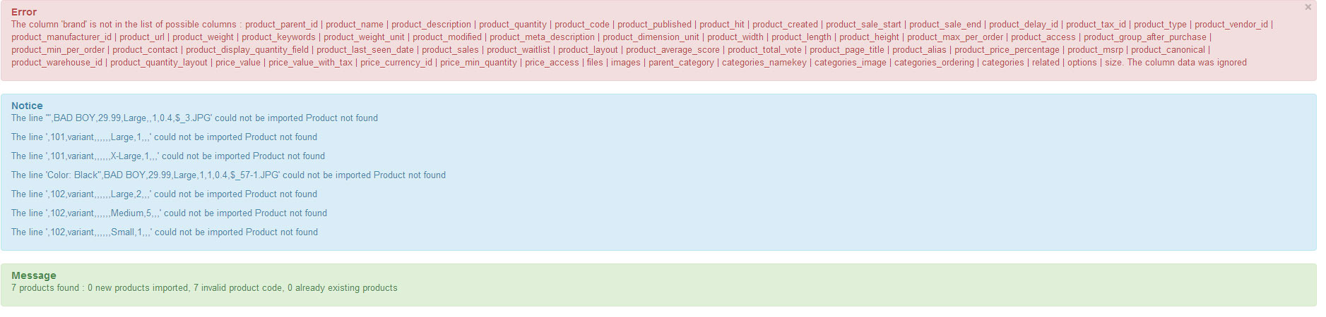

  • Posts: 191
  • Thank you received: 5
11 years 11 months ago #159533
It is just not working, it throws all sorts of errors (attached img with example errors). I think one of the issues is the product_id? I created this, not the system. But if it is a system related code, what id would you use to connect the characteristics (variant) with the main listing?
I simplified the csv file and it works fine with the basic information, just not for the characteristics.
It is a bit difficult as it is on my localhost at the moment. Other than the categories the only thing setup is one characteristics named Size (alias: size) with 4 values: x-large, large, medium and small. Not all products will be available in all sizes.
I hope the above makes sense.
Lene
  • Posts: 85681
  • Thank you received: 14041
11 years 11 months ago #159657
For the brand error that's normal. The column name should be "product_manufacturer_id"
For the "product not found", it's because the products/variants don't have a product_code column.
Add one where you enter the code of each product/variant.
And in the product_parent_id column enter the product code of the main product for your variants (leave empty for the main product).
And finally remove the product_id column if present.
Then it should fix the issues you're having.
